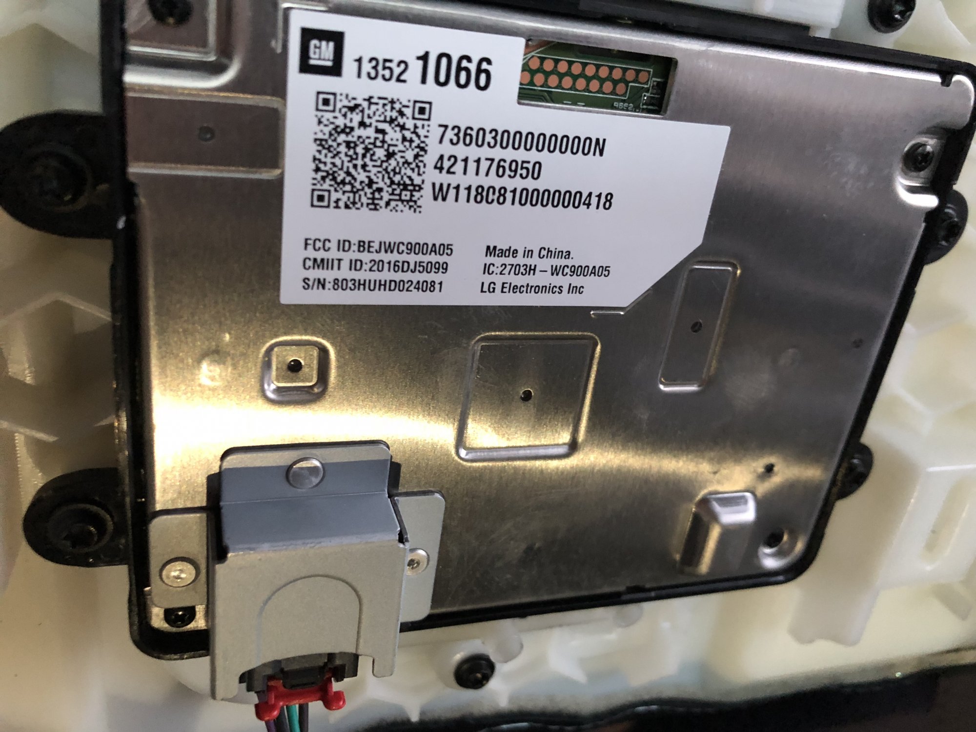

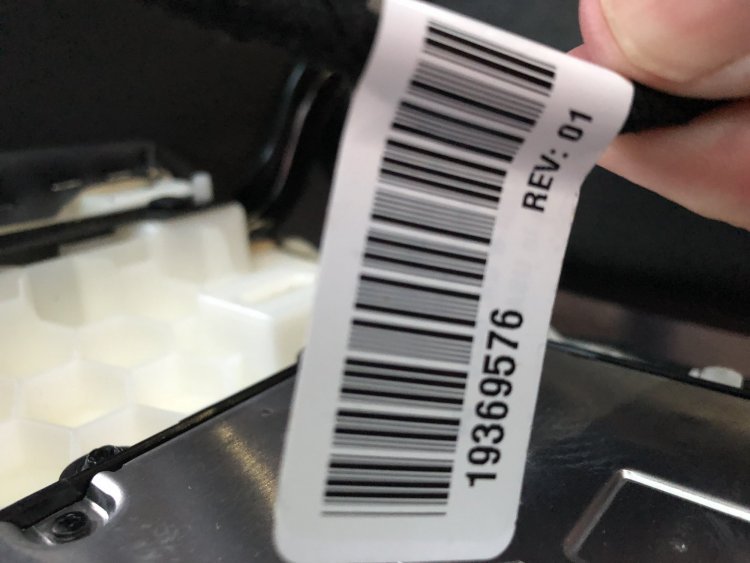

  1. i bought a center console off eBay that came out of a 15 sierra 2500hd and it has wood trim panels. above the cup holder it came with dual usb and 2 round 12v receptacles ...inside storage was 1round 12 v and a hole that had something removed.. also 1 round 12v in rear.. my 15 2500hd is SLT with wood trim and i removed the dual usb and used my 110 v receptacle in that hole.. used my usb/rca/sd receptacle inside the storage where it was blank.. used my existing harness .. the only thing i didn't have plugs for was 1 12 above cup holder the led interior storage light and a mercury switch that powers the led light.. also my console came with wireless charger lid which i don't have rest of the charger ;yet. i went on eBay and found a harness removed from a 15 truck with all the connectors i need and more... part number for this is 23126812... not sure if i'm going to use whole thing or splice what i need.. I'm not sure that the truck harness has all same pins as the one i bought. although they're identical all pins may not be in truck side..hoping someone can answer this.. thanks again for all who have helped

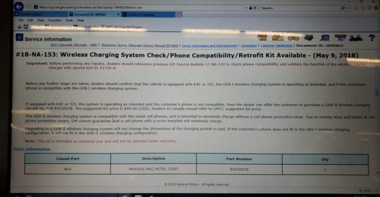

  2. my console had the charging lid and theres a wire hanging down underneath console is that the whole charger or do i need more?also where do i get the plug in connector for the merc switch and led light.. theres 2 connectors or plugs i need thanks
  3. I've got a 15 gmc 2500hd slt with center jump seat early build .. bought a new take off center console from a 2015i gmc 2500hd.. with the wireless charger.. i looked up harnesses and it only shows 2 diff ones.. one with dvd and one w/o dvd.. does anyone know if this will plug into my truck or need to splice in other components. thanks and i did read every page over last 2 days lol... thank you
