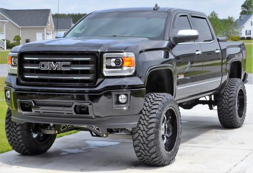

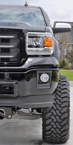

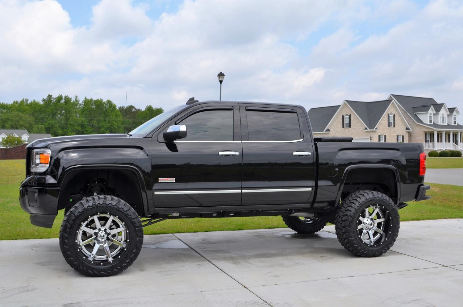

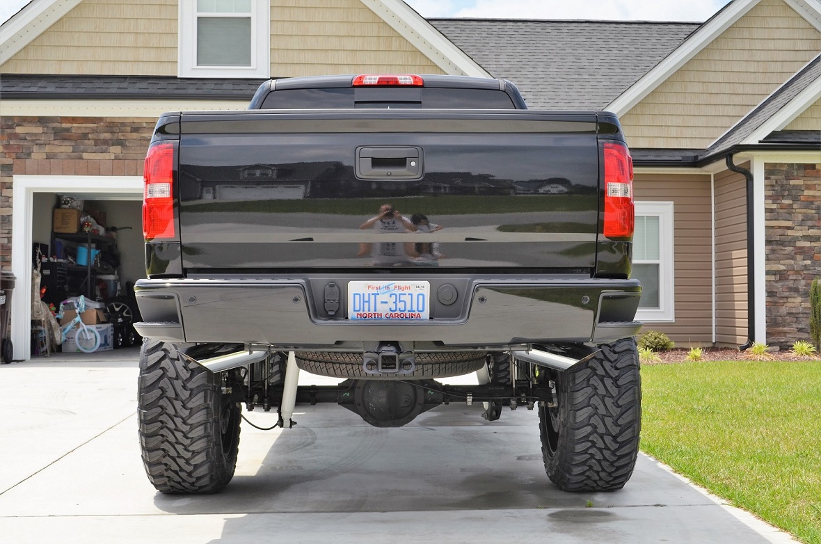

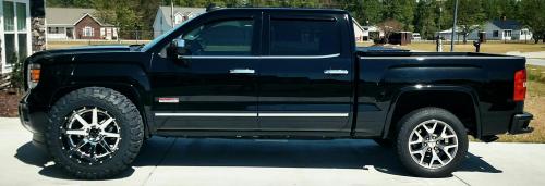

  17. Finally got her back and had some time to upload a few pics. Here's one more good shot.
  18. Finally had some time to take a few photos since I got her back. I'm pretty damn happy! 9" McGaughys suspension, 1.5" Zone body lift, 37x13.50r22 Toyo MTs, and 22x12-44 Fuel Maverick D260 wheels.

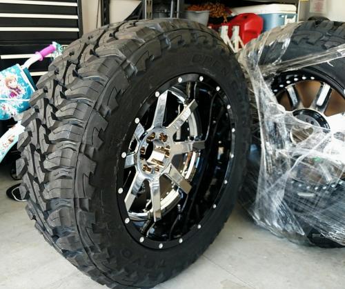

  21. Finally got these in. Can't wait for her to be lifted on these 37s.
  22. 37x13.50 Toyo Open Country MT and 22x12-44 Fuel Maverick D260s
  23. Finally got the wheels and tires in. Next week she will be lifted. Pretty damn happy! ?
