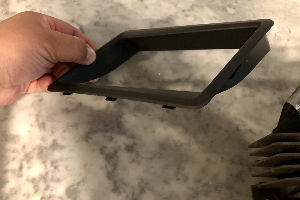

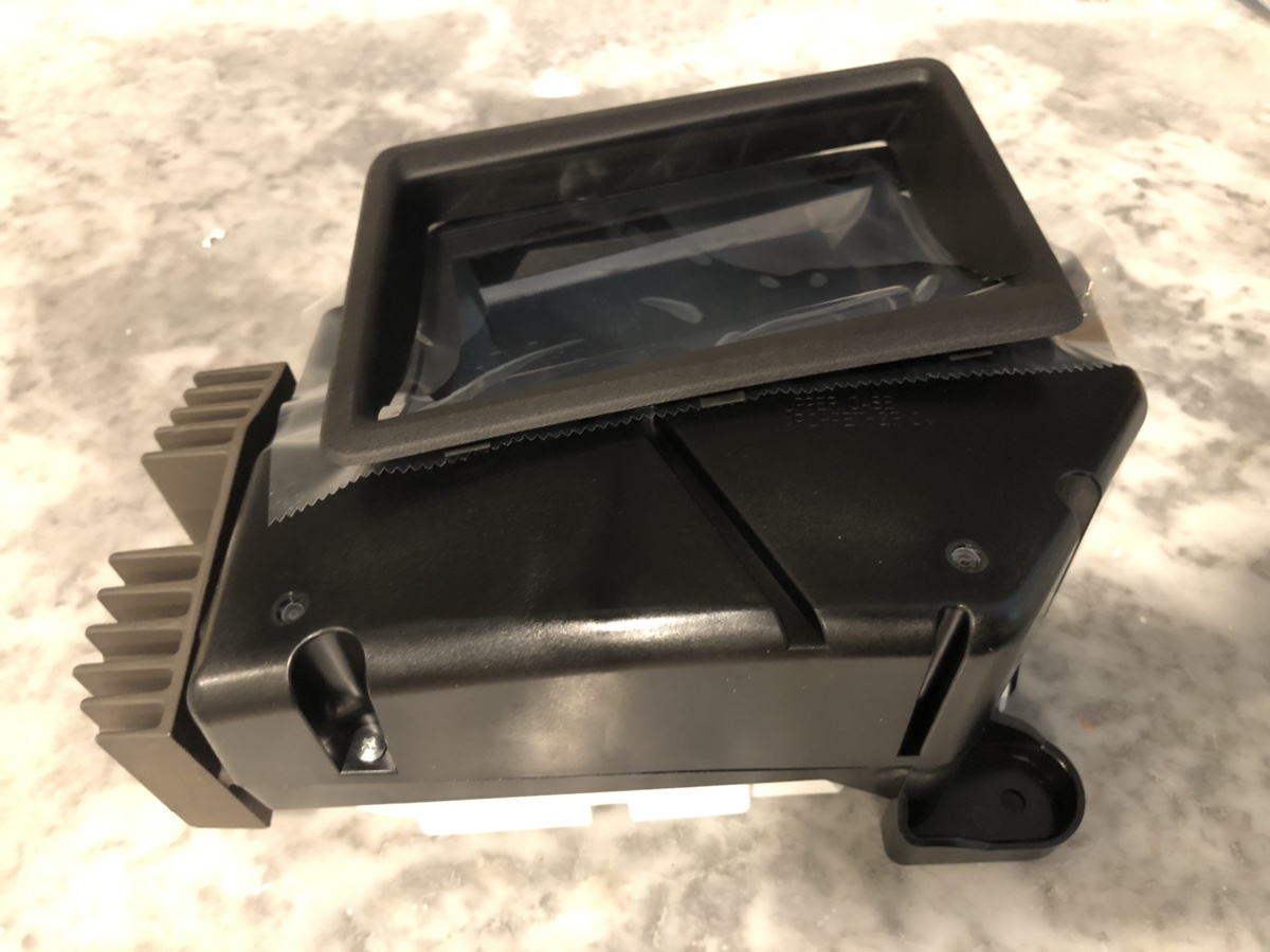

  17. Progress update.! Finally had the time to do the pre-install work measuring and fitting HUD to our gen 5 dashboard frame and dashboard itself. ***Note*** After doing measurements i realize what I wanted to do wasn’t going to work then I went and go ahead a cut the dashboard which I didn’t want to do in the beginning and as I was cutting I found the solution in the mistake I made, making everything come together like I wanted. Cheers!!! I know you all want is pictures so here the are.. I know this dashboard was cut But it won’t be once is finish since that’s not my dashboard, it’s the experimental one. But it’s sort of the finish product without the cuts. Here’s the speaker cowl after I fitted and install the HUD trim. No glue used, HUD trim has pressure tabs that need to be cut in order remove and install. Here’s the speakers tray, top one is the oem and the bottom one after fitting hud. Sent from my iPhone using Tapatalk

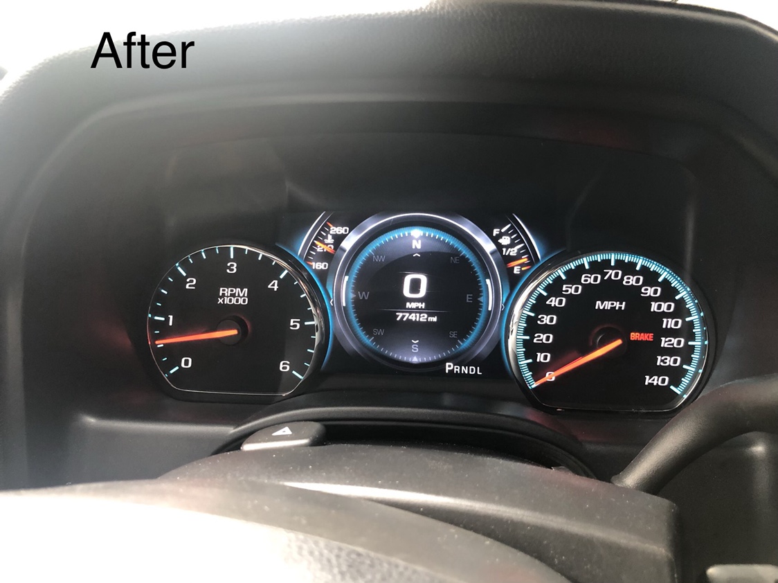

  22. Upgraded my 2015 Silverado cluster to a denali cluster.. shout out to whiteautoandmedia.com Great service and outstanding work.! Couldnt be more happy about it! Highly recommended!! Sent from my iPhone using Tapatalk
