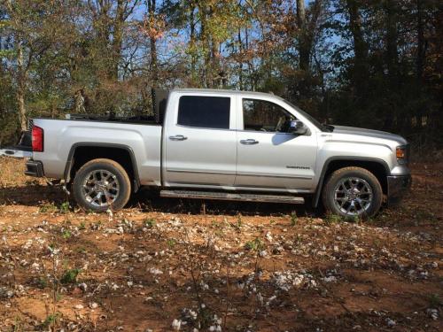

  4. For those curious about tire sizes... I ended up putting 275/60/20 Cooper ATs on my 2015 Sierra 1500. I currently do not have a leveling kit and do not have any rubbing issues. I was going to go with a 2" RC leveling kit and 275/65/20s, but saw some pictures where they were rubbing. I didn't want to risk having to shave back wheel wells for an extra inch of height. I may still put on a 2" leveling kit, but it is NOT necessary for the 60s. The pic is on a slant in a field. Will take a better picture on flat ground!
