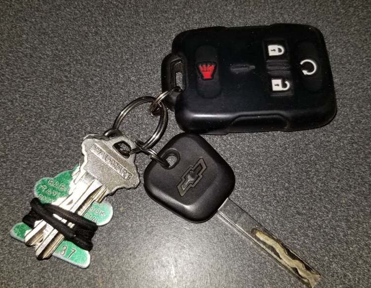

  1. I had the same issue. The sound drove me nuts in such a quiet truck. I bought a rubber case to go over my key fob on Amazon and put a hair tie around my house keys. I like your fix also.

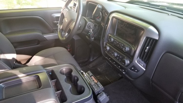

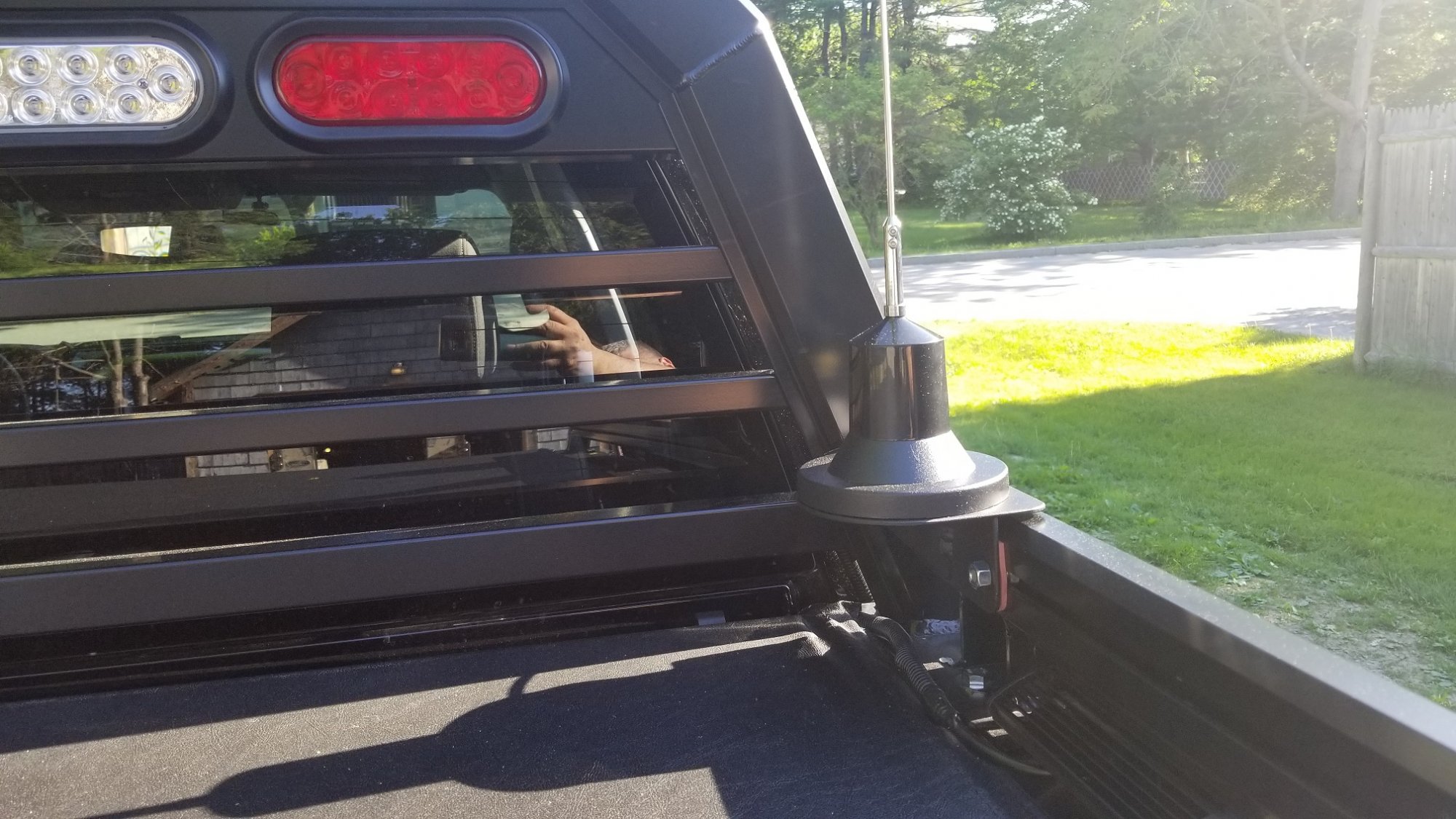

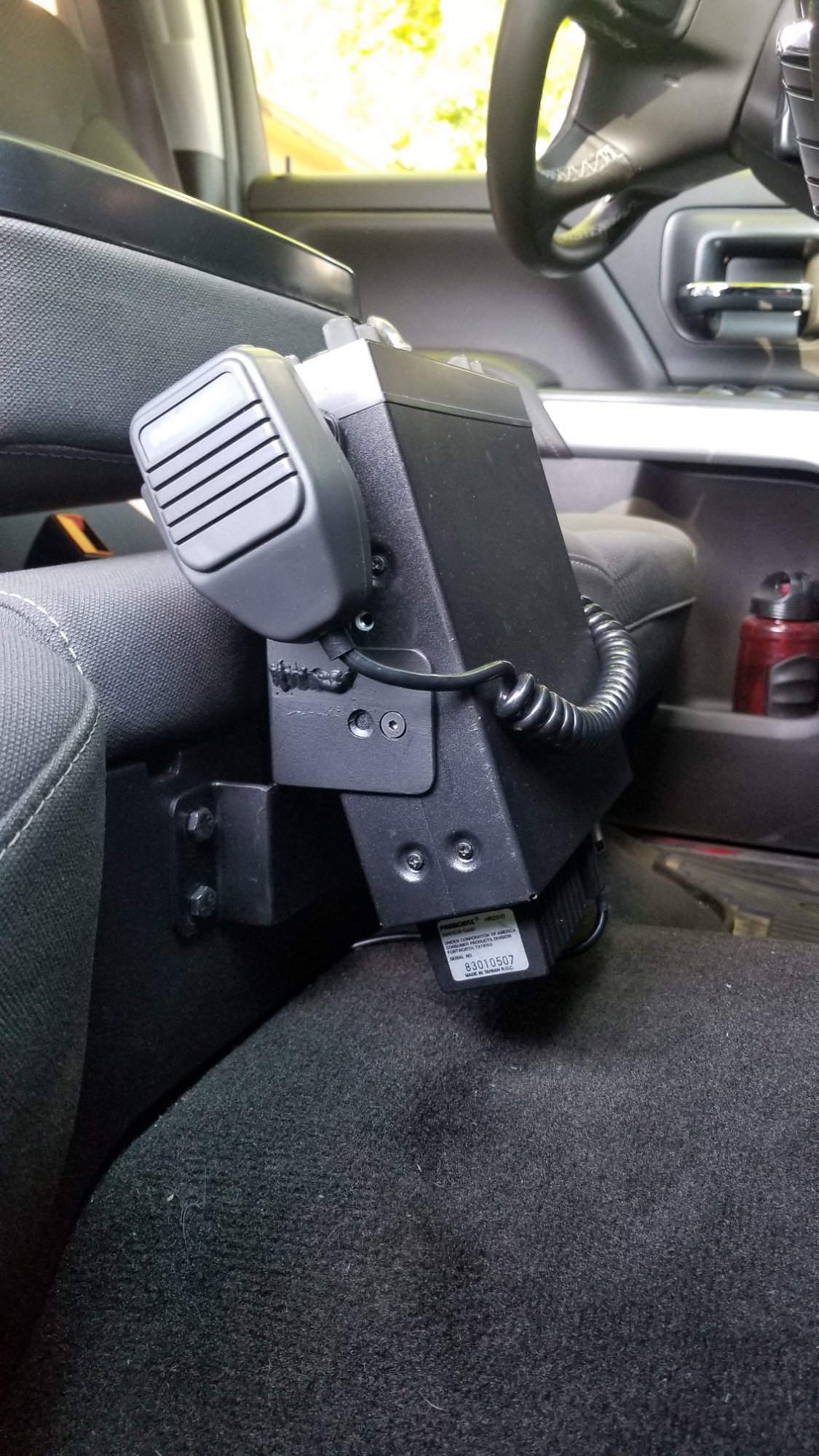

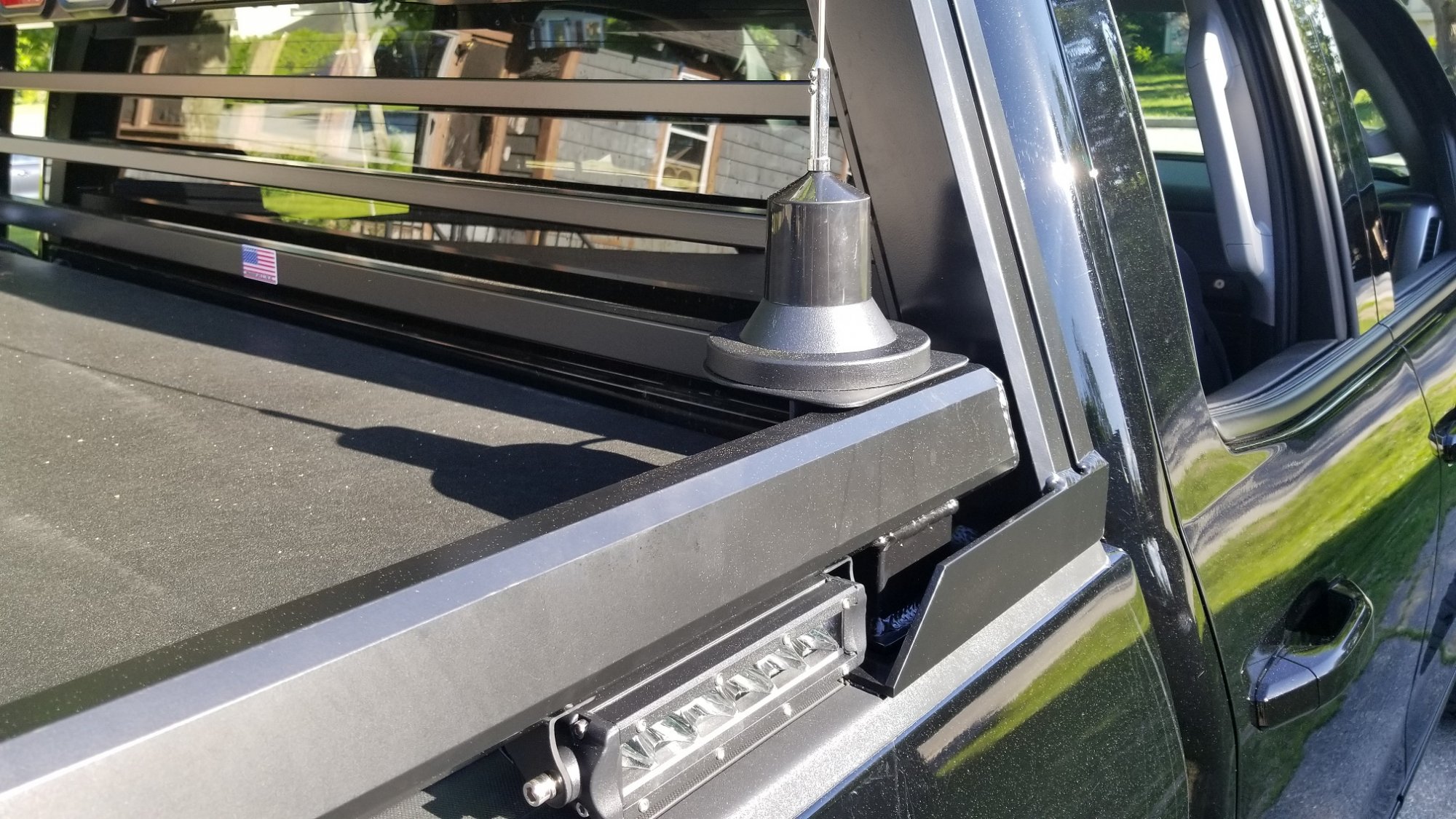

  4. I added a 10 meter / 11 meter radio to my truck. I have been a huge fan of the HR2510 sense I was a teen in the late 80's when I had one. I found one for a good price in great shape on ebay and had to have it. However, there is no simple way to install it so I cut and welded myself some custom mounts to install the radio and antenna. I did my best to make it as clean of an install as I could. The radio is powered by my 2nd battery. Antenna match is spot on and so far the radio works great. I might even get my ham license again. But we will see on that. I should add that up in the backwoods of Maine (where I live) there is often no cell service. This is the best way to keep in touch with people when you are offroad. Most times it is the only way.

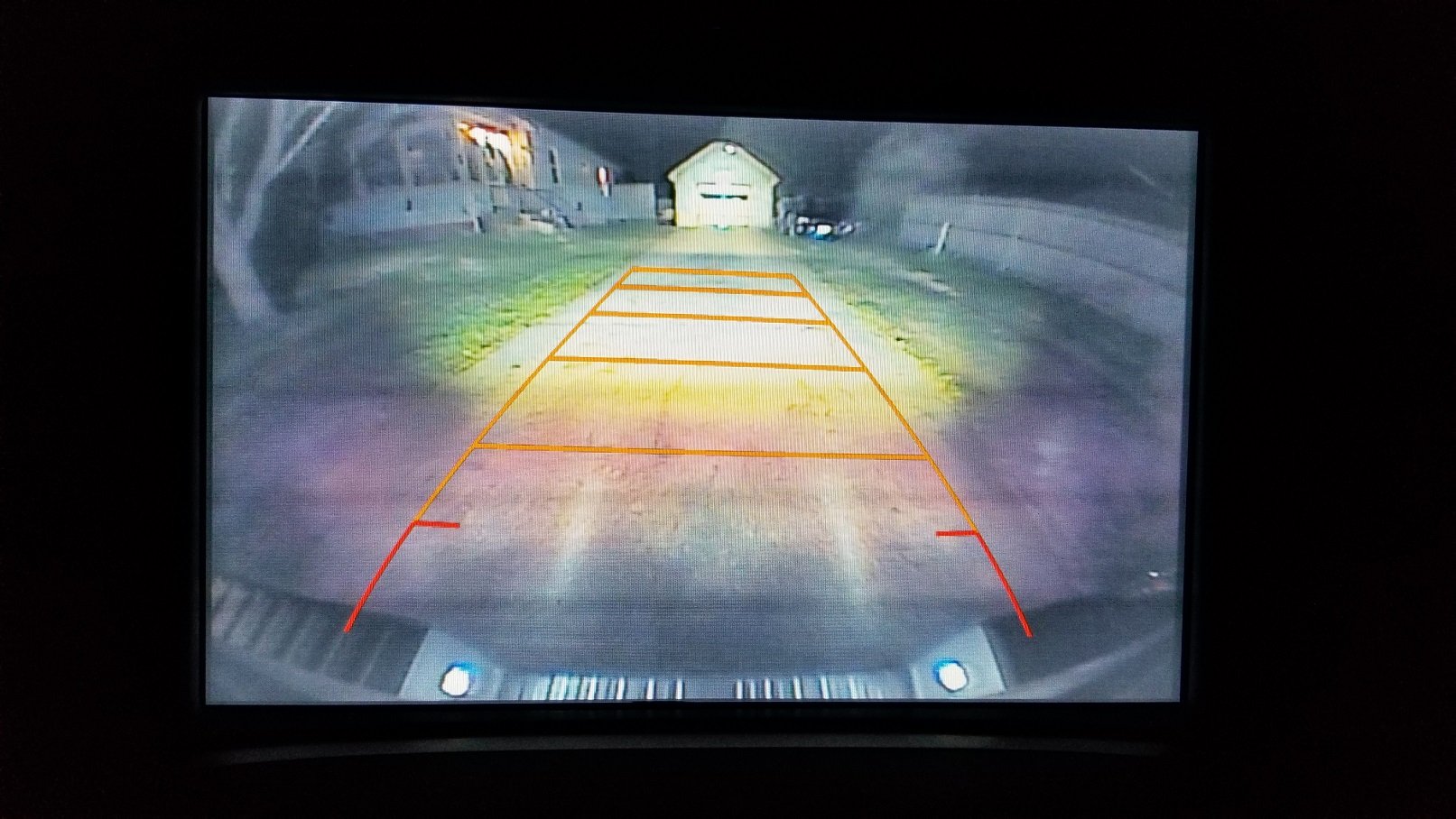

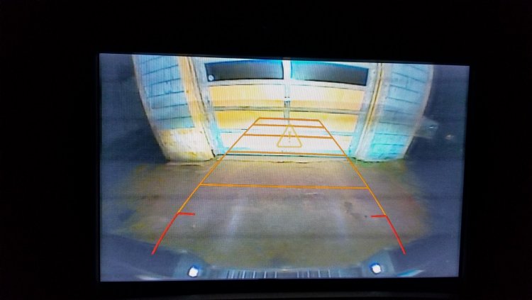

  5. 1st picture is with my normal back up lights as seen through the camera. I should say I have LED bulbs in the factory lights and I have 2 extra backup lights built into my headache rack but they are not super bright. 2nd picture is with the normal backup lights and my new Aux lights on. 3rd picture is with everything on right up against my garage. The camera just adjusts to the higher light level.
  6. I was worried about that also but so far it looks good. I think if it is going to be an issue I will see it this winter. I will take a picture of the cam when it gets dark.

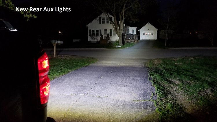

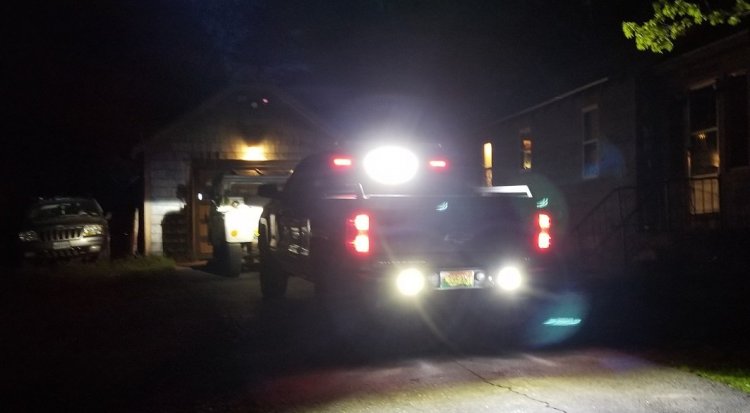

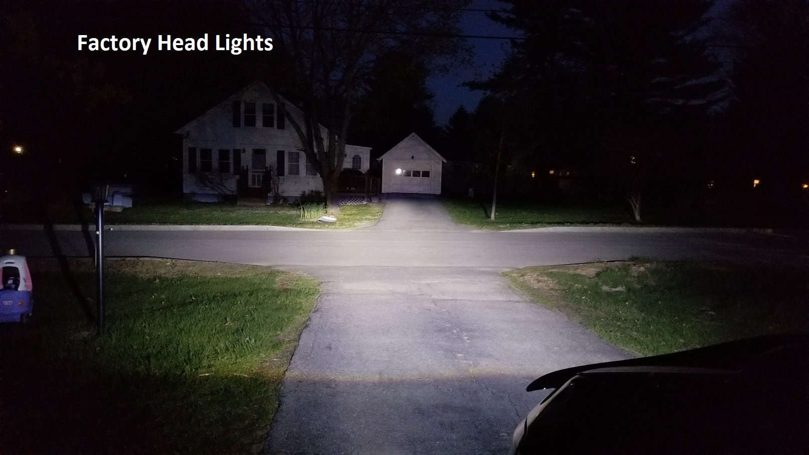

  7. I finished installing my rear and side aux lights for Camping and Plowing. The side lights are 3,700lm and each has its own switch to control it. Facing rear I have a 16,000lm light on the headache rack and 2 4,800lm lights in the bumper. The rear light can be used in one of 2 ways. 1st is with a switch in the overhead. The 2nd is when the cargo lights are turned on these rear aux lights will come on. So if the cargo lights are left on these lights will go on and off with the backup lights. I installed a waterproof switch under the left bed rail that turns off the aux lights so I can use the stock cargo lights without being blinded. Regardless of how the aux lights are switched they are powered by the 2nd battery I installed so I have no fear of killing the truck's battery by using them with the truck off. I went out of my way to install the switches in such a way that they look somewhat factory. Or at the very least don't look too tacky. I now have more light facing backward than forward as you can see in the pictures. I would like to add an LED light bar inside the grill but this being a 2017 I can't find one that will fit. Tho when I did all the wiring for this system I did install a switch and wiring for a forward light bar should I find a way. This is a complete stand along electrical system that only ties into the trucks system in 2 places. One is by way of a battery crossover with isolator and the other is a signal line from the cargo lights. My hope is that the dealer will not give me a hard time if I have a warranty issue in the future.

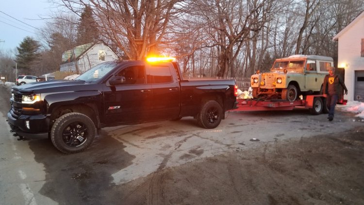

  8. I added a Land Rover to my truck

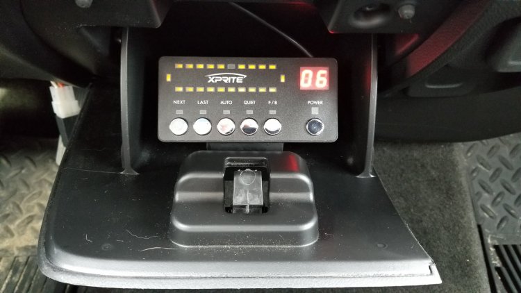

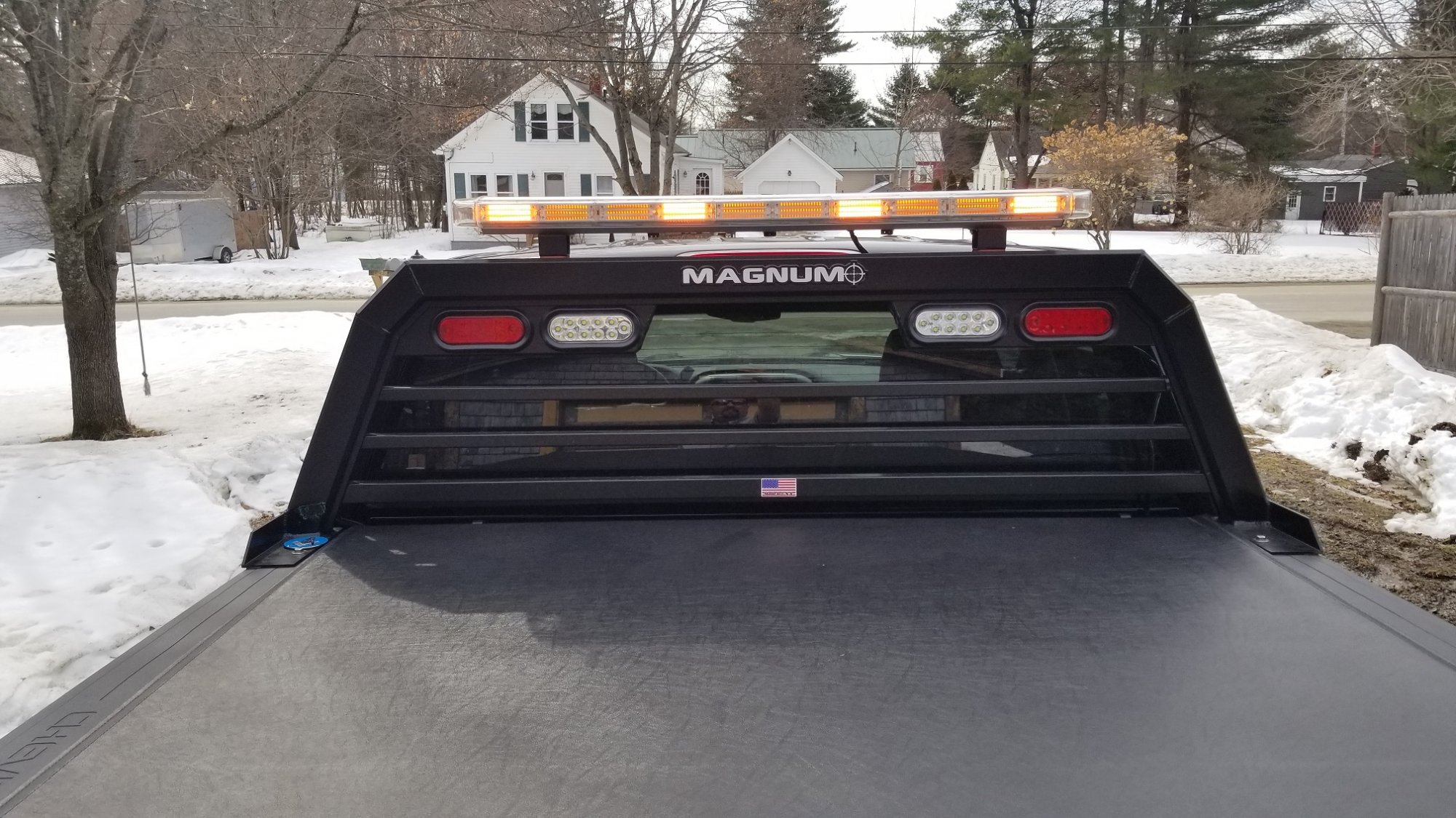

  10. Added a beacon to my truck. I decided if I was going to do it I was going to do it right. I hid the controller so I don't have to look at it when I am not using it. I also mounted the light in such a way that I can unhook it and pop it off the truck in a few minutes when spring comes. Funny thing is I just did an 800-mile road trip and this light cost me about 1.5 MPG!

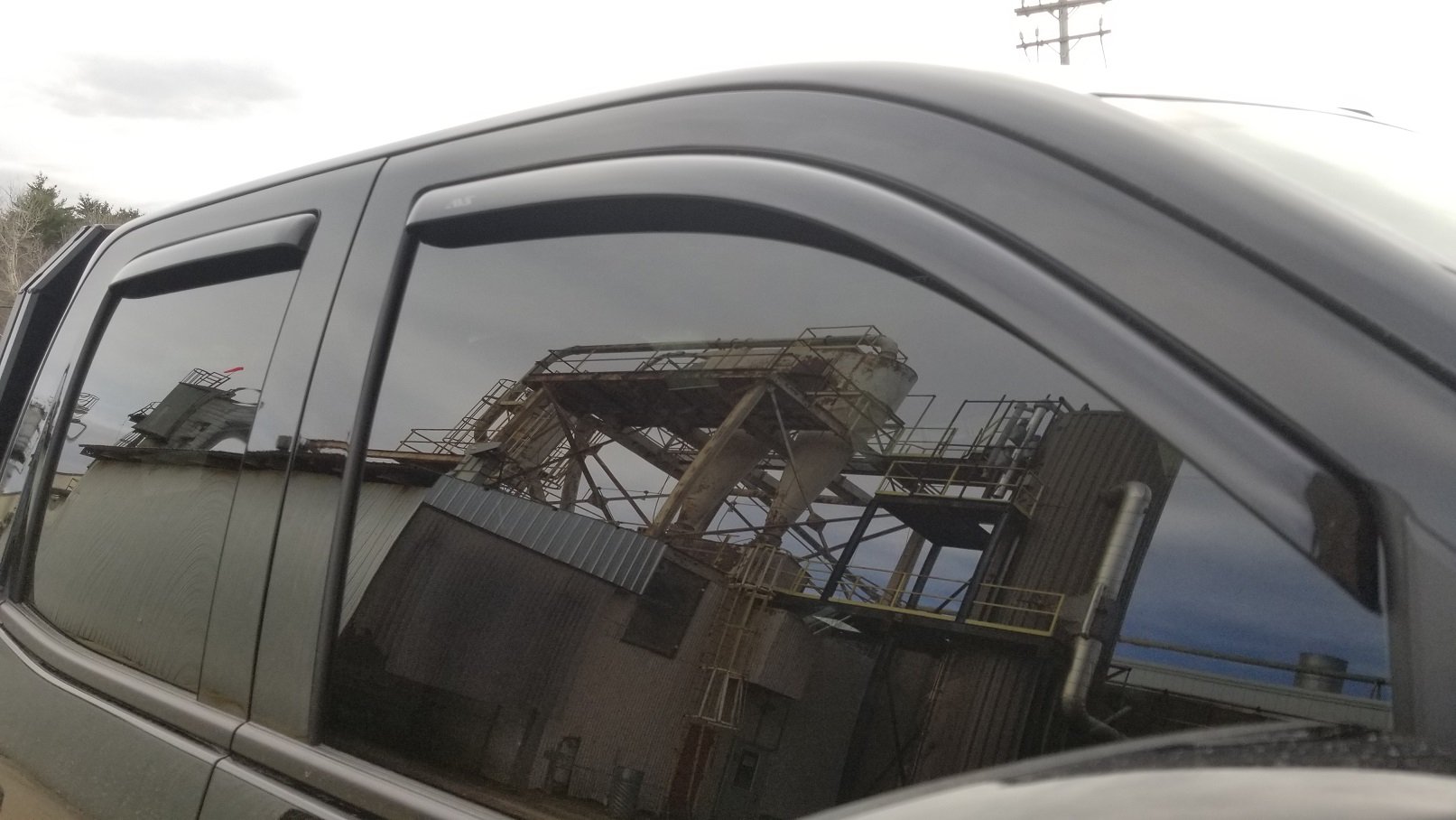

  11. Installed a set of vent visors today.

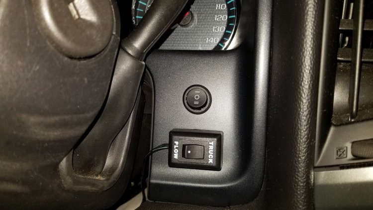

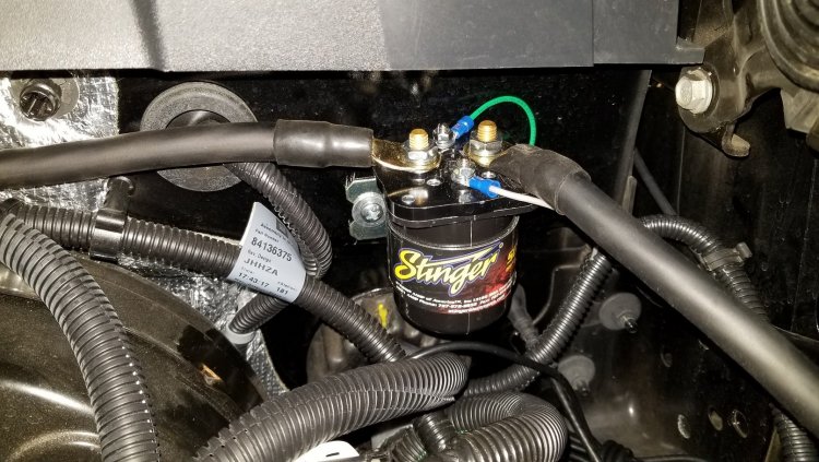

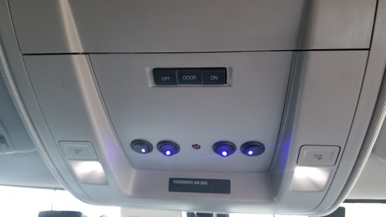

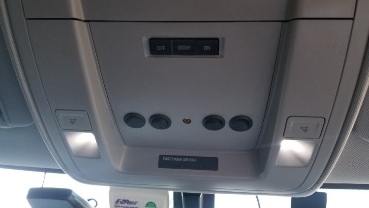

  12. I installed a 2nd battery today. I used a solenoid to isolate the 2 batteries. I installed a small 3 position switch to control the solenoid. It has 3 modes. Mode 0 the batteries are isolated no matter what position the key is in. Mode 1 the batteries are isolated when the key is off. When the key is in the run position the batteries are tied together letting the 2nd battery charge. Mode 2 the batteries are tied together no matter what position the key is in. Mode 0 is for should there be a problem with the 2nd battery or anything on that system it can be isolated from the factory electical system. Mode 1 is how the system is run normally. All my added lights and accessories are on the 2nd battery. So if I am at camp and run this battery down I can still start the truck. The battery will recharge as I drive. Mode 2 is for when the factory battery is dead for some reason and I need to boost myself. So I can boost the truck without getting out of the cab. You don't want to leave the switch set to mode 2 because the solenoid would run the 2nd battery down over an extended period of time. I will make a thread with a better discription, pictures and a drawing if it will be of any use to someone. I ran this setup on my 2001 Z71 for a few years and it worked well. There I used it to run a 3000-watt inverter. Soon I will be reinstalling that in my 2017.
