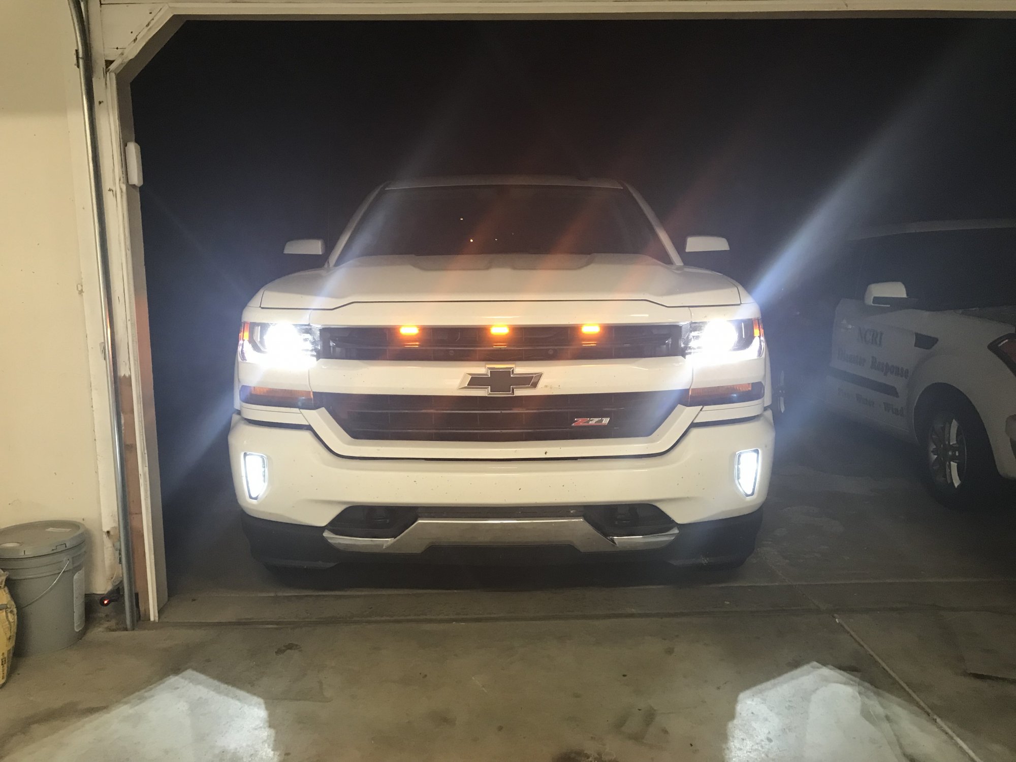

  1. Yep. I just found a bolt to the chassis near the fuse box
  2. I Hooked them up to the trailer fuse #15 in the X50a fuse box under the hood on the drivers side with an add a circuit. I am against splicing into the factory harness, so I bought an “add-a-circuit” which allows you to tap a power source in the fuse box without effecting the factory harness.
  3. Yes that’s correct. You can position them any way you want on the grill and peal and stick them with weather proof 3m double side tape on to the grill. It looks very clean. I found them on YouTube looking for amber marker lights. They come from F150led.com, search raptor style lights. You should be able to find a 10-15% off coupon. I got mine for $87 shipped. The guy does an install video on YouTube.
  4. I found them on YouTube looking for amber marker lights. They come from F150led.com, search raptor style lights. You should be able to find a 10-15% off coupon. I got mine for $87 shipped.

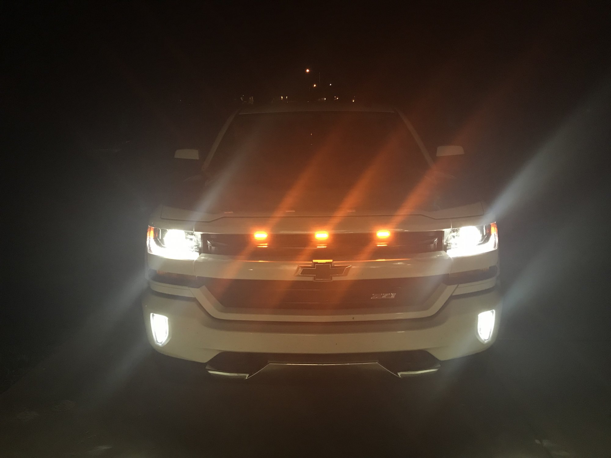

  5. New raptor style amber running lights
  6. Just got mine done. No drilling or cutting required. Hooked them up to the trailer fuse #15 in the X50a fuse box with an add a circuit. Very happy!
