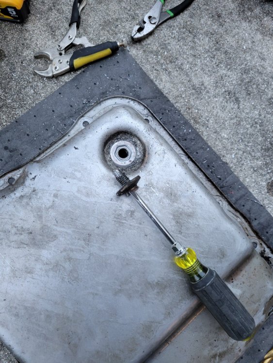

Finally got around to servicing the transmission, honestly doesn't look bad at all to me..... it definitely smelled burnt, still red and no real debris in the pan. ...the magnet had a layer of grease or felt like grease but i think the pan was way dirtier last time i serviced this transmission..... anyhow the exhaust manifold bolts came loose fairly easy considering...... In fact i cant believe how easy this whole ordeal went. I even had time to drill out the stock pan drain plug and install the new one ive had sitting in my tool box for over a year now. I have a severe oil leak going on though, definitely a rear main seal and probably the valley cover or somewhere up high... My driveshaft still has a wobble so and i have moog u-joints to toss in on the driveshaft, i also plan to take my truck to the tire shop and get the tires rebalanced and rotated and some better lug nuts installed as i think the cheap ones i bought from the part store are too short causing my wheels to possibly not tighten properly.......i broke one of the cheap lug nuts awhile ago and swapped it out for an open acorn i had laying around it made me think hmmm........haven't dont much to grumpy as ive just been using it to putter back and fourth between work which is only 4 miles a day. Plus errands but the miles have not been racking up since i moved closer to work luckily. Now thats it cool outside all thr parts stacked up in the corner will be installed over the next few months in my spare time. Tomorrow i may even scotchbright the roof, the clearcoat is gone but their is enough color left that I'm going to just clearcoat the roof and the hood and some of the body will be getting black vinyl wrap -

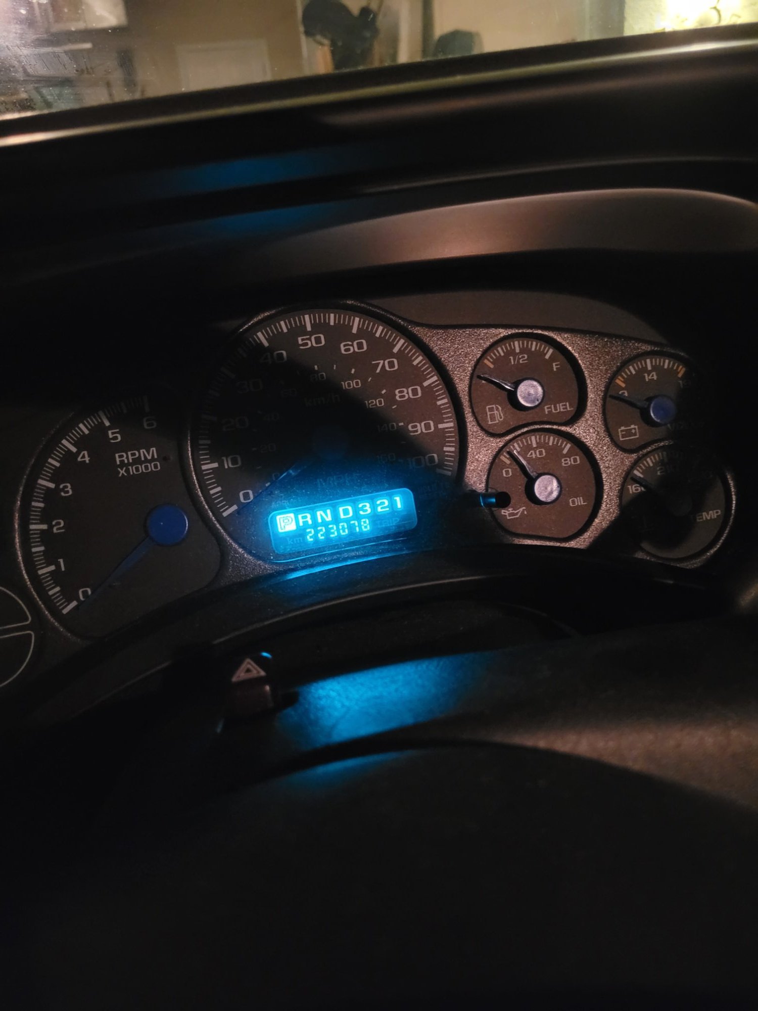

Now that my trust in Grumpy has been restored with the oil pressure issue fixed. I have been driving grumpy normally and i have 45 psi at idle and then during normal driving it rises to 60 psi. Basically anything over 1500 rpm and it sits around 60psi. Honestly a huge relief. As for my exhaust gaskets, I have not found time to change them yet as I had planned. I did go through and tighten all of the manifold bolts and found 2 loose ones and the truck has quieted down. Its still noisy and leaking as some of the exhaust gasket is actually blown out and nonexistent. Its time to finally finish upgrading the brakes. These are the 13" front rotor and bigger front brakes from a 2008 and newer truck. I upgraded the rear to dual piston 13" rotors almost a year ago now! Wow! (We made it through 2020) To run these brake calipers a 17" rim is needed. I got the rear brake calipers at a junkyard and I think I'm going to order some news ones just to be safe. I did go through one of them but the remanufactured brake on the rear driver side has always given me problems and now its sticks sometimes. Anyhow I hate doing brakes, it's like my one pet peeve that I'll pay whatever price for someone else to fix it. However I'm going to tackle it once more. Anyhow I'm going to either do exhaust gaskets or my transmission oil filter and fresh trans fluid this weekend hopefully! Also my passenger window motor died! I may leave it as The bottoms of my doors are rotted. I may have found some doors off of a part out truck on Facebook marketplace and I'm sure those windows are fine or at least working. No rust being from Florida, but I don't plan to paint my truck until march or April but honestly it might be later than that (times are wild). I also don't have the room to store 3 doors so I'd need to swap them immediately and a mismatched truck will drive me nuts! I don't know if I should spring on them now or just wait as I have seen a lot of these trucks getting parted out because of the LS engine craze. New doors off of a newer year truck is the best option instead of welding patch panels because my passenger door has a nice dent, my driver door almost got ripped off backwards, and the rear passenger door is just plain easy to swap. A 2x4 and a hammer and the new door hinge pin kit will make the new doors line up perfectly. So much stuff to do, so little time to do it! I have to finish the big maintenance stuff before I get back to sanding the 20" rims. Gotta have the good bones to rock the flashy big rims and tires. Honestly though these rims are pitted and I'm going to paint them to match the truck. They are nice rims but also dirt cheap so if I Curb one I won't die a little inside like some of these guys rocking forces for $15,000. Respect to those guys because I just can't do it. Sent from my SM-G950U using Tapatalk -

The most important photo didn't upload! Geeze! Check out the oil pressure guage now! Sent from my SM-G950U using Tapatalk -

GREAT NEWS! In this case i can literally say third times the charm! This is the third oil pressure sensor i have put in this truck. I guess I didn't know my own strength and broke the previous 2 senors on install. First off it took me 20 mins to do this and that was with me stopping, cleaning my hands and then taking photos. I did cut my arm on a fuel line but its a tight squeeze and i don't even care because i have great oil pressure! The first time i changed this sensor i remember it being dead of winter, i was outside and it took me like 3 hours of cussing. Only reason this one came out so quickly was because i used my earthquake braappp braappp ratchet. I took of the electrical connector, then i slid my oil pressure sensor socket on the oil pressure sensor and it immediately fell over. Then i pulled it off and out came the top half of the sensor with the socket. To clarify i did not put any pressure on the sensor, just put the socket on and then let go and it fell over. After the top of the sensor came off, i reached in with the socket again and got it to latch on the bottom half of the sensor still in the block. Then i proceeded with adding and universal joint and 2 extensions onto my brapp brappp. I hit the switch and the bottom half of the sensor came out easily, i actually lost it on top of the transmission so hopefully it falls out. So to reiterate that i didn't put tons of force on the sensor when i installed it, my earthquake ratchet cannot break a bolt over 25 foot pounds. Now 25 foot pounds is a lot, but this is also through a sharp angled universal bit and extensions. So i don't feel that i overtightened the old senors by much but just enough to crack and leak and over time it lead to failure. I hand tightened the new sensor as much as possible then i ever so gently tightened it with the socket and regular ratchet. Plugged in the sensor and start grumpy and BINGO! OVER 40PSI OIL PRESSURE!!!! As i was tackling this i was looking for extra oil leaks and found my pcv hose has oil all around it, and behind the oil pressure sensor i stuck a finger down there and found my oil leak that is coming down to the bottom and making it so my rear main looks like it is the culprit. I will keep monitoring the oil leaks but next project is Sunday for my exhaust gaskets which i can now confirm is leaking and causing the excess ticking noise that brought me on this whole operation in the first place. I feel relieved, i was starting to feel like i couldn't rely on grumpy as a daily driver anymore and my future plans for grumpyghost were in jeopardy if i couldn't find oil pressure i felt comfortable with. Now im thinking i should get some long tube headers and delete the stock original cats and do a mild tone dual exhaust like i once had on grumpy. Oh and maybe a cam swap and HP tuners by the end of this year if all goes well. I had a dad day at work, but after i got done working i somehow got a 2nd wind and decided to tackle this project and now im happy as can be!!! Hope yalls day goes well! Sent from my SM-G950U using Tapatalk -
