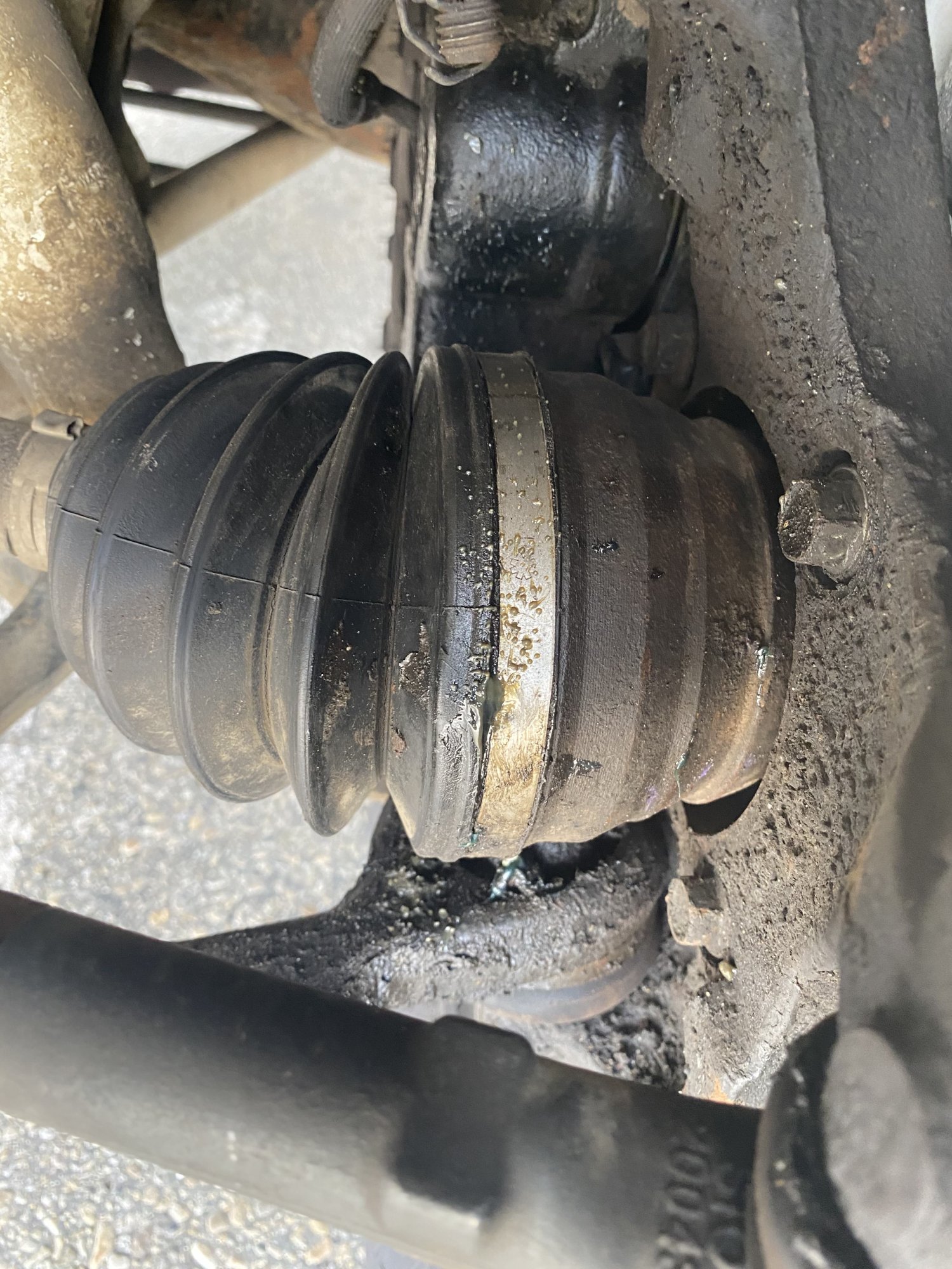

  1. hello, looking to get some input. stopped by for a oil change as im on the road rn, and the tech pointed that he noticed a small leak at the cv joint where the clamp is. the other cv axle seems completely fine. i took some pics and wanted some input. im going to be driving about 1000 miles more until im back home, and then once im home ill look at getting it repaired/fixed. do you think this is a situation where i have to get it fixed asap? or should i be fine getting it fixed once im back home? thanks!

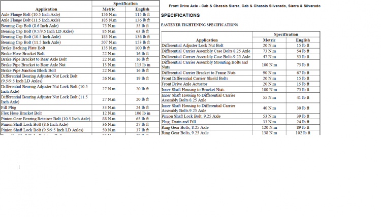

  5. attached pic of service manual. he is correct. seems like 24 ft lbs for both the front and rear fill and drain plug and also 30lb ft for the case(i think its on the other page)
  6. well i tightened up to 24 ft lbs for the plugs and the difference was minimal. i barely applied any muscle and it clicked for 24. it was at 13 ft lbs before is the difference between 13ft lbs and 24 ft lbs barely anything?
  7. Yeah I've read the same thing as @newdude front diff fill plug and drain plug 24 ft lb rear diff case bolts 29 ft lb and rear diff fill plug 24 lb ft thag means I should probably tightener up a bit more
