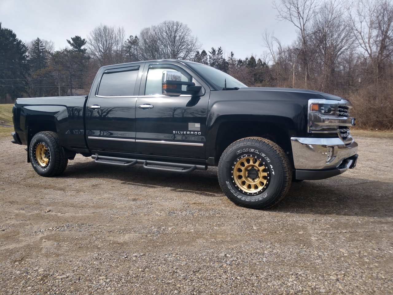

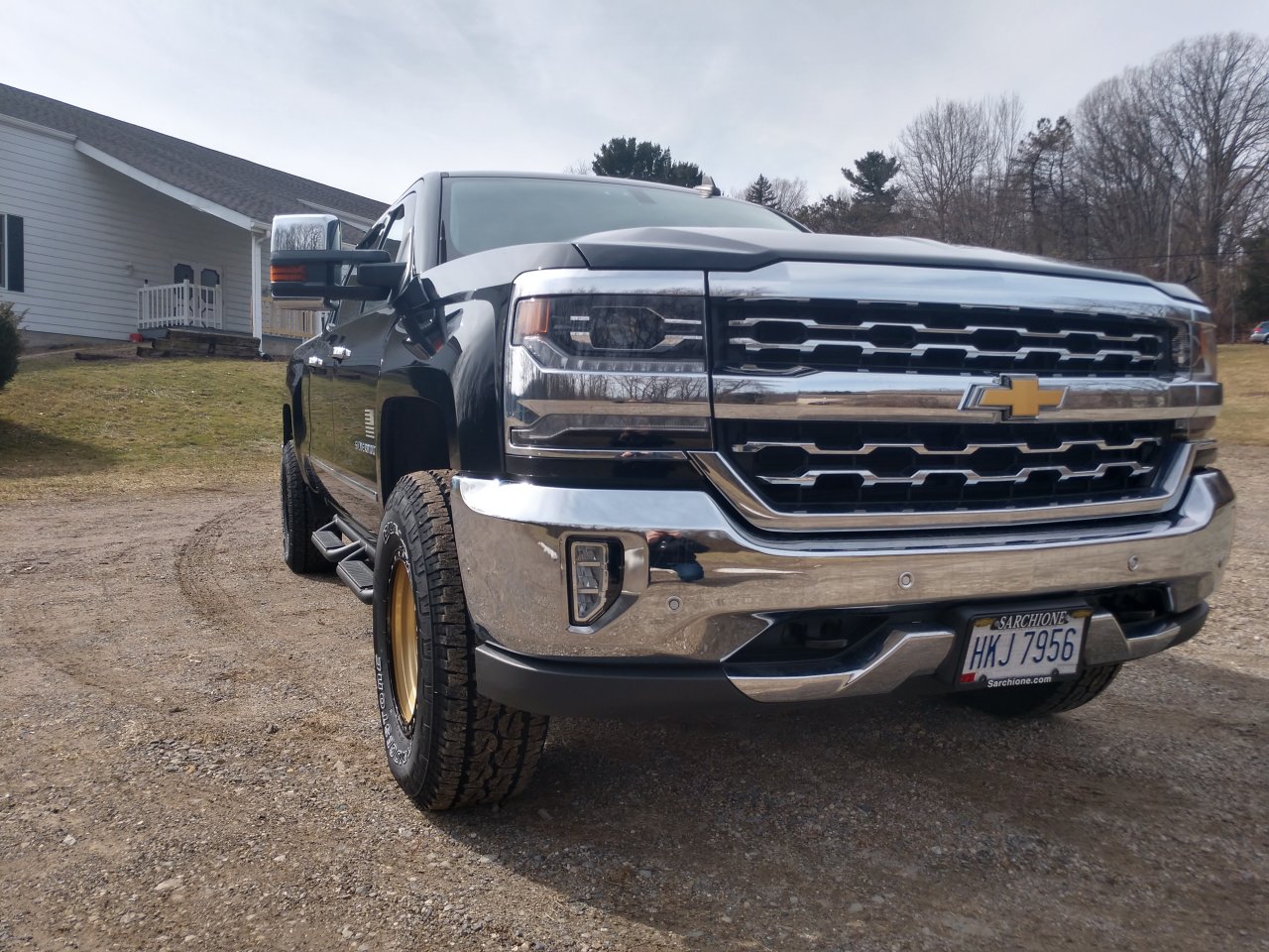

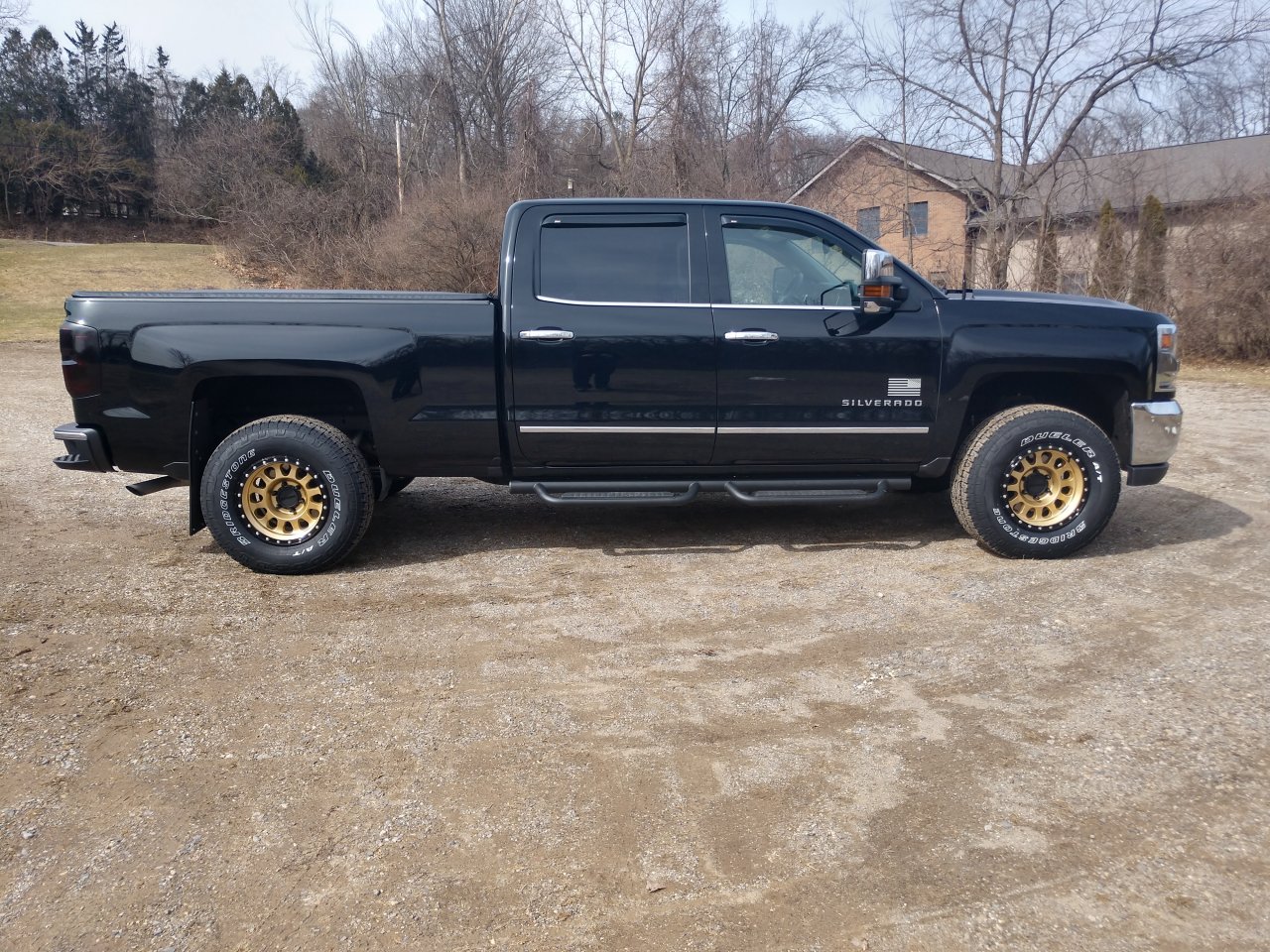

  20. Just recently switched from the stock 18's to these Methods. I love the way it came out! Method 315 17x9 -12 Bridgestone Dueler A/T Revo 3 P285/70R17 2019-03-02_12-59-18 by Mike Kubiak, on Flickr 2019-03-02_12-58-13 by Mike Kubiak, on Flickr 2019-03-02_12-59-39 by Mike Kubiak, on Flickr 2019-03-02_12-59-58 by Mike Kubiak, on Flickr
