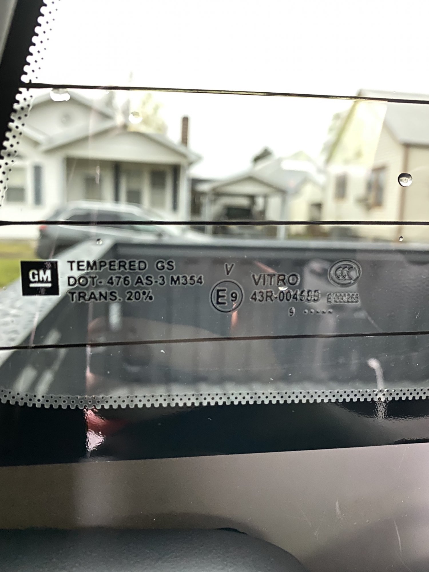

  4. Iv posted in here a few times before but now I officially get to join the club. 2020 RST with slider build 11/19. Bought 12/10/19 with 3400 Miles happened after a light hand wash Been checking after every rain and every wash since I bought it. This is the first sign of water I noticed

  7. I think iv just found something. My E9 window appears to have a different wider shape where the track ends. this is my e9 Looks like the plastic goes outward Saw this picture of a cracked frame a couple pages back. Look where the track ends the plastic goes straight up
  8. Nope it’s a slider. No leaks yet. I hope that e9 means it’s a newer design
  9. Mine is E9. Built on 11/19

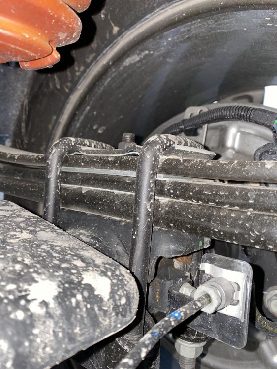

  16. I have a 2020 built on 11/19. Right away I noticed how visible the defrost strips are from the outside. Hopefully it’s a new window/design on mine
  17. That’s weird. I was starting to think they forgot to add a block in mine. My truck is only 1.25” lower in the front than the rear so a 2.25” in front and 1 block would be a nice lift/level
  18. My truck is a 2020 rst 6.2L 4wd. Has no block from the factory
  19. I’m looking to do a 2.25” leveling kit in the front and also want to add a 1” block in the rear but I can’t find any 1” lift blocks for 2019-2020. Does anyone know if the Blocks from previous years work?
