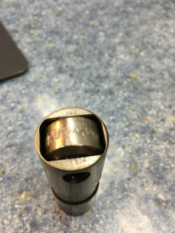

  2. Well, I gave up and dropped the truck off at a GM certified shop near me. After a couple of days messing with it he called and said he was pretty sure it was a lifter so I told him to go ahead and dig in. He found the exhaust lifter on #5 to have a roller that was kind of chewed up and the cam was damaged as well. I attached a pic of the lifter, I hope it's visible. It's frustrating because No. 5 not even an AFM cylinder. He said the plastic lifter tray wasn't cracked and it didn't appear the lifter had rotated, not sure why it did what it did. However I'm not the original owner, it was a trade in vehicle at a Ford dealership when I purchased it back in November. It may have had repairs prior to me buying it that were done poorly just to make it run to trade it in. So of course that meant new cam and all new lifters. I made sure he got the newest updated GM lifters, replace the plastic lifter trays, and had him change the VLOM to the newer updated version. Knowing he was going to have the timing chain cover off and would be looking at the oil pump, I had him replace that too. The truck now idles quietly and smoothly, no misfires, and has the throttle response of a new truck. Just wanted to say thanks to all who shared their thoughts, and post the solution to the P0305 misfire in hopes it helps someone who finds this discussion later.
