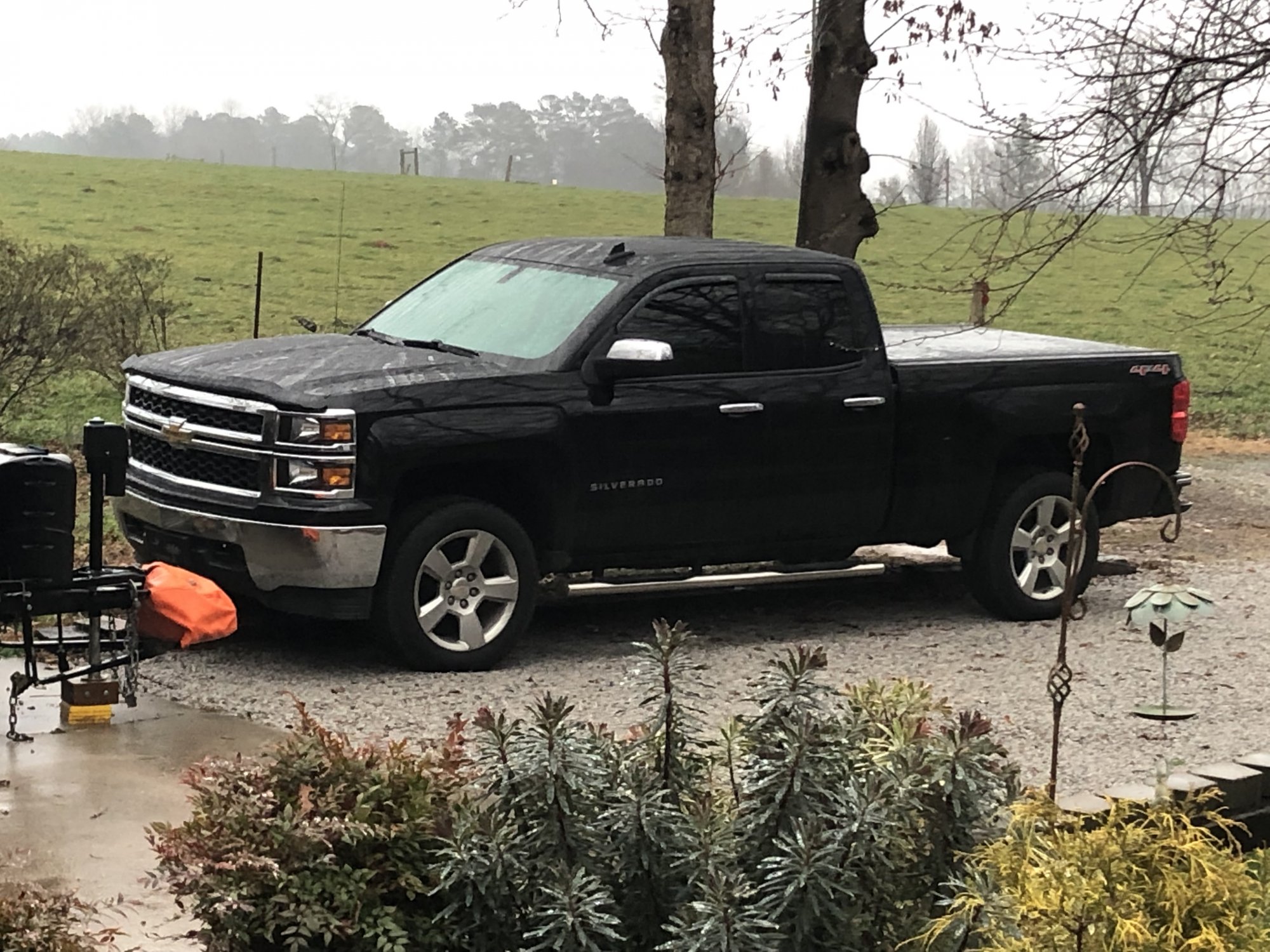

  1. Bought my 2015 WT used last year with 104,000+. My first Chevy in quite a few years. According to the carfax all service had been done at the selling dealer since new and on schedule. The truck now has ~150,000. I had to replace a cracked AC condenser a couple of months ago but otherwise it's simply been maintain, gas, and drive. Trans fluid and filter changed. Coolant flush and front/rear diffs scheduled as soon as I get garage time. New plugs when I brought it home. Had a 5startuning tune installed and now the truck acts like a truck should. So far with the tune I'm averaging about 18mpg and I can live with that:-) Put Bilstein 5100's on it a few weeks ago and it handles better but doesn't ride as good as the OEM black shocks. I plan to maintain and drive this truck for many more miles. It's paid for, runs great, gets decent mileage, it's comfortable, quiet, and it looks good. I've made lots of mods to the interior to suit me and I like it just as it is. I pull a camper and a blower and exhaust are on the table for later this year otherwise.....just gonna drive it.
