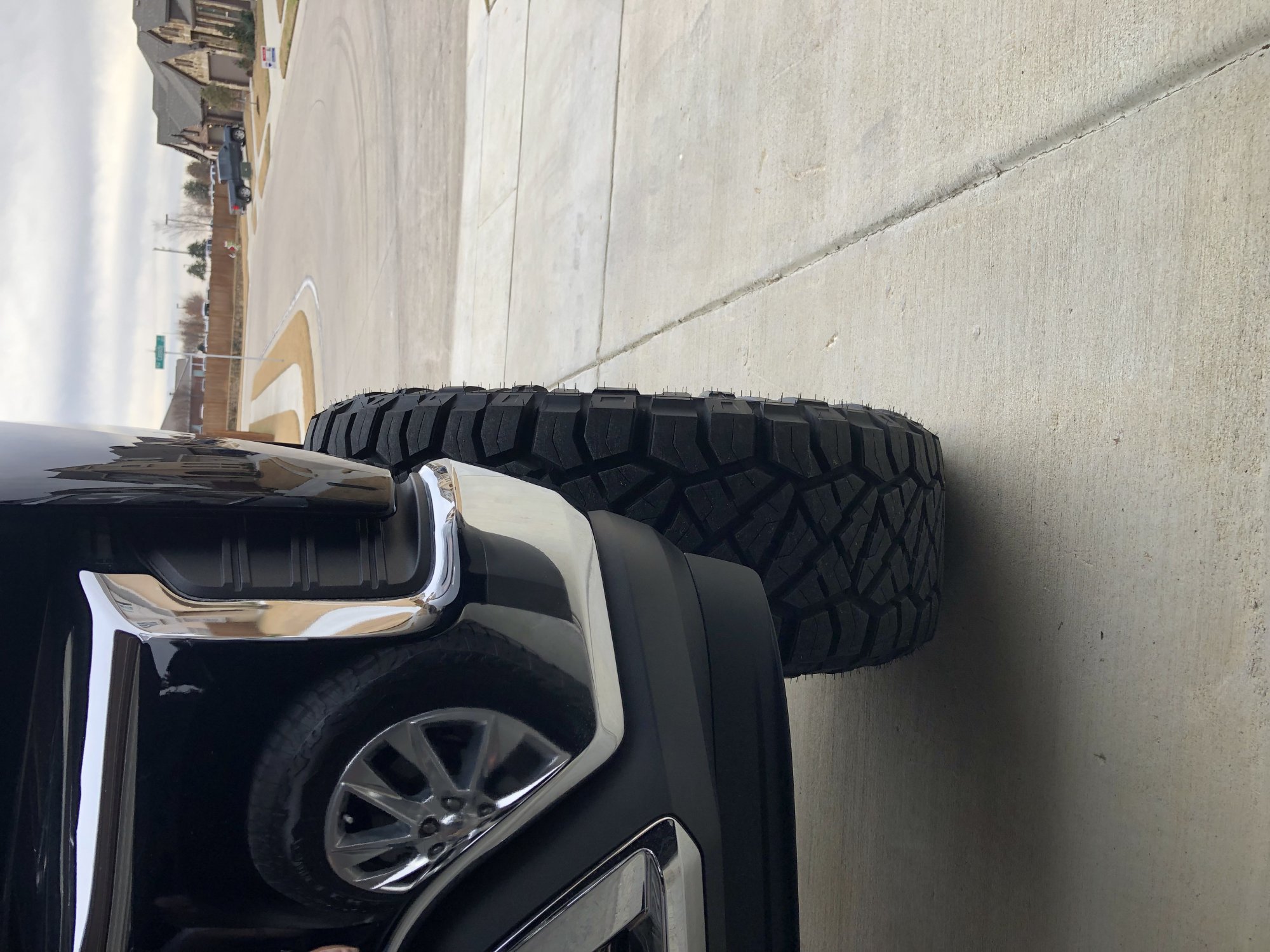

Yes I am sticking out about an inch more than I wanted. I wanted to do the 20X9 wheels but it doesn’t look bad. I took a picture for you for you to show

6” BDS Lift Fox 2.0 Shocks 35 X 12.5 X 20 Nitto Ridge Grapplers 20 X 9 Moto Metal Shift -
