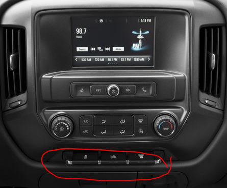

  1. I seen it here before but searching for it, I could not find it. I am looking for information on how to get the sticker sheet of labels for the auxiliary switch module in the attached picture. so you can reassign them for other uses.

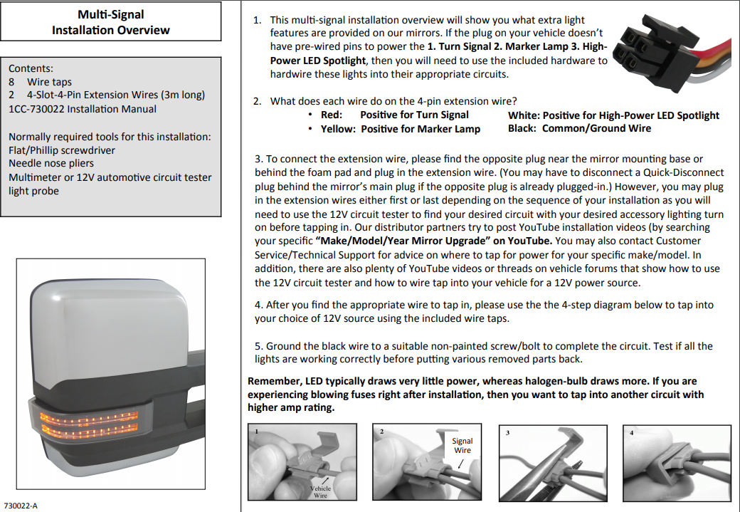

  4. New to the group and wow all the information is overwhelming, 99 pages on towing mirrors alone. Here is where I need some help, I have a 2018 Silverado 2500HD WT that came with DL8 Mirrors (remote adjust & heat) and I purchased towing mirrors from 1A Auto - but they will not help me with what wires to tap into to add the turn signal, running light & cargo light functions to my new truck to help me tow. I have the mirrors installed, all the wires run through both door jams and into the cab under the dash ... HERE IS WHERE I NEED SOME HELP. Can anyone tell me what under the dash control module, and what wires to tap into to get these new functions to perform? The mirrors I purchased were 1A Auto TRMRP00045 which has a 4 wire harness included to use to tap into the truck, The included wire harness has 4 wires Red = turn signals, Yellow = marker Lamp, White = Positive for high-power LED cargo spots & black = Common ground. See Below PLEASE HELP !!!
