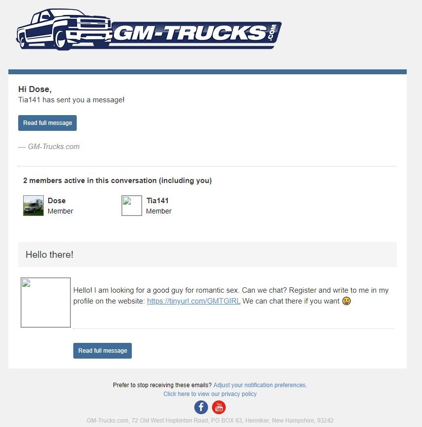

  1. Hi,
    I picked you out because it looks as if you are one of the leading members in this forum. My question: is it quite normal to receive mails like the attached one?
    Best regards
    Dose
    1. OnTheReel
      OnTheReel
      They said they got hit pretty hard with spammers the last couple days. I wouldn’t say it’s normal and it should be taken care of now.

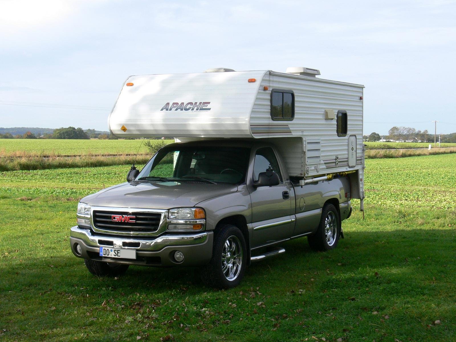

  3. Hello Ryan, meanwhile my GMC is back on the road, the Jasper transfer case is installed and everything works perfect. The picture was taken last week on a camp site in Eastern Germay about 350 miles away from home. All the details with Jasper and a very kind customer service (Thanks a lot Angie!) have made it very easy for me to order a heavy part like the transfer case from thousands of miles away from the USA. Insofar thanks to you, Ryan, for your tip. Regards Jürgen
