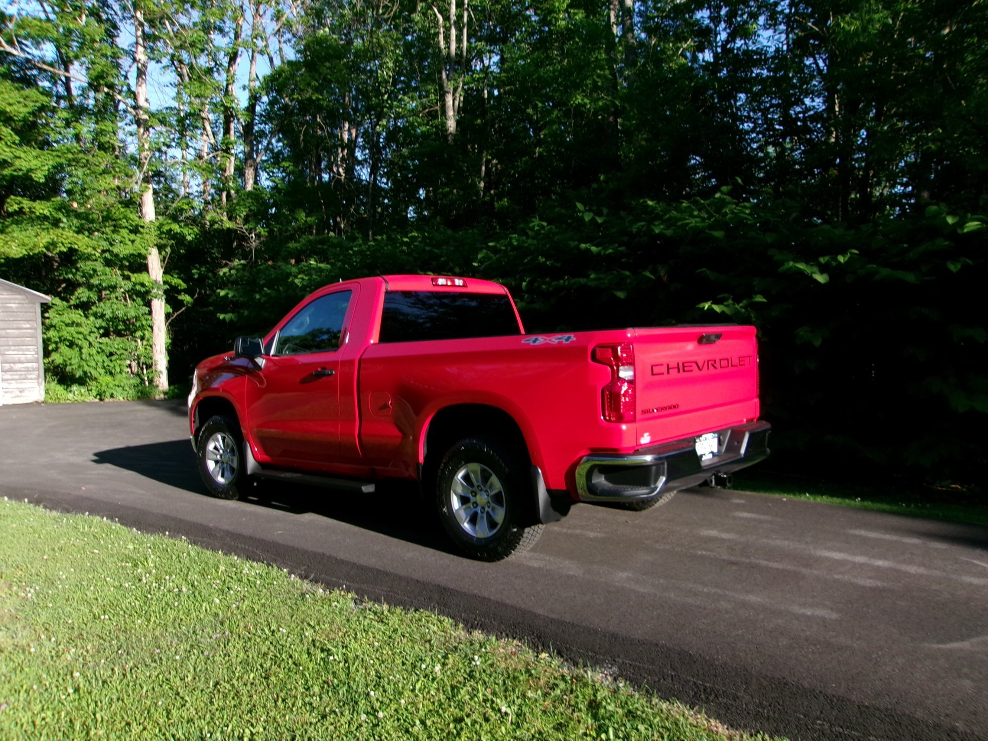

  3. Your truck lowered, looks good. I'm happy with the stance on this. I may need the extra ground clearance given my location/situation.
  4. Nice. So, the front is a 2" spindle drop and the rear is a 4" drop?

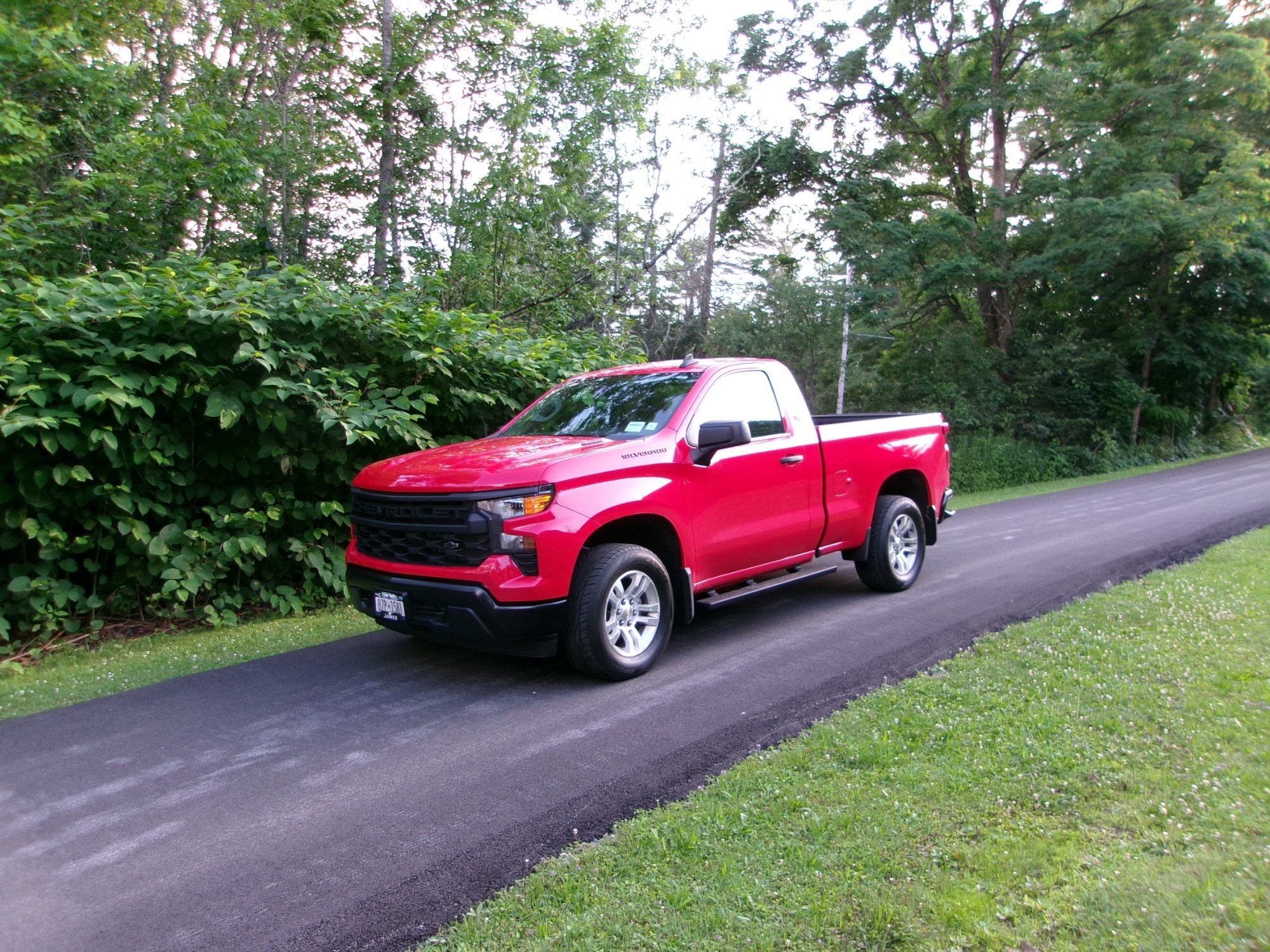

  6. I like the rake. It's more of a sport build for me. I like the 285 wide directional Toyo's on the 2014 wheels. My TPMS sensors showed up yesterday, but delivered to my neighbor due to some fat fingering on my part. Fortunately he was around yesterday afternoon, and indeed had recieved my new sensors. Appointment made for Saturday to have them installed. Cosmetically, I've pulled the dealer sticker off of the lower left tailgate, and pulled the license plate frames. Seriously considering pulling the rear fender 4x4 decals. The other thing I've thought about doing is replacing the Dark Esentials black front grill bowtie with the base gold one to add a little color/contrast to the front. The gold front emblem, from one of many build and price jpgs I saved and mulled over.
  7. Got a call today scheduling the bumbers for next week. Can't wait. That's the last major change, stuff they owed me, scheduled for next week. I'm not sure what I'm looking at. Looks like a draft from last week. Bumpers were installed today by the dealer. I'm very happy with the results. A couple before afters ... or not. looks like I can only get 2 into a single post.

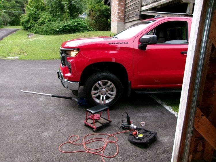

  11. Huh. That's a really interesting comment. I ran into a guy at home depot that pulled in with a Silverado with the same wheels I was looking to put on the new truck. It was a newer truck, so I asked what year it was. Late teens IIRC. But he said he put spacers on the front to try and correct that. I don't think I've ever read that, or noticed it on any of my Silverados. The spacers were not cheap. not putting them on the back would have saved some money. To me it was, if I'm going to move the front wheels out a little, I need to do the same for the back. The idea is to be a little more sporty with the 18" 285 Toyo directionals. I'm learning to deal with several downgrades compared to my '14 LT. No steering wheel stereo volume control (sucks), no uplevel DIC. (sucks even more). It runs well, but sounds like crap.
  12. I appreciate your response as well as everyone elses. It's all stuff/info/opinions to consider. It's why I asked. The spacers are .375, the reach of the extendend lugs is only .33". Even if they were to bottom out with just the wheels, they're not going to bottom with the gen 2 BORA spacers. Spacer size wasn't a guess for me either. As I posted, the one front wheel I tested, spun freely with a less than 1/4" worth of washers. I went with the BORA .375" and ET lugs because I thought it was more important to have hubcentric spacers. Based on my research, that started at .375 for any vendors I found. Time will tell. I really want put the backs on, but it's also really hot outside. Air conditioning is a wonderful thing.
  13. The BORA 3/8" spacers arrived yesterday along with the extended lug nuts. I got the front wheels changed out today, but was overheated and covered in sweat so bad, I figured getting both front wheels done was a win, and took a cool shower. Hopefully, I'll go out tomorrow morning before it gets into the 80+ temps and do the backs. After getting the first wheel snugged up, I backed out one of the lug nuts then hand turned to count threads. I believe I stopped counting around 12-13, so I think I'm good there.
