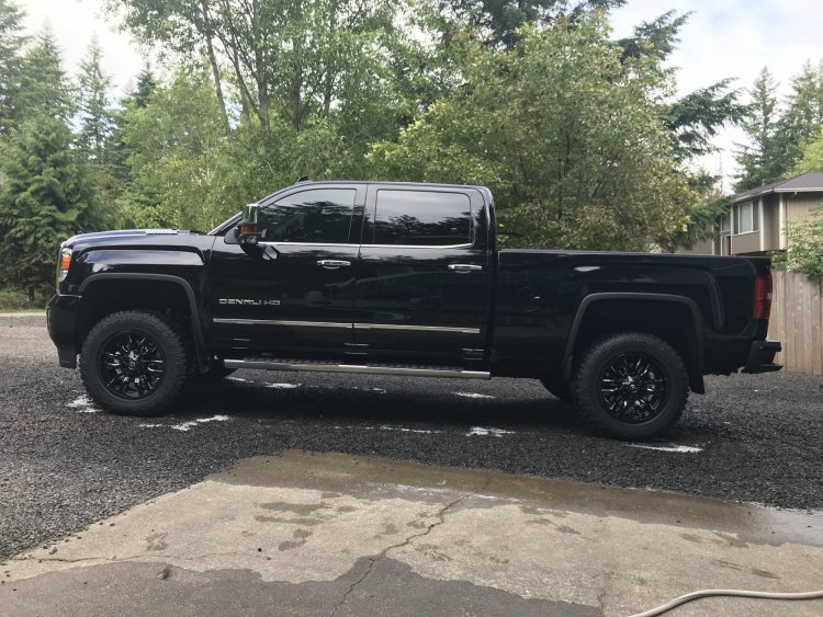

  1. Yes I have, a little low speed growl, but nothing excessive. Very similar to the Goodyear Duratracs. I like the aggressive look of the tire and I get a lot of compliments on them.

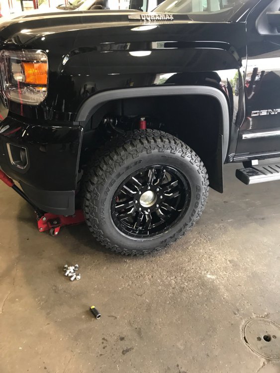

  2. 1 7/8" lift in front and flat OEM splash guards, 20x9 +20MM wheels, 275/65/20 Goodyear Ultraterrains. Had to slightly modify front splash guards becauase barely rubbed at full lock.
  3. looks great, amazing how much tire you can fit if you keep the stock wheels. Update on my truck; 19 Denali 2500HD, put 2" leveling kit on and brought it up 1 7/8" (drivers side maxed out). Front measurement is 42 1/8" and rear is 43 3/4". I am happy with how it sits, the upper control arms are not touching metal stops and I didn't use shock extensions either. Also the ride is exactly the same and my steering wheel hasnt moved, so not sure if i need an alignment. I ordered MHT Sledge's 20x9 +20mm and hoped to fit LT285/65/20 Goodyear ultraterrains from Discount Tire. Today they did a test fit and it barely touched the inside of front fender liner and rubbed the factory mudguards, I have the factory flat/flexible guards. I probably could of done some trimming to make it work, but I am gonna try the 275/65/20's in the same tire. That 285 was taller than a 35 when side by side, weird.... I saw 2 more trucks like mine this weekend, both T bars cranked and UCA sitting on metal stops and one had 305/55/20 and other was 35-12.50.20 with trimming. I just dont want to mess with the ride quality and have it sitting on metal stops.
  4. Its getting installed next week, they had to order everything. I had the KO2's previously, but didn't like because they picked up EVERY rock and they took a lot of weight to balance. I also ran the Goodyear duratracs and liked except they are a little noises, so i figured i would try this new Ultraterrain. I will post pics when its done next week.
  5. Very Helpful topic and lots of great pics and input. This really helped me to pin point what set up to order, thanks! 19 Denali 2500HD Duramax, 2" level, 20x9 +20mm, 285/65/20 Goodyear ultraterrains from Discount tire and factory mud flaps.
