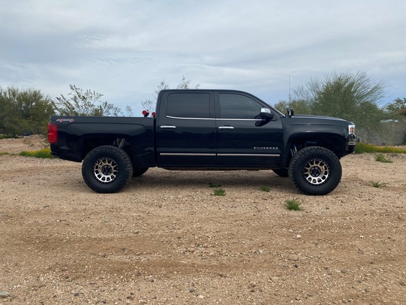

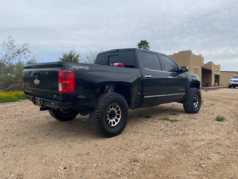

  2. Removed the Camburg Mid-travel kit up front (also deleted 4WD) and went with a long travel kit from Dirt King; strapped at 18.5 inches of travel. Just got my +6 front and rear fenders back from paint and 37's will be installed this weekend. I'll post better photos soon, here's a teaser!

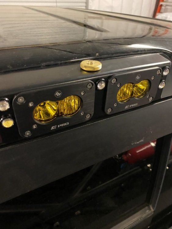

  3. Metal, the only non-metal 3rd brake light I know of is from IzzyFab, his is from carbon composites.
  4. Yeah I went 3.0s in the rear. I will be keeping the 2.5/3.0 shock package for my new front set up, longer shock length. Shock tuning, valving etc is not my expertise so I'll have it professionally tuned.
  5. I'm assuming you have a K2 truck, I have the Evil Manufacturing 3rd brake light but if you need more rear light output, GJ Motorsports also makes a 3rd brake light that will fit 3 BD S2's. PS - Du Ma May

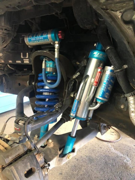

  6. I'll be deleting 4WD and upgrading to the Dirt King Race Kit in a few months and would like to secure a serious buyer for my current Camburg Long Travel Suspension set up. The $7,300 price includes: King 2.5 Coilovers w/ adjustable resi (just rebuild by SDHQ in Gilbert, AZ) King 3.0 Triple Bypasses - Valved specifically for this kit. Camburg Long Travel Kit (UCA/LCA) + Hardware (Brake lines, extended tie rods, 4WD Axles, etc..) I will have all new brake lines and uniballs (let me know your taper size). 4130 heat treated chromoly have had no usage since I've installed this kit. This will essentially be a new kit, this kit retails for $9100+tax. This kit is for both 2WD/4WD and for the 07-18 Silverado/Sierra's. For $7,500 I'll throw in my front +3 FiberWerx fenders that have been painted black and have bed liner on the inner skin for extra strength. This is a complete bolt on kit that will allow you to eat 99% of open terrain at high speed. Located in AZ, I am in SoCal every other month so I can deliver. For all other states, I can provide estimated shipping costs. **Front and side shots of the truck have been provided for better details of width of the kit and fenders.

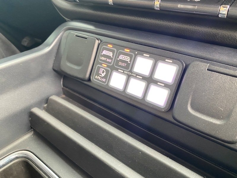

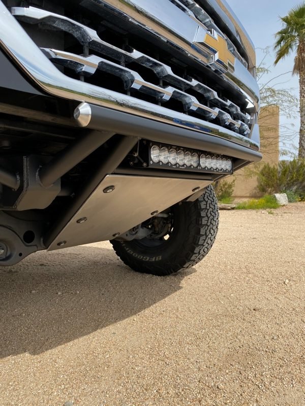

  10. Added the following: 454 Motorsports Custom Aluminum Skid Plate Bumper 454 Motorsports Custom Valences Baja Design Onx6+ 20in Wide Driving Light Bar in the skid plate Dirt King rear bumper 454 Motorsports custom hitch Trimmed the rear bedsides Relocated washer fluid tank Added in switch pros + rugged radio 3rd brake light w/ 2 Baja Design S2's + antenna mount
  11. Added the following: Custom Aluminum Skid Plate Bumper Custom Valences Baja Design Onx6+ 20in Wide Driving Light Bar in the skid plate Dirt King rear bumper 454 Motorsports custom hitch Trim the rear bedsides Relocated washer fluid tank Added in switch pros + rugged radio 3rd brake light w/ 2 Baja Design S2's + antenna mount
