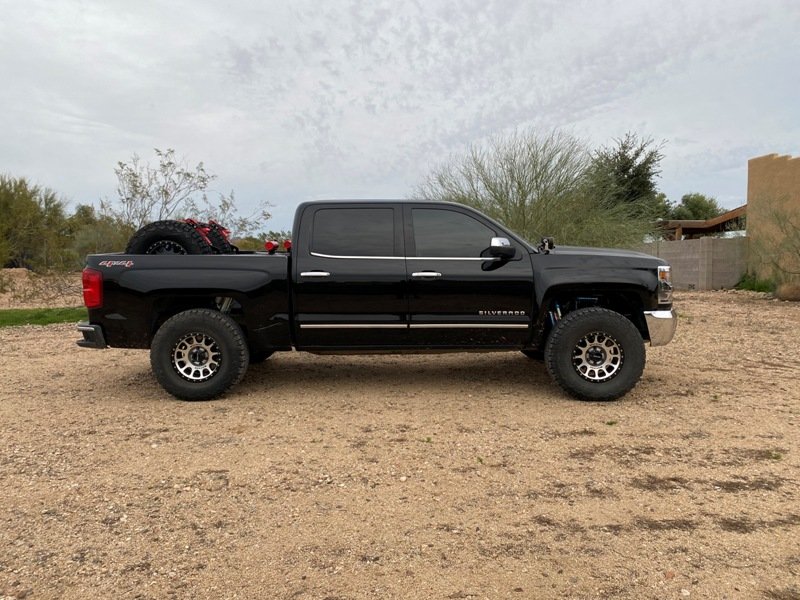

AZ_RADO_RNR replied to AZ_RADO_RNR's topic in Member Build Threads
Removed the Camburg Mid-travel kit up front (also deleted 4WD) and went with a long travel kit from Dirt King; strapped at 18.5 inches of travel. Just got my +6 front and rear fenders back from paint and 37's will be installed this weekend. I'll post better photos soon, here's a teaser!- 42 replies

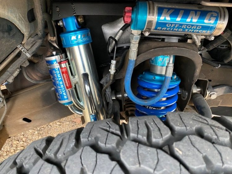

What have you done to your K2 today?
AZ_RADO_RNR replied to block8head's topic in Modifications & Accessories
I'm running the Camburg kit. It's night and day difference regarding off-road performance with the additional bypass. The people who are happy with just a 2.5/3.0 King/Fox coilover even at custom mid-travel spec just don't drive their vehicle hard enough. Without the bypasses I was constantly bottoming out the front, next step is to work with a shock tuner to get both the rear/front 3.0 triple bypasses properly tuned. Once everything is tuned, I'm going to use this current set up to improve my off-road driving skills. In 1.5 / 2 years or so I will do a 4WD delete and run a race kit in the front (might do j-arm set up but need to see if the additional 3 inches is worth it from your typical 17/18in travel from race kits) and link the rear (not sure if I wanna do short course or traditional) and cage the truck. I'm still undecided on engine modifications, I see dudes with 600HP+ blown L86s who are not using all that power off road and that kind of power would for sure get me in trouble lol. I regularly post stories of me on Instagram sending/pushing the truck pretty hard -- shoot me a DM for the handle if your interested in that kind of content. -

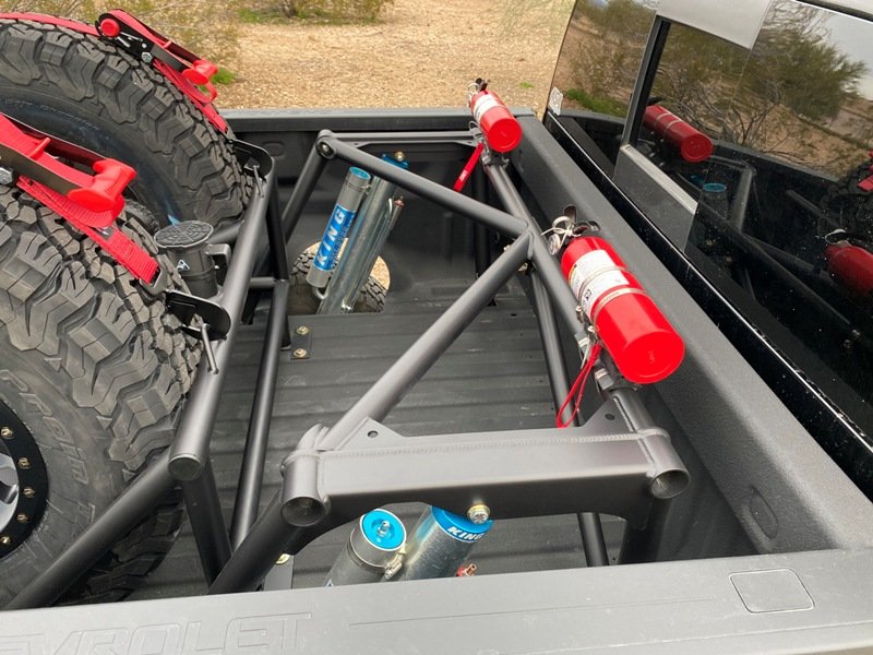

2016 Silverado LTZ - Mid Travel to Prerunner Build
Added 3.0 king bypasses up front, removable tire cage w/ jack mount, quick release fire extinguishers.- 42 replies

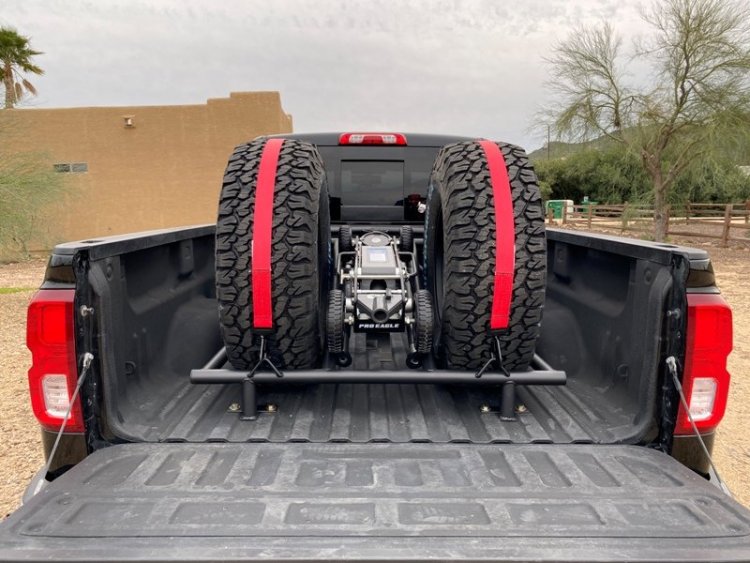

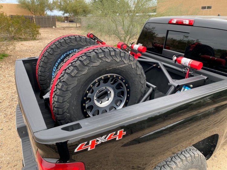

Added king 3.0 bypass shocks up front, removable tire cage w/ jack mounts and added quick release fire extinguishers to the bed cage. Brb while I go bully some Raptors. -

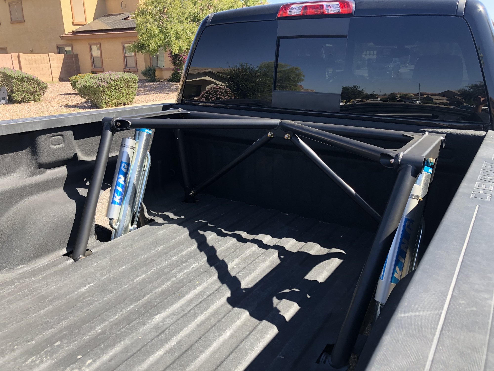

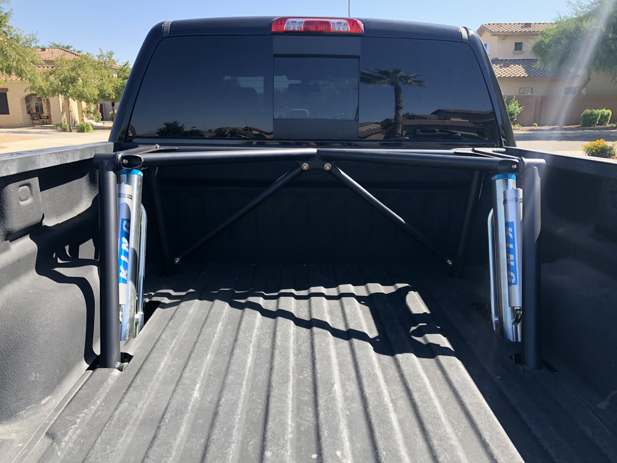

DirtKing Bed Cage w/ King 3.0x16 triple bypasses has been installed. Shook down the truck with 70MPH runs over the weekend and now the front suspension can’t keep up, looks like my next mod will be adding 3.0 bypasses in the front.- 42 replies
