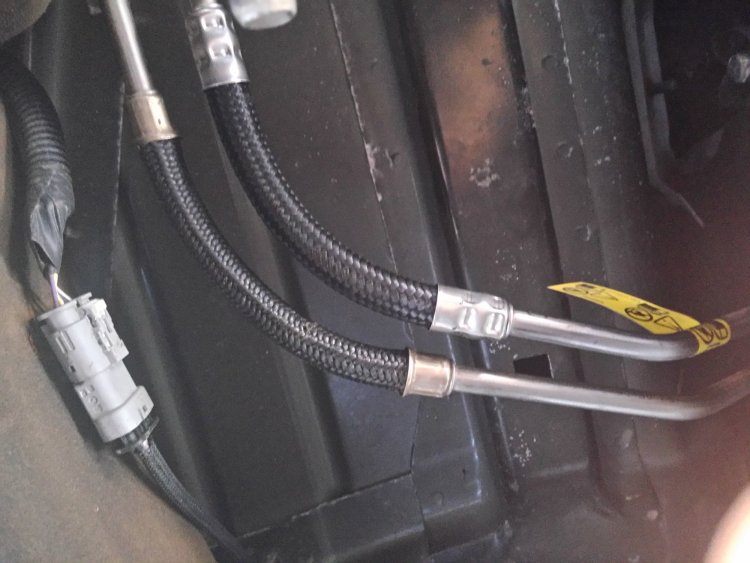

Well today I decided to finish my install of the OEM pipe, I do not have a lift so I decided to use the back and used Russell stainless steep crimps to crimp the hose to the front pipe. A lot less work. So my conversion is 100% done now. I'm enjoying the enhanced performance and drivability! -

I've been playing with tuning the ECM and Trans with the E85 running about 72% Alcohol. Learning tons on tuning Gen V DI on E85. The truck is very fun to drive. I have a regular cab so it is the lighter of the Silverado's only the 2wd would be slightly lighter. It is actually fun to drive now and feels so much more responsive now. Its been cold her near Chicago so I'm currently tuning it for better cold starts. I bought the line and looked at what it was going to take to install it and decided against it, I think I'm going to splice the lines at the nylon bend. It will still look like a factory install picked up Russel Stainless Steel Ferrules and hydraulic crimper. I wish Hypertech and Diablo, etc would work on E85 specific tunes for their products, being able to add 40+ hp for a coupe hundred bucks it a great deal. -

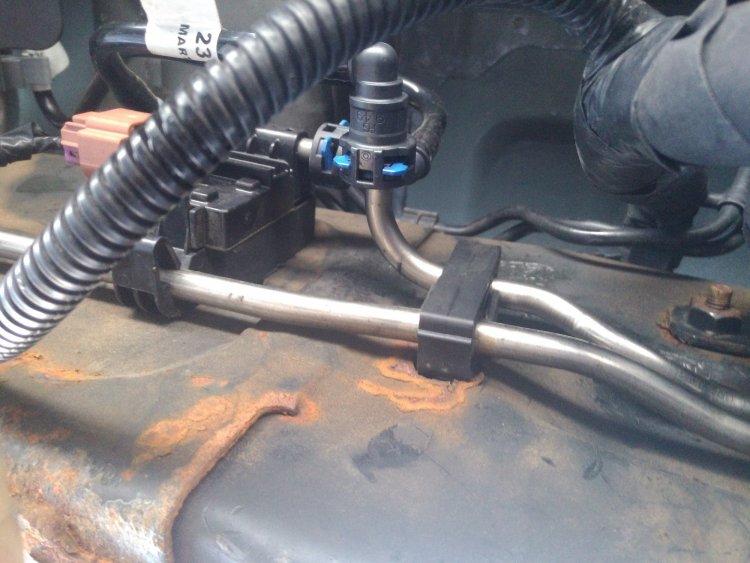

Just took for a drive and looked for leaks, no leaks. Programed the ECM and t saw the alcohol content at 11.8% which is about right since I use E15 usually. Well I have to wait for my tank to go down so I can fill up with E85. Here is a picture of the fitting I used, I repurposed the quick connect fitting from the old line I cut. -

Just finished installing it and testing for leaks so far so good. I will program the ECM now to see the Sensor. I would have preferred to bent and flared the existing line but in the space it was impossible. I did put loktite on the stainless elbow threads so it doesn't vibrate loose. -

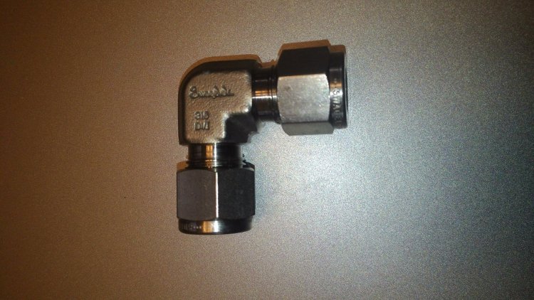

SCR71822 replied to SCR71822's topic in Modifications & Accessories
Well I wanted to reuse the current front engine fuel line, but there is no easy way to bend a 90 degree bend and then out a push connect flare on it. So, I've decided to cut and use a singe Stainless 90 degree compression elbow in front of the sensor. It should be here next week.
