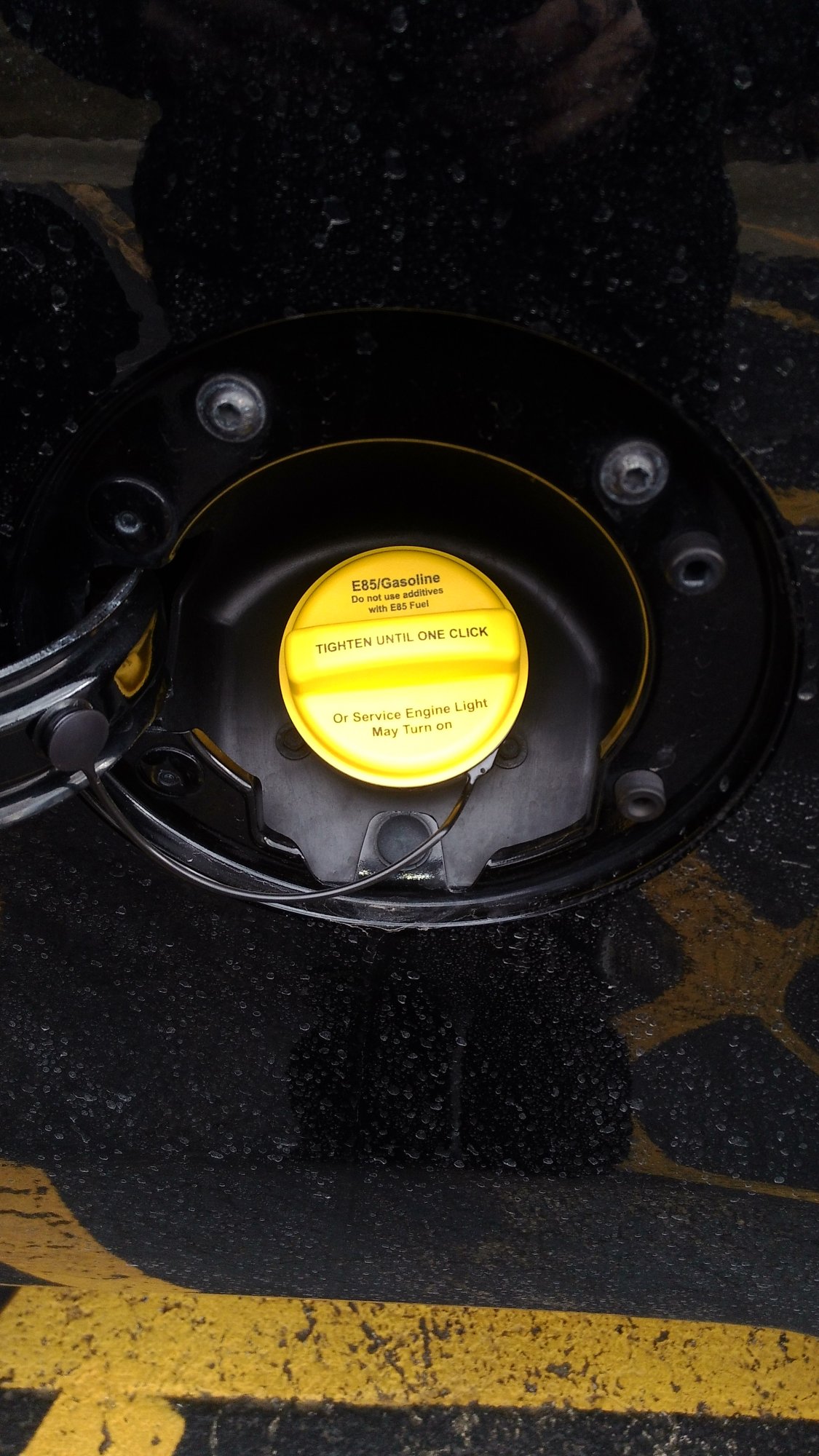

  5. Just installed the e85 Filler hose and the Yellow Gas cap. Waiting for my Quick Connect flaring tool and I will install the sensor.

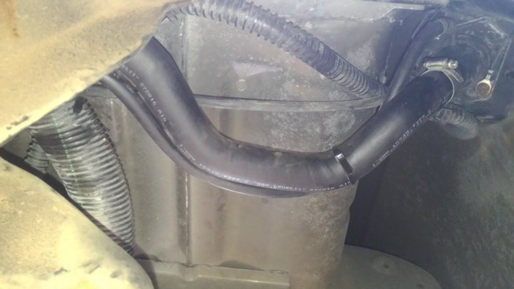

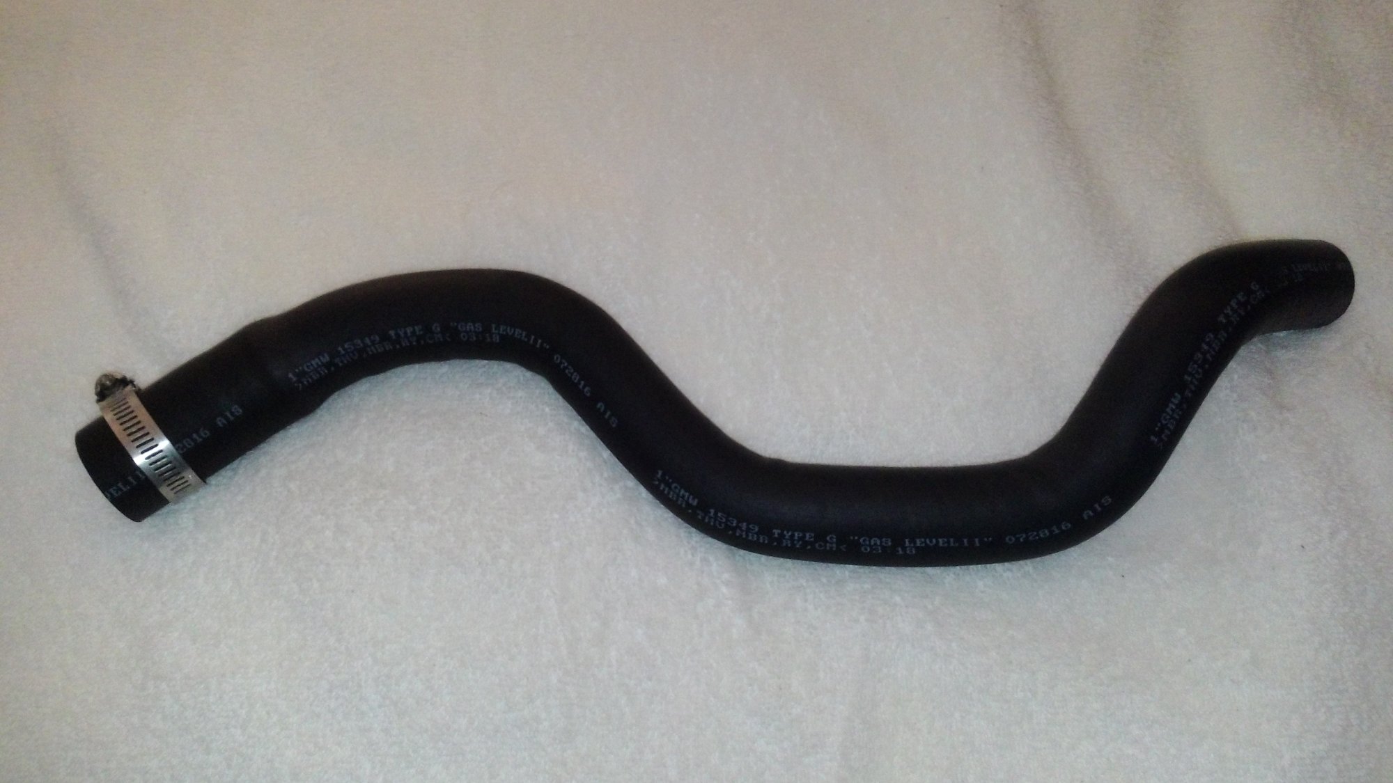

  6. Here is the e85 Gas Tank Filler Hose, marked with E85 on it, has a plastic baffle in the hose too.

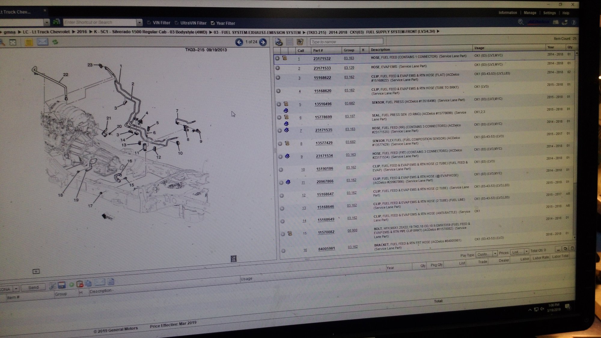

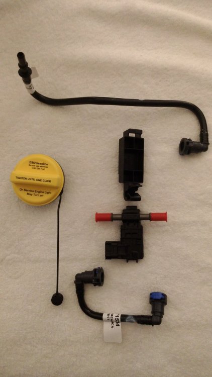

  7. I have the HP Tuner to enable the Flex Fuel option in the ECM. I also have the Hypertech Max Energy Programmer I might try, at least to pull the settings to get a good performance baseline. My truck is at the three year mark, has about 31,000 miles, and I need it to be a reliable daily driver, figure now is the time to play with it.
  8. I have read every e85 Silverado conversion before I have done mine. I have noted that the Gas Tank filler hose is e85 or e10 specific (at least for the Regular Cab), I hope that guys that have done the mod have taken that into consideration, hate to see the filler hose break down over time and cause a problem.
