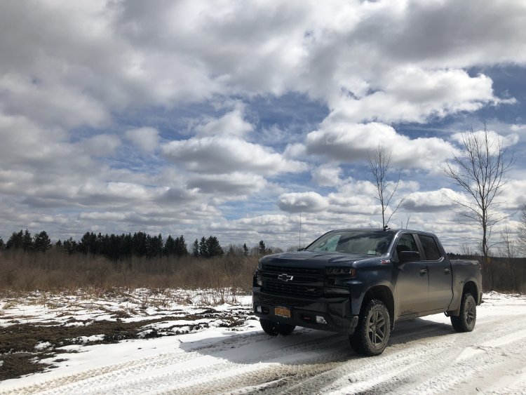

Anyone have issues with the trailrunners in the snow? Coming off our first snowfall in Western NY and I am extremely disappointed in the performance of the trailrunners in the snow. No grip from these tires and the truck slides around like crazy. These are the stock 275/60/20s on the GMC Elevation. I had a '19 trail boss with duratracs and traded it in for a '20 elevation with the trailrunners and it feels like I went from a tank to a prius. Others experiencing similar performance issues with the trailrunners? I like the gas mileage and noise levels of the Elevation as compared to the trail boss but would consider going back with how this thing slides around in the snow. Interested in what others have experienced.
