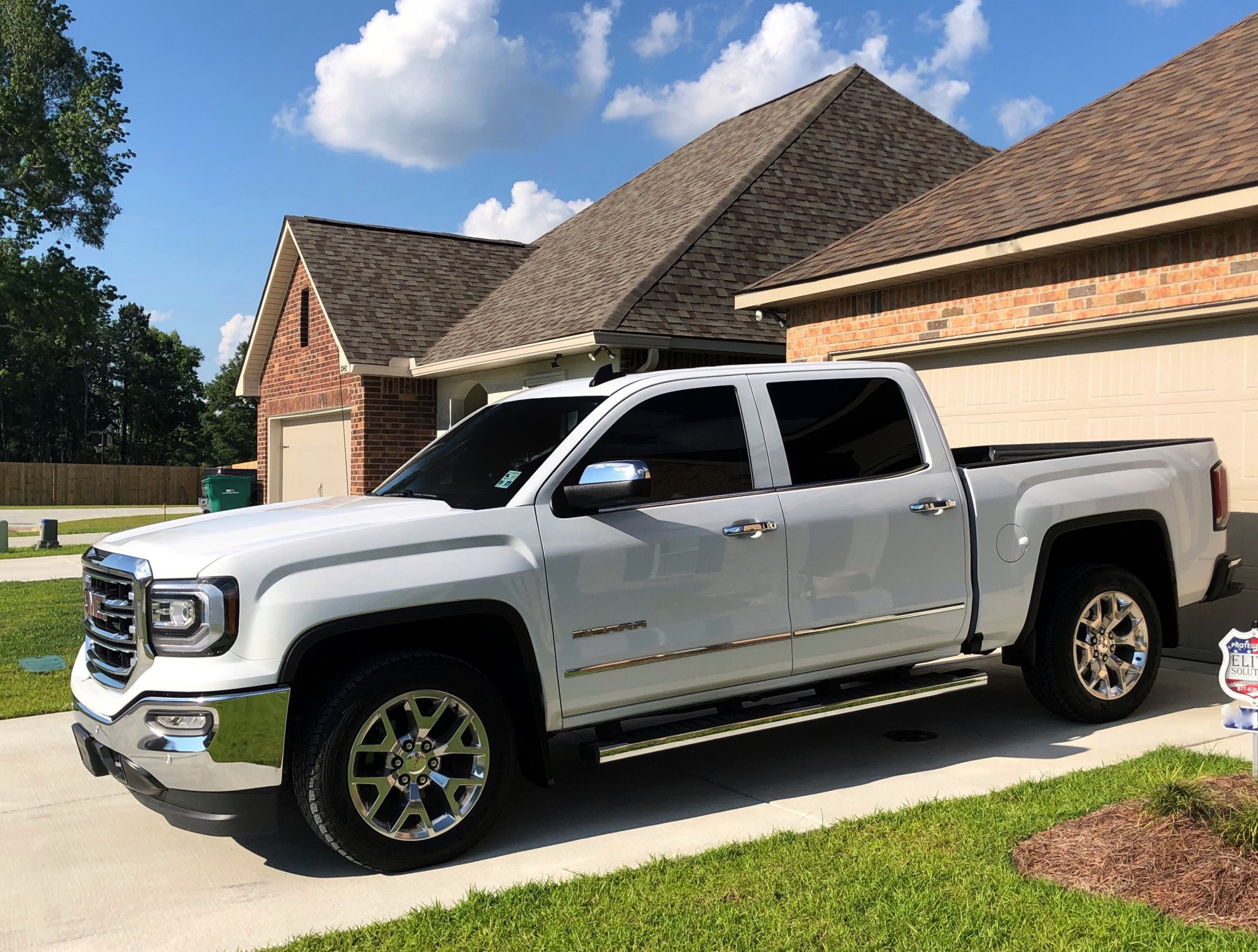

  15. Do you know the offset of those rims? Are those stock rims? I am thinking about doing 2” level with those exact tires but worried they will rub with the stock rims.
  16. "New to me" 2017 SLT Premium Plus Package. Plan to replace chrome mirror caps and handles with color matched ones. Also plan to do a 2" level and put some 275/60s on the stock rims...for now.
