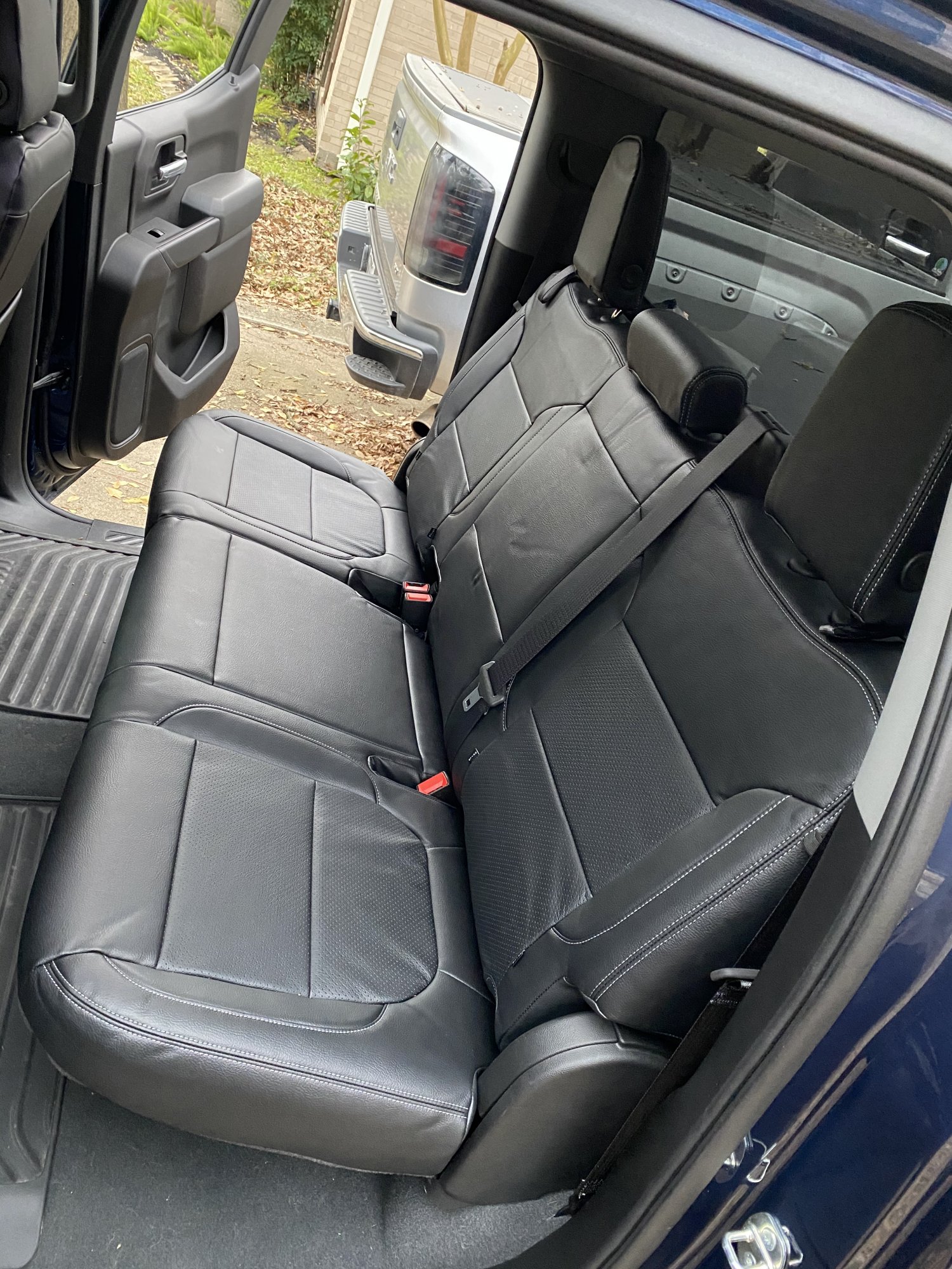

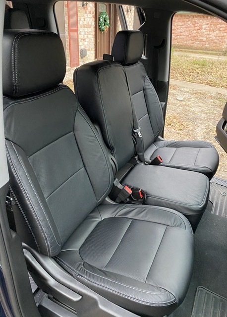

  4. Finally had some down tine to complete the install. They came out pretty awesome, and learned a few things along the way!
