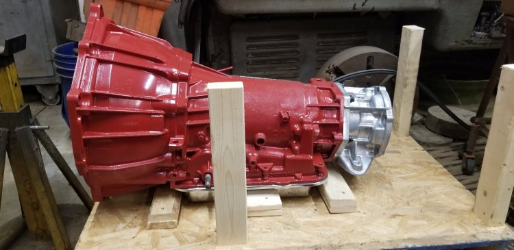

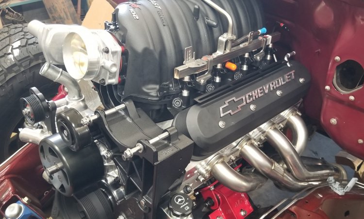

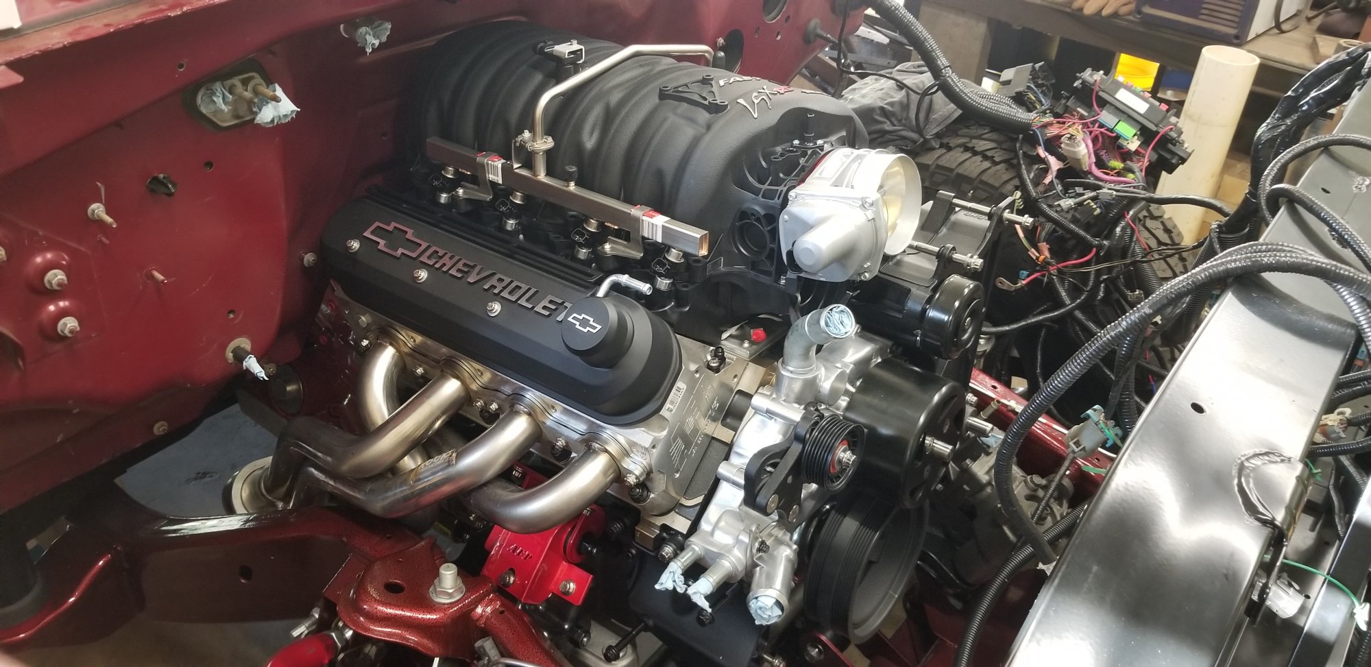

  1. Intake check.. headers check.. gonna bolt up the new ac compressor today and then work on routing the harness. I didn't completely torque down the intake because i wanna make sure the steam port kit ive ordered is gonna bolt up before i do. Any more suggestions are welcomed. im not a professional and if anyone sees anything i could do better please let me know!

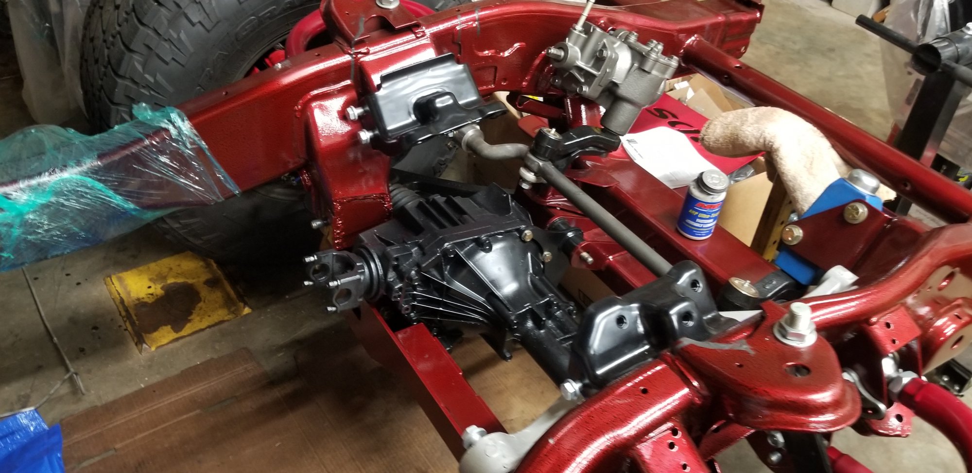

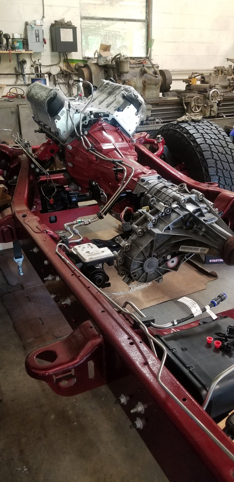

  2. Engine, trans, and transfer bolted in.. what else do i need to install before setting the cab back on the frame.

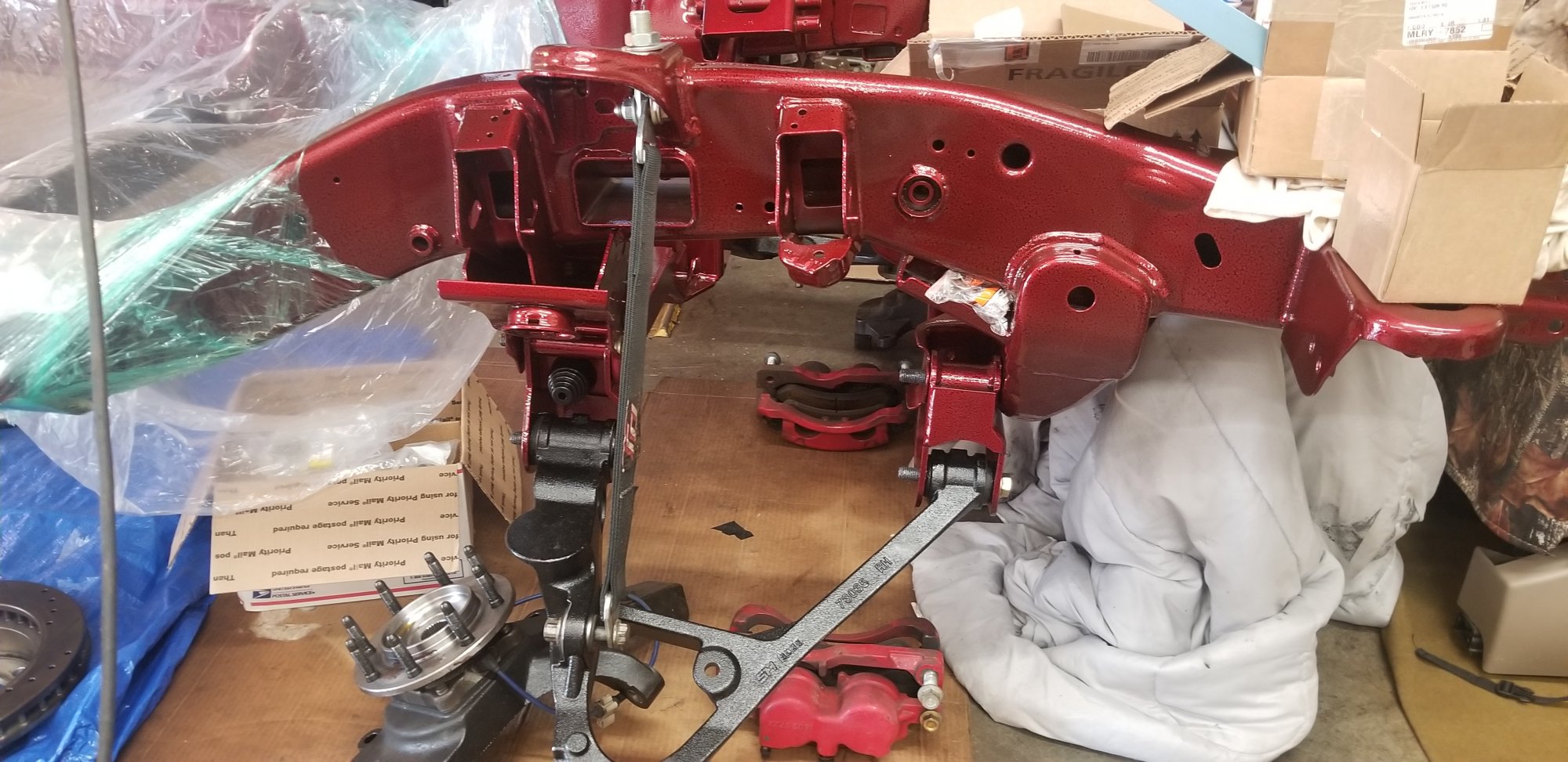

  3. Got the front and rear suspension bolted up. Its time to set the new engine and tranny on the frame and get brake and fuel lines squared away.

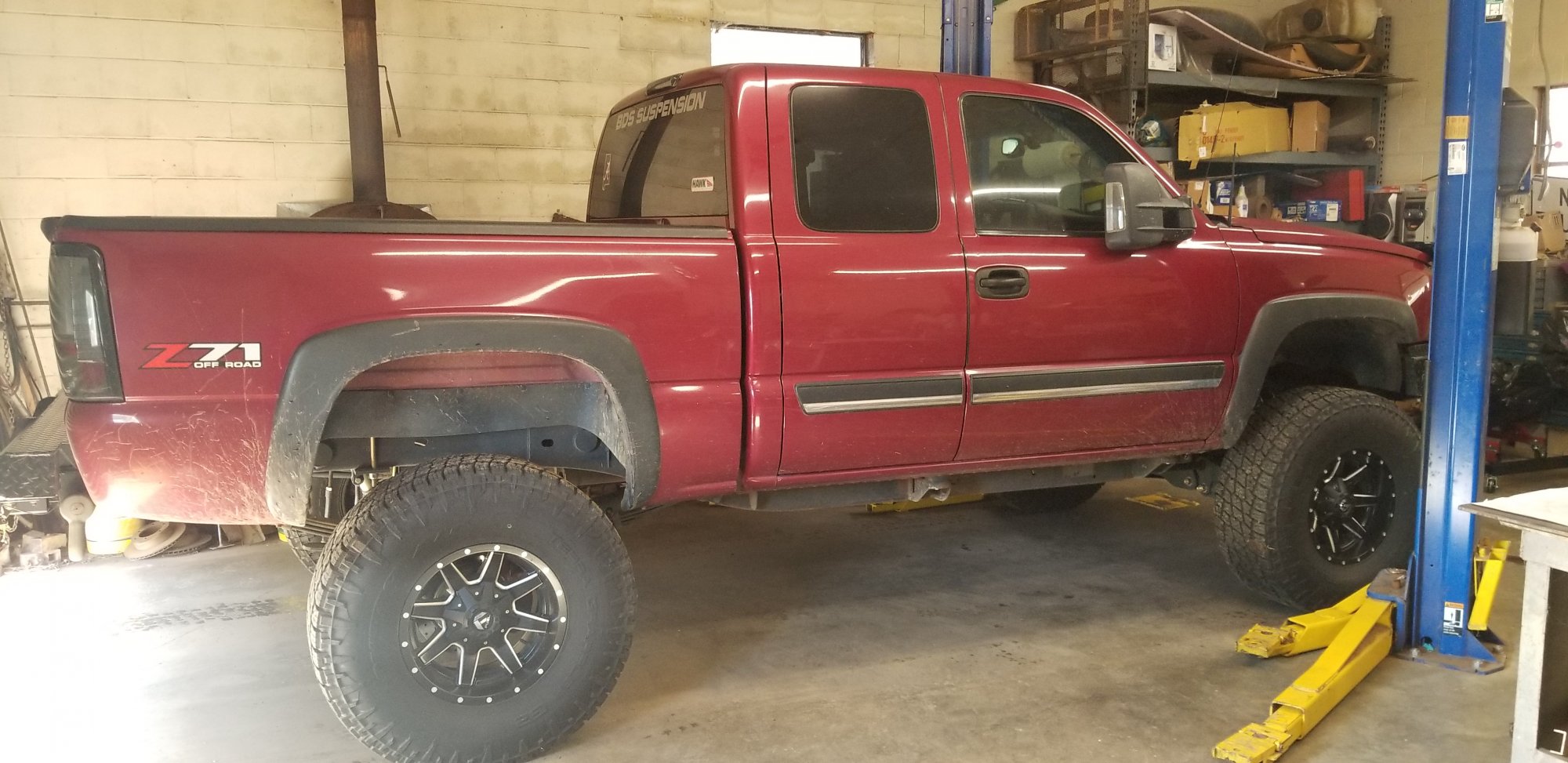

  4. Here is 2 more pics taken about a year ago when i pulled it in the shop. I had originally just planned on swapping the motor and transmission...

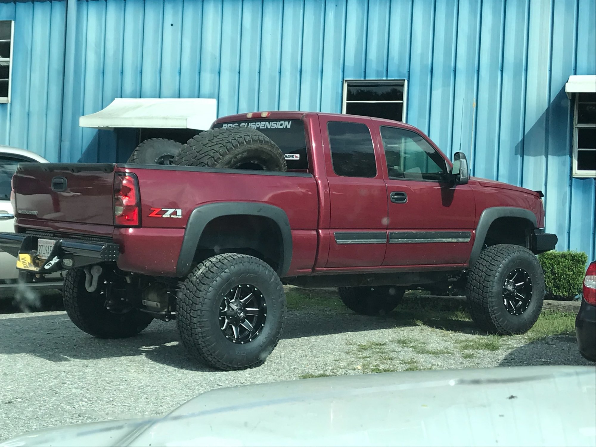

  5. I know folks like photos! Heres some pics of my truck before the lm7 went out and before i started down this road.

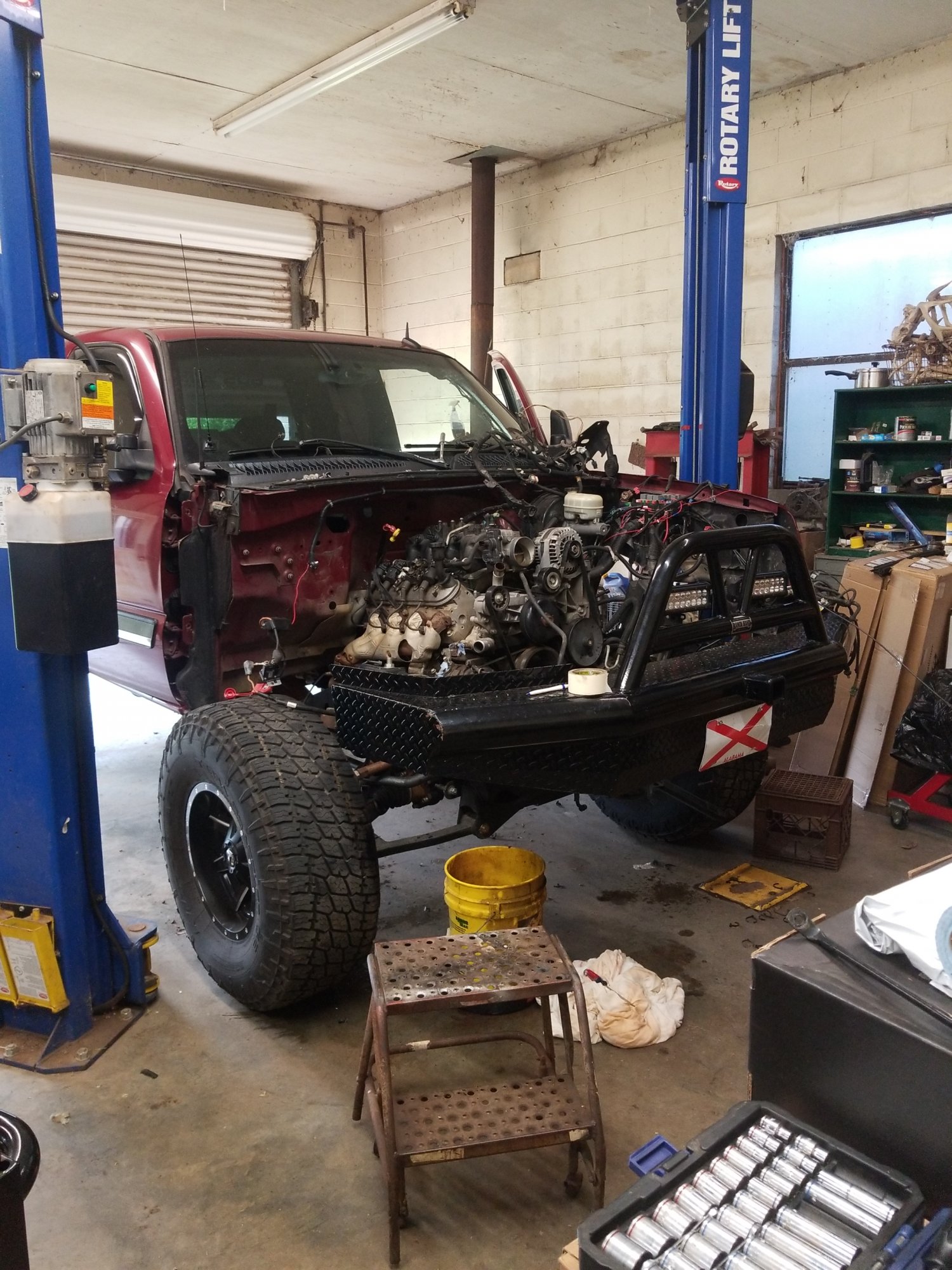

  6. Just picked up my uca's! They are custom fabricated so i can use a lifted knuckle that accommodates the 8lug hubs. Gonna get the running gear on so i can roll the frame this weekend. Fingers crossed.
  7. Alright yall.. i need some motivation. Ive got alot of cash and time invested in my truck build and all it really needs is some time and a couple of odds and ends. It a 2006 Silverado z71 and its one of those ones that has the shorter crew cab beds. I talked myself into coating the bottom of the cab today and juat thought i might could get a little more motivation to get the truck done quicker. Ive had the frame soda blasted and now is powdercoated. Ive got all new parts down to every bolt just about. I got new ss brake, fuel, and transmission lines. New 408 stroker with afr 230cc heads and a lsxrt intake. Kooks ss header and y pipe. Tci torque converter and flexplate. Completely new hd transmission with billet shaft and upgraded planetary and has the ratio upgrade. I also converted the truck to 8 lug before i even decided to do a frame off rebuild so it has a 14 bolt rear with 4:11s. Let me know what ya think!
