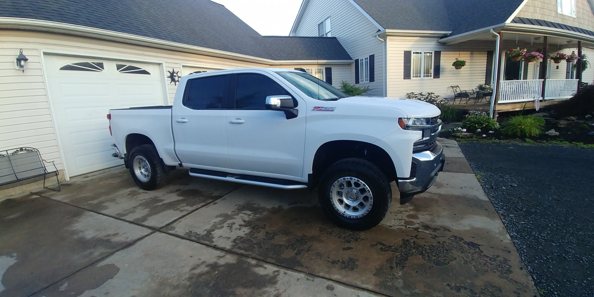

  1. The truck sets level, I replaced the Fabtech 1.5" Block with a 2.5" Block to make it level, I was going to go with a 3" block but the U-bolts from Fabtech were only long enough to go to the 2.5" block for now . I'm going to have the rear leafs re-arched or add-a-leaf. If I add-a-leaf I'll go back the the 1.5" block and gain it that way, just another $300 to $400 I don't want to spend yet.
  2. Wheels are XD132 RG2, 18x9 Running boards are Steelcraft STX300 They tuck up nice and direct bolt to factory nuts. One clip used went into a factory hole, great setup.
  3. Got my 2019 LT and had to get more clearance. 3.5" Fabtech with new Dirt Logic Coil Overs, added 1" lift with 1/2" spacers between Coil Over and lower control arm. I measure 4" lift. Dick Cepek 33x11.5x18. Wheels are XD132 RG2, 18x9 Running boards are Steelcraft STX300. They tuck up nice and direct bolt to factory nuts. One clip used went into a factory hole, great setup.
