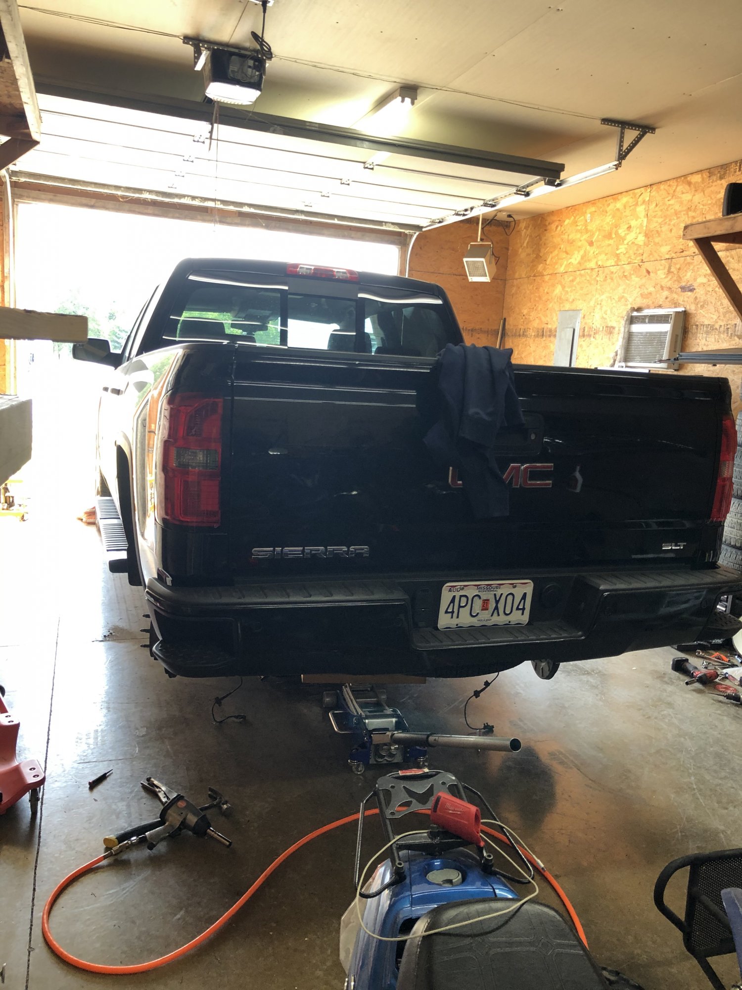

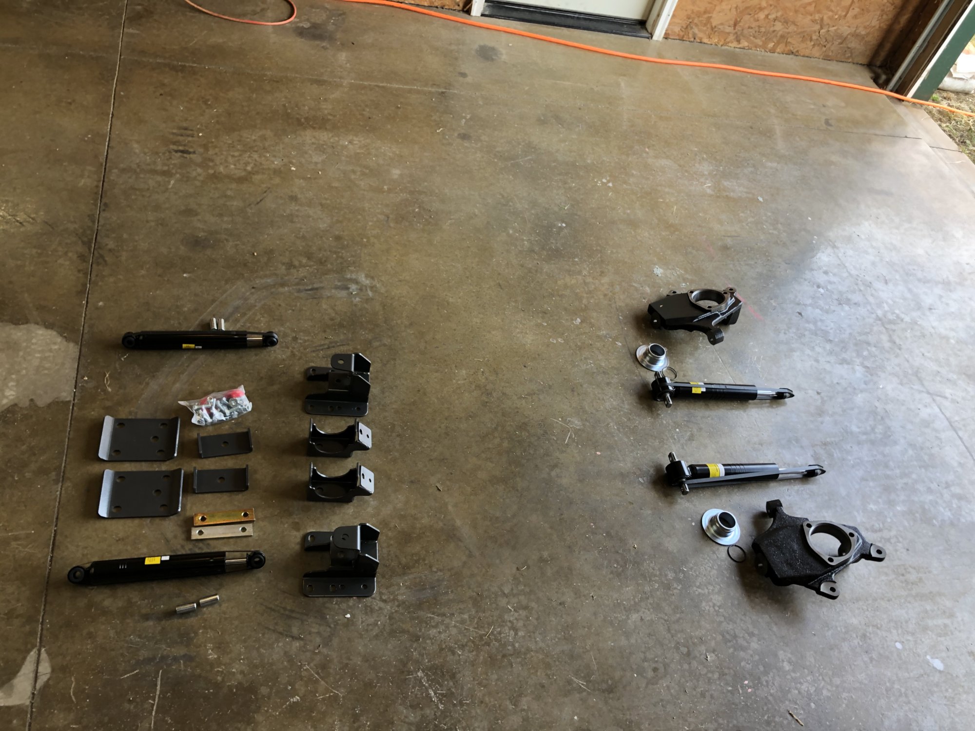

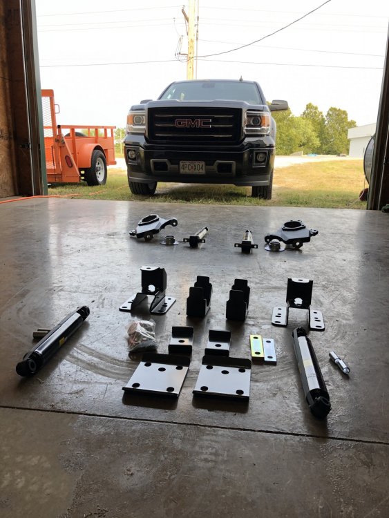

  5. 2015 CCSB SLT Z71 6.2L MaxTrac Adjustable Drop Kit - K34170 from suspensionsuperstore.com 2" Spindles, Adjustable strut, Flip kit, Hanger, Rear shocks Sits perfectly for me at the 2" drop strut setting with the 2" drop spindles and rear set at 5" holes on the hangers. Did it all myself -- it can definitely be done without help but need a few beers. Rides a little rough for my taste, not much worse than stock. Will be upgrading to Viking coilovers in the front and helper bags in the rear - possibly a 4-link and coilovers for the rear in the future. Also would like to put TMW control arms on it. Can't decide if I want to do more power adders or dial in the suspension first....
  6. I’m still going to have to install helper bags for when I haul or tow stuff. It rubs in the back wheel wells over big bumps if I don’t see it in time to slow down. Haven’t installed the bump stops yet. Front rubs worse on bumps and at full lock going forward and about half lock in reverse. Running 285/45/22 on replica wheels.
  7. It’s part number K34170 at suspensionsuperstore.com 2” Spindles and adjustable struts set at 2” - so should be 4” in the front. Flip kit/hanger/shocks in the rear, hanger set at the 5” hole. Should be 4/5 but I haven’t measured since everything settled in. Had the strut set at 1” to start and it didn’t look right so pulled it back out and set it to 2”.

  9. I went ahead and lowered it. Went with 4/5... 4” in the front and 5” in the rear, so I keep a bit of a rake. I prefer to have the rear just a bit higher than the front, and I think this gave me about a 1” difference. Removed the steps - cleaning them up and they will be for sale! Also went with the Borla multicores.. sounds amazing. It should —— $600 for mufflers..
