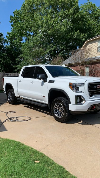

  1. 19 AT4 2inch level with 1552 turbo max HD 20x9 -12 275/60/20 ridge grapplers

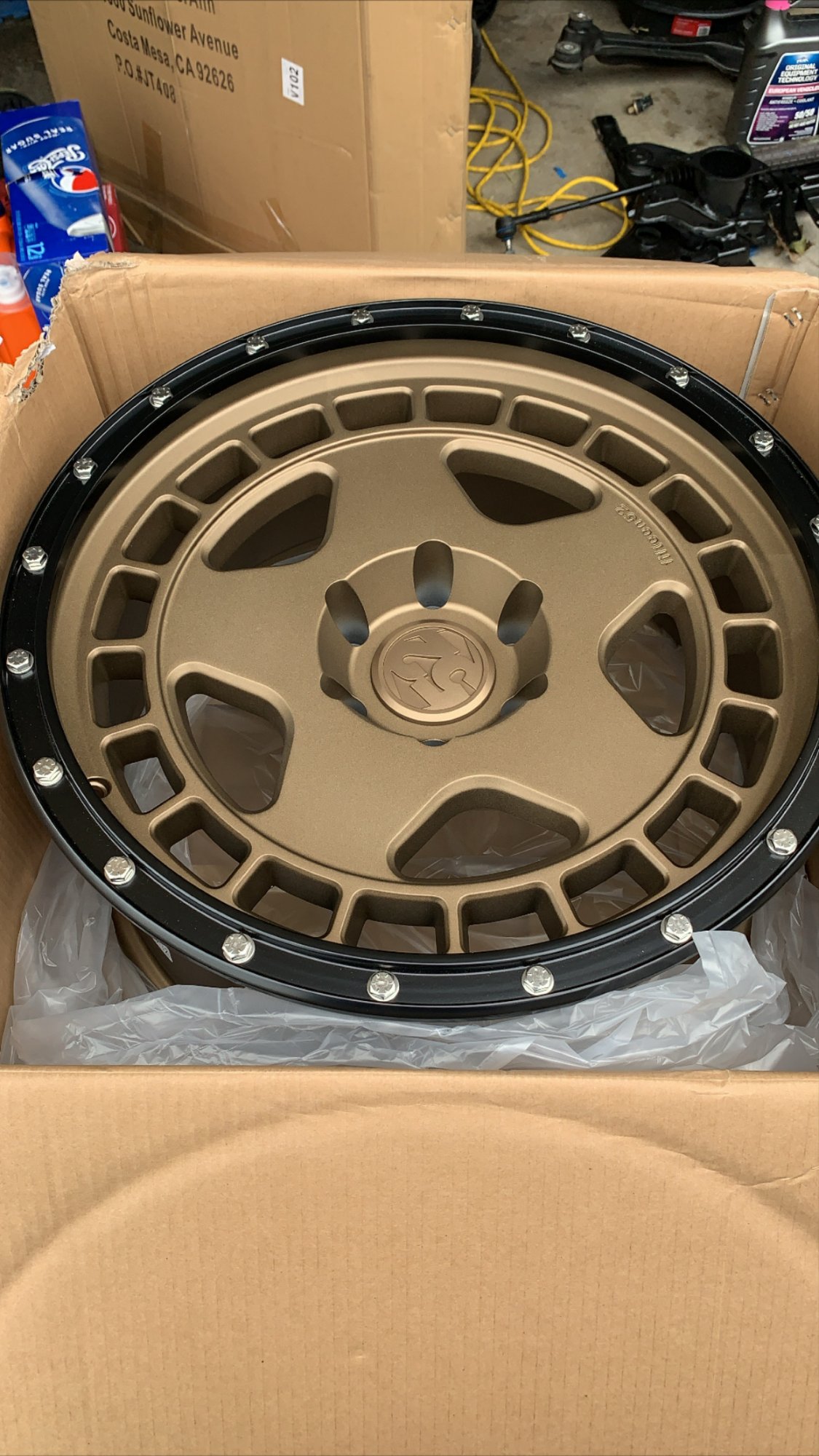

  4. Here is mine 19 at4 2 inch RC level tinted windows JL AUDIO stealthbox and HD750/1 amp and lc2i. Not installed I have a set of 1552 turbo Mac HD wheels in 20x9 -12 gonna do 295/60/20 ridge grapplers

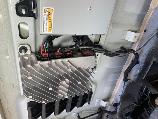

  6. I finally took a day and fixed my issue the installer I paid to wire it used the signal from the rear door speakers for the woofers and it sounded like complete garbage so took the center console out and removed the factory woofer and used that signal And now it sounds amazing. I was contemplating selling all of it and starting over but now am totally happy. I’m gonna upgrade the dash and door speakers next.

  8. I’m not having that problem. I think the lc2i is wired wrong looks like he took signal from the rear door speakers and not the factory subwoofer so the signal going to the subs is full range they are playing music and not just bad like they should. I need to access the oem sub wiring and try to rewire the loc. If wired from oem sub should only be one set of inputs?
  9. What problems did you have with the hd750/1 I’m having issues with mine in my at4. I’m to the point of selling my complete JL stealthbox and amp and starting over. I have a stealthbox and hd750/1 and LC2i everything else is oem. The signal to the stealthbox is terrible would adding a DSP fix this or a different loc? I paid a Best Buy installer off the clock to install everything works as it should but sounds terrible for the money I paid for amp and enclosure should sound great. Any help would be awesome thanks.
