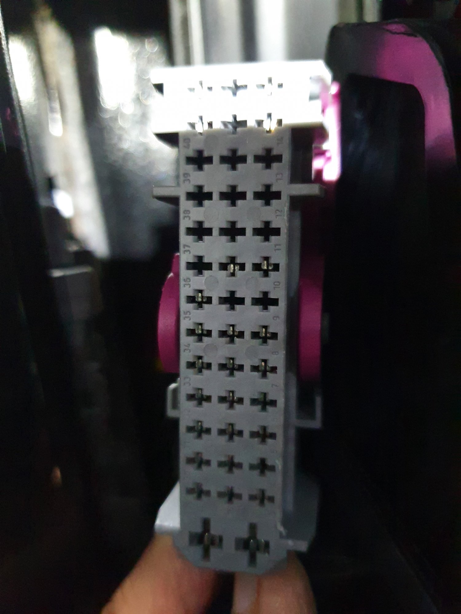

  4. Can anyone tell me what the female pins in the molex connector on the body (between the A pillar and the door) are called? I am in Australia and would like to add extra wires to operate the cargo lights in the tow mirrors I have bought, but I cannot match the female pins which go into the molex connector at the A pillar. Does anyone know their precise name and specification so that I can see if I can get them here in Australia without sending for them to the US? Truck is a 2019 Silverado 2500HD. Picture of the molex connector attached.
  5. Thanks for that. Yes, I did mean DL3 not DL8. So that would mean that the wiring will not be there for the cargo lights, which means I will have to add that wiring.
  6. If any one has a wiring diagram for this truck it would be helpful. I have checked all the wires which come to the RH door and not one of them seems to operate the cargo lights. I have turned the cargo light on and checked the voltage at each wire and none seem to correspond with the cargo light being on. Perhaps I do have to acquire the extra wires from Boost Auto in order to supply power to the LEDs in the mirrors?
