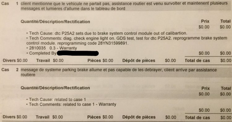

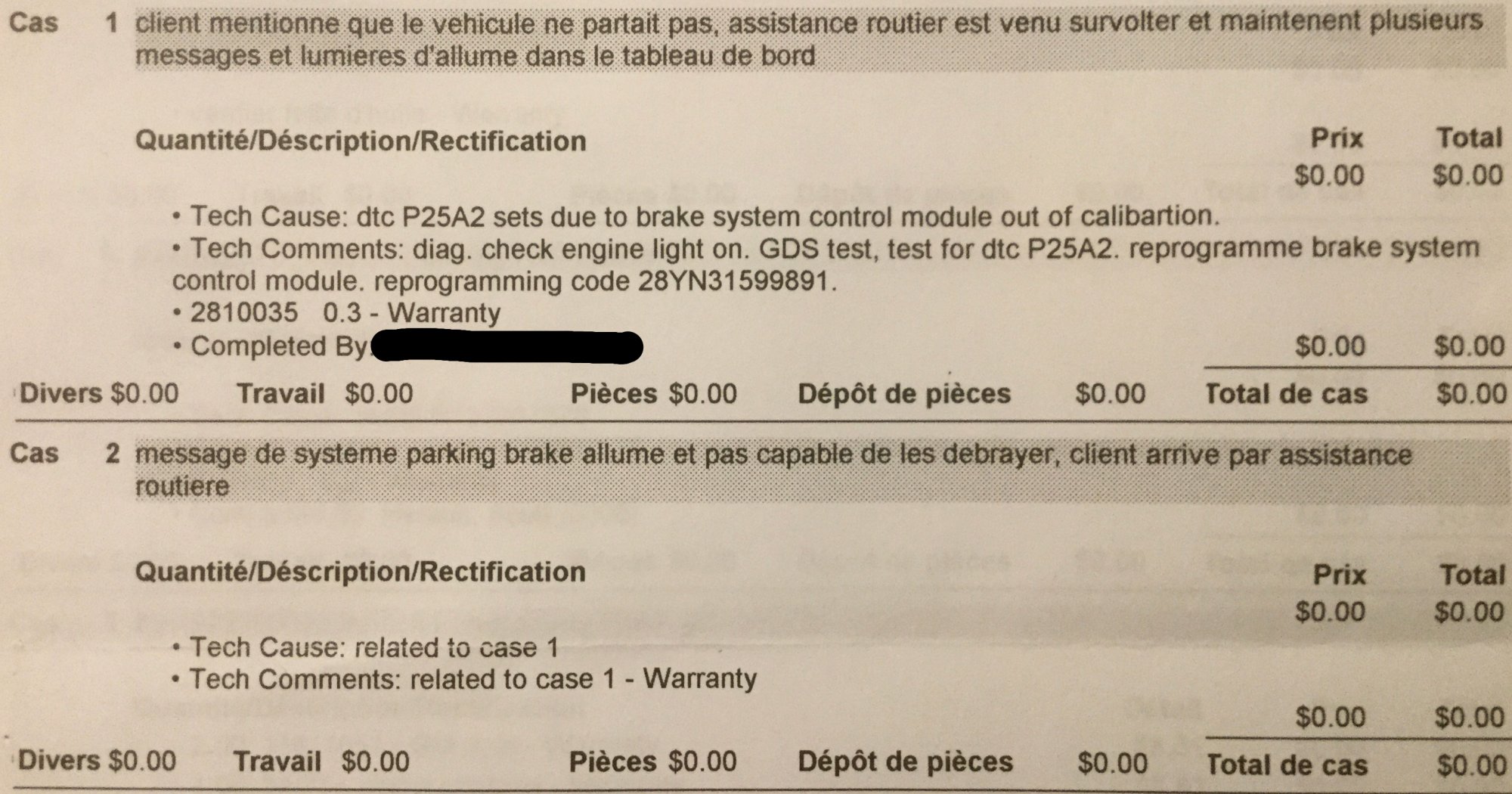

  6. The attached image is the explanation/fix my dealership did. I could understand that the truck would not start since it seems to have been related to the brake system. However a little surprised that this would cause complete electrical cutoff since I could not unlock the doors with the key FOB or even have cab light turn on when doors opened. Well hope that is it and now fixed but still concerned they fix side effects but the root cause is still undiagnosed. Time will tell.
  7. Same here, luckily I wasn’t driving when it happened. Truck is the 2019 Sierra Elevation, had it for less than 2 months. It was parked overnight and when I went out to start it this morning the truck had no power meaning the FOB would not unlock the doors, had to use the key in the FOB to unlock the doors. Once inside no lights in the cab turned on, it was like the battery was dead but noticed the needles of the gages had a slight shaking motion going on. Called roadside assistance to get a boost, when they connected the battery pack it was obvious the battery was fully charged but allowed to start the truck. This is when I noticed pretty much every dashboard light on with all the diagnostic messages scrolling through. ”Service Parking Brake” ”Traction Control Off” ”Engine Power is Reduced” ”Brake System Failure 100km/h Top Speed” ”Service ESC” ”Service Trailer Brake System” ”Steering Assist is Reduced Drive with Care” I have pictures of all of this and in addition to this the parking brake would not even disengage so couldn’t even drive to the garage. Got it towed, thankfully when the tow truck showed up 45 minutes later the truck started and parking brake released. Some of the messages also seemed to clear but got it towed on the flatbed anyways. I did notice a week earlier that I got a quick message when starting the truck saying something about a low battery. Maybe it’s related to electrical/wiring. Dealership should be looking at it on Monday.
