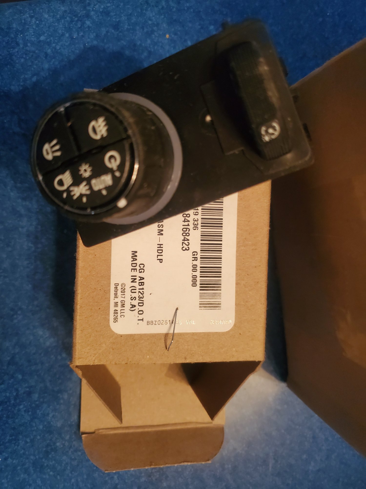

  7. I need a little help with wiring the relay boards to make sure they turn off, as they should. Right now I have a 2 channel running 2 switches. I'm going to use one board for each switch. How do you run the 2nd channel to break the latch? I have ground to com, no is output. Do I run 2nd ch differently?
  8. One of mine has an issue turning off. What was the Cng button turns on fine, but wants to stay on. The Park assist turns off fine. Using 2ch latching relay. Saw in another thread that you sometimes need a 2nd switch to make it work right.
  9. One of mine has an issue turning off. What was the Cng button turns on fine, but wants to stay on. The Park assist turns off fine. Using 2ch latching relay. Saw in another thread that you sometimes need a 2nd switch to make it work right.
  10. On this switch, is the light wire ground or hot? I have it actuating a latching relay for a rear led bar. Just want the in switch indicator to come on park sns, and cng.

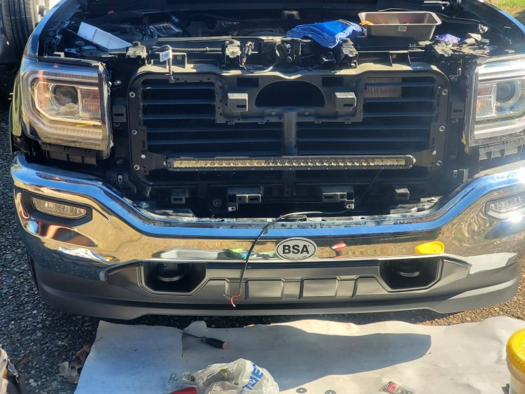

  12. https://rover.ebay.com/rover/0/0/0?mpre=https%3A%2F%2Fwww.ebay.com%2Fulk%2Fitm%2F264577801608 I believe this is the same as mine, just different brand. Not very deep, so doesn't interfere with the shutters.
  13. Rigidhorse 32" . Put 2 washers behind the brackets. Bought longer bolts to mount them to shutter shroud. The brackets ended up a little crooked, throwing off the lineup for the bar end brackets. Bent them a little with a hammer. Lined up perfectly. Didn't want to chance spacing too far out.
  14. Rough country brackets worked perfectly with a little modification.
  15. Tasca switch arrived today (finally). I have it, and a latching relay for sale

  18. Now. Waiting to try again to install the light bar, when I get the bracket kit from Rough Country. Tried on Sunday. Just didn't have what I needed to make it work.
  19. Finally got around to contacting Tasca. Switch has shipped. Looks like I'll have a spare blue one for sale, when it gets here. I'm going to recheck my terminals thanks Phlash. Guess what. My gray wire wasn't in correctly.
