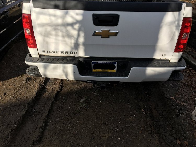

  1. figured I would do a write up on my rear bumper mod. you can swap a full rear bumper from a 14-18 on a 08-13 Silverado. but you have to swap you trailer hitch and mod/gently persuade the corner bracket to fit the bed corners on the 08-13 bed. it is pretty much a simple bolt on swap. I used a draw tite hitch part number 44703
