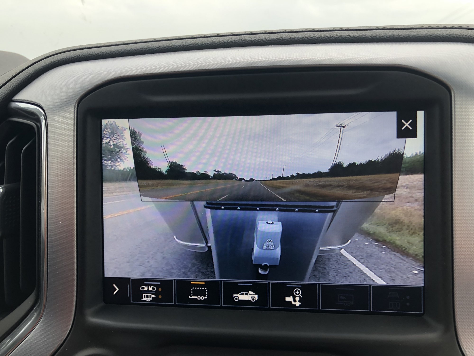

  11. Calibration is a pain. Maybe @MTU Alum can comment on this, but I'm curious where the calibration is stored. I ask this because when I do get my camera calibrated the minute the power is removed (aka turn off the vehicle), I loose calibration and the camera has to go through the calibration again. I've seen some people have this issue and others don't. Which then leads me to question is this a hardware issue with the camera (some think it may be), or is this something that can be changed in the firmware of the truck itself? It seems fairly pointless to get things calibrated, then have recalibrate over-and-over again.

  13. Interesting, @sdelam... that mirrors my experience. So I just looked at the box that came with my camera. Apparently the new part number is: 84946379 My camera part number is: 84876818 @MTU Alum: Can you tell me what has changed? Is there any updated firmware? Would the new camera behave differently?
  14. Interesting.... I know my dimensions are saved with my Airstream profile. I wonder why it wants to recalibrate all the time? It does look great though. I know I read something about it having to recalibrate... I'll need to go find those instructions now.
  15. Maybe it's just me, but doesn't it seem like if you turn off your truck for something like fuel, that the camera system shouldn't have to recalibrate. I know the instructions say it has to do that, but seems to me that it really should add a feature to that says if the vehicle is turned off, then back on within a 30 minute period that it doesn't have to go through the calibration step all over again. I'm loving the camera on my Airstream, but I find it certainly takes a bit longer than 60 feet to get it calibrated and sometimes getting it calibrated before you have to go faster than 25 MPH is impossible. Anybody else feel that they should have some storage of these values? At a minimum I would think the way to do it is try the previous values and see if the previous values are still valid. -Wayne
