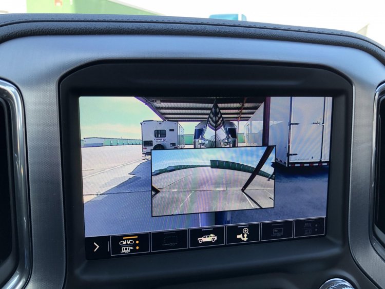

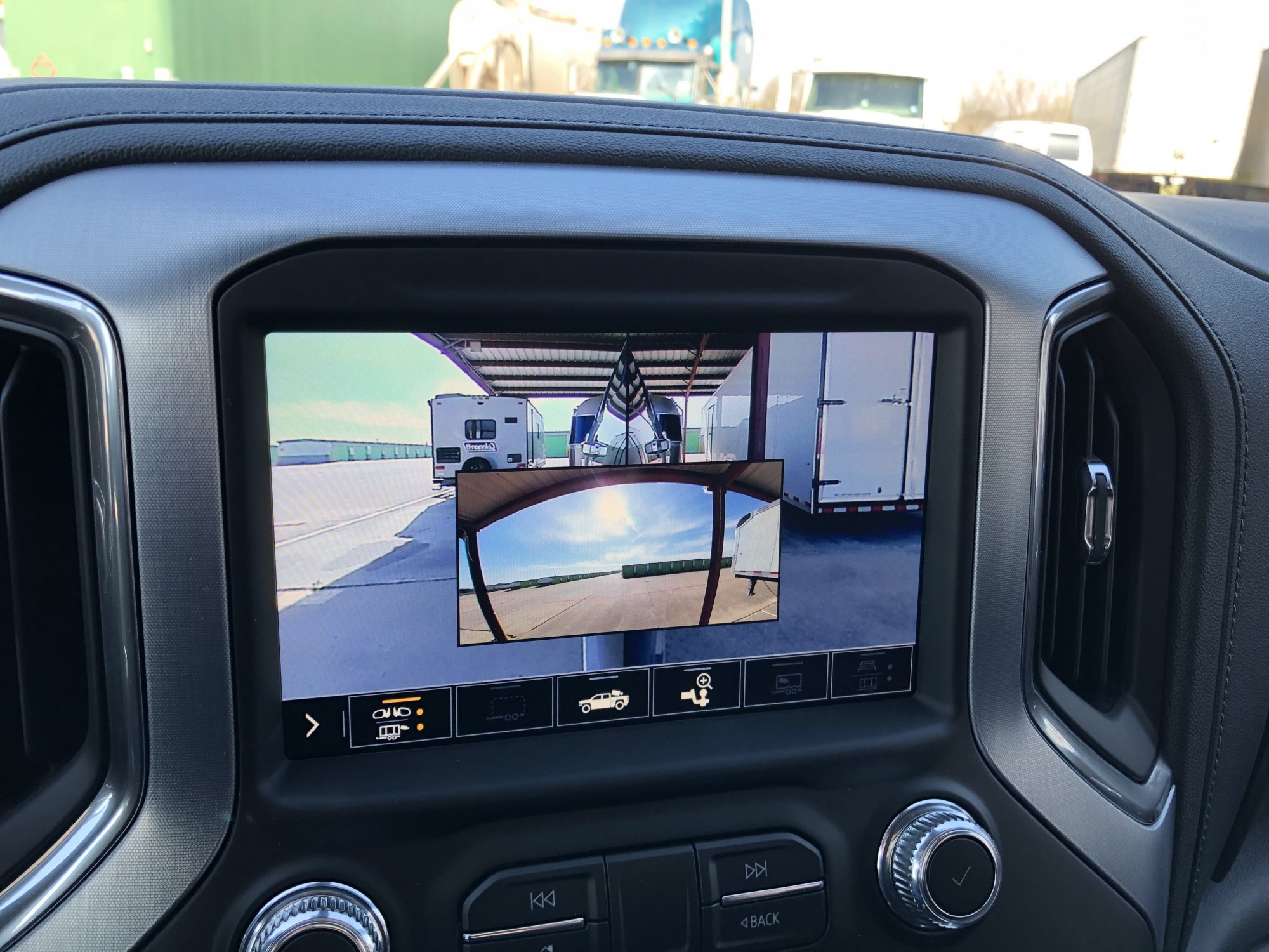

Maybe it's just me, but doesn't it seem like if you turn off your truck for something like fuel, that the camera system shouldn't have to recalibrate. I know the instructions say it has to do that, but seems to me that it really should add a feature to that says if the vehicle is turned off, then back on within a 30 minute period that it doesn't have to go through the calibration step all over again. I'm loving the camera on my Airstream, but I find it certainly takes a bit longer than 60 feet to get it calibrated and sometimes getting it calibrated before you have to go faster than 25 MPH is impossible. Anybody else feel that they should have some storage of these values? At a minimum I would think the way to do it is try the previous values and see if the previous values are still valid. -Wayne

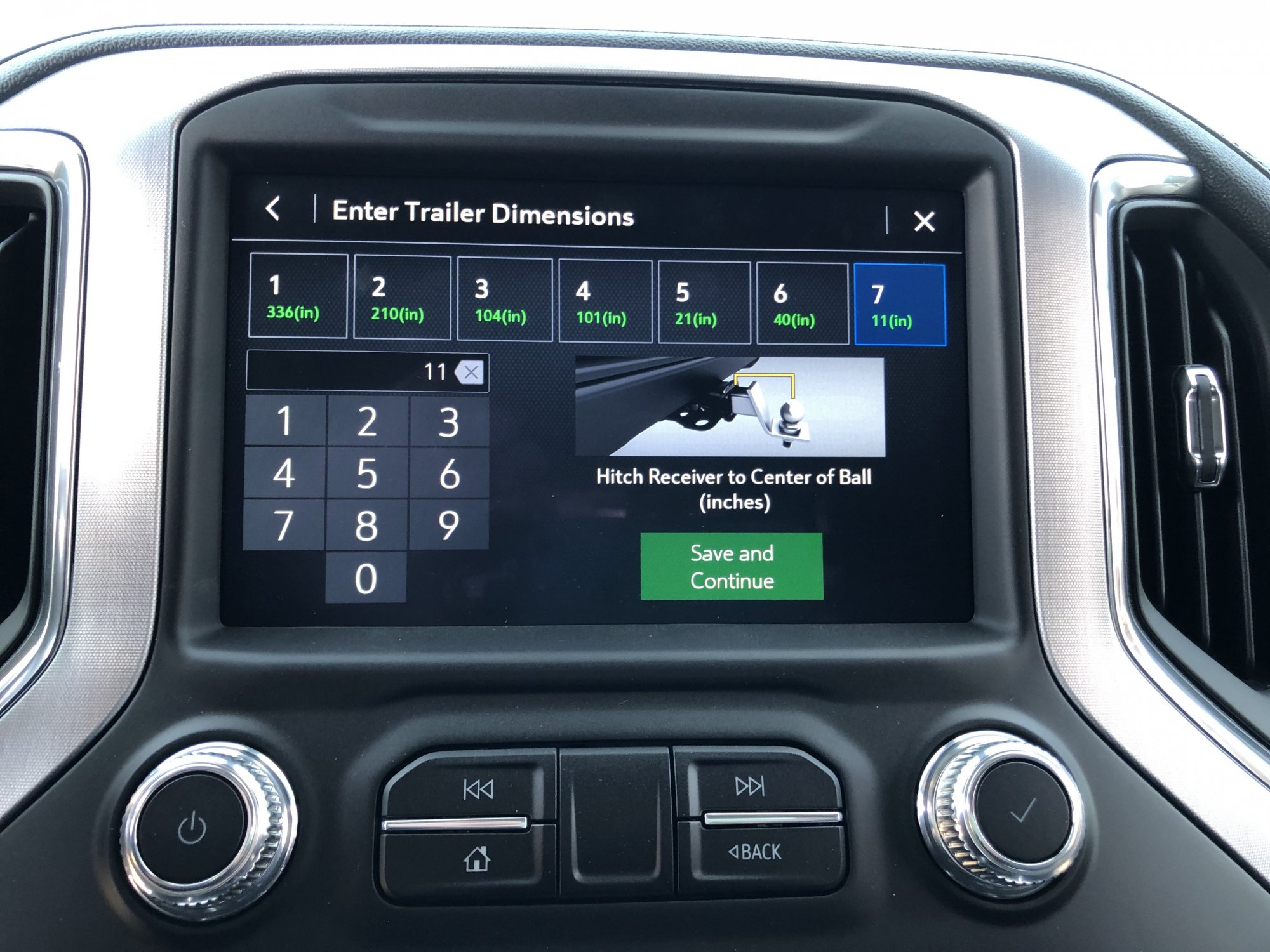

I've yet to find the 'secret sauce' for getting the invisible camera to work with my 28ft Airstream. It will show it's 'calibrating', but never do so. To be honest, I'm not sure exactly what numbers I need to fiddle with. If anybody has had luck getting the invisible trailer to work, I'd like to know what numbers you have so I can compare them to what I have and have a play with all settings again.

First off, thanks to MTU Alum, I was able to get the unit to try to calibrate for the invisible trailer mode. However, it never did successfully calibrate. I tried playing some with the settings, but no matter what I put in, it wouldn't calibrate. That said, I'm still quite pleased with it. It means I can ignore the less than ideal camera that came preinstalled on the Airstream. I stole Larry's idea and bought some of that non-conductive conduit and snaked the cable through since I ran it under the trailer. Unlike his clean line, there were a few more obstacles I had to get around on the bottom of the Airstream so my install looks more like a snake than a straight line. ? The only downside is while doing some test positions on the trailer, I used carpet tape and the camera fell off the back and wouldn't you know, landed straight on the lens, so now I have a small ding in the lens. It ends up looking like a spec of dirt in the picture, and I'm annoyed with myself, but what do you do? I will say that I'm right at the bottom range of the 200mm window they want due to where Airstream puts their badging. -

So today, I had a chance to test the camera on the Airstream. I'm getting ready to fly out later today to the UK for a week, so I tested it and my wife wanted me to do more checking before 'rushing it'. ? Anyhow, I did run into a few issues trying to make it 'invisible'. My Airstream is 28 feet long, which seems well within the 10 meters mentioned earlier in the thread. When I entered all the data required it told me my parameters were outside the limits and thus couldn't do the invisible trailering. I've put photos in here of all the measurements. With the Airstream not being square, some of my measurements could have been off slightly, but not by much. Anybody know what the actual parameter ranges are for each of these measurements? I'm not unhappy just leaving it 'as-is' ... I tried both where the existing camera is on the top (not a fan), or the middle area of the Airstream, which I did like. -

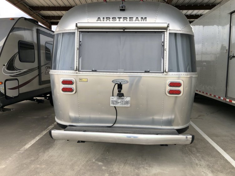

So, I'm curious. With it mounted there you obviously don't get the 'invisible' trailer, so with it activated, what do you see? I'm kind of curious. I have the option of removing the bluetooth camera that's mounted on the top of the trailer, but figured I would go with the 'invisible' option. However that requires putting some additional holes in the Airstream, and I'm never crazy about doing that. -

I know! It's amazing how little info there is about these cameras. GM is advertising the feature like crazy on TV, but nowhere does anybody really talk about the setup and install. I plan on installing at the height just slightly above where the truck camera is (as suggested in the documentation), and to keep things cleaner, I do plan on running things under the trailer. I know that's not recommended, but especially on the Airstream you want to keep things 'clean'. I'm out of town next weekend and the following week on business, I'm going to try to see about getting it sorted by then, but we'll just have to see. The weather here isn't looking great all week, so I may have to hold off until I get home. But to do plan on documenting this as much as possible. -
