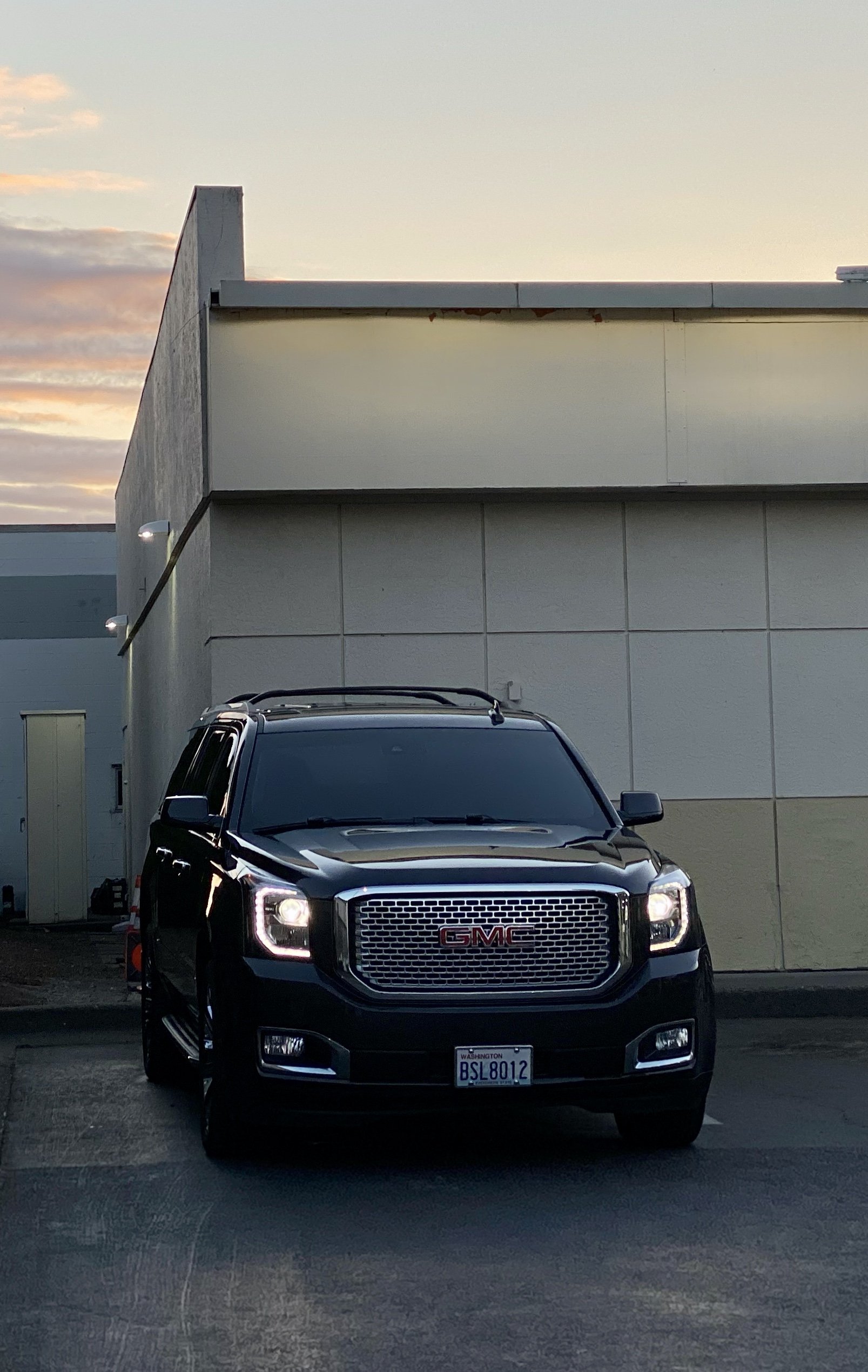

  3. All done with installing the new 2019/2020 Sierra GMC backlit emblem on my 2016 Yukon. I am very pleased with how it turned out. Here is what I did in no particular order. No laughing allowed. 1-------Remove old emblem. 2-------OEM (above) vs Backlit (below) 3-------Grind protruding retainers from Grille. (retainers seen in image 1---) 4-------Use OEM backplate as a template to address inconsistencies with the new emblem/harness attachment points and mounting studs. Worked out great for maintaining a level and centered mount! 5-------Hole cut in backplate for 12v power supply. 6-------marked and cut hole in grille. Also drilled hole for studs (drilled hole seen in image---3) 7-------Grind off seven clips. 8-------Slight harness splicing to correct lighting performance. (turn signal troubleshoot). Used a Fluke Meter to associate 12v supply with feed manipulation. 9-------Drilled and placed backup custom pins.
  4. Here it is at night. Everything is looking good. Just need to figure out mounting and harness reroute.
