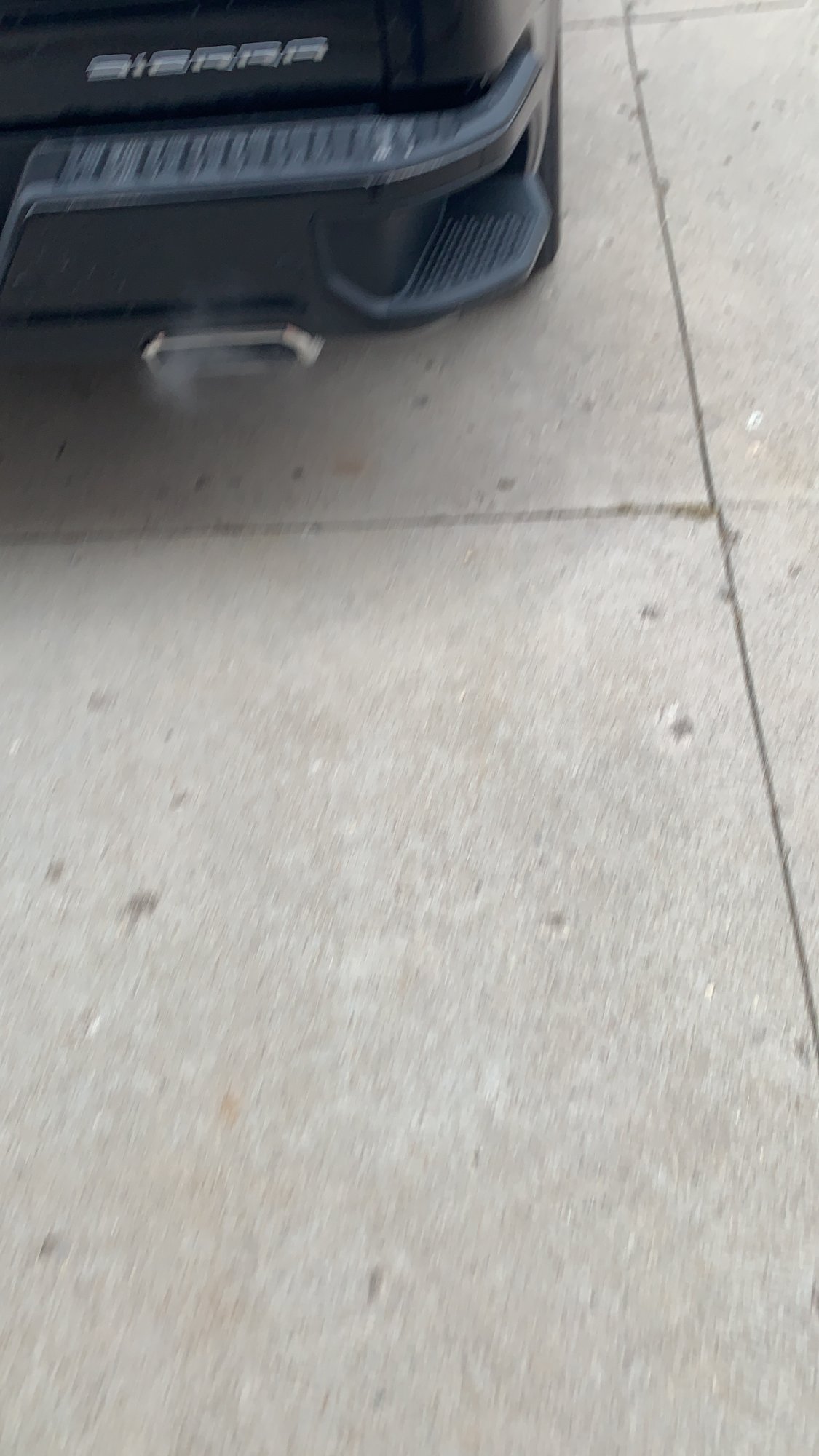

  2. I have a 2020 GMC Sierra with a 6.2L. It has a total of 5900 km or 3670 miles. About 950 miles ago noticed that the idle was getting rough and when I would use the remote start in the morning after it sat overnight it puffed blue smoke out of the exhaust. It disappeared after about 10 seconds. Turns out that at lease 1 valve guide was not sealing properly. The dealer is changing all the seals on both heads and I am going to ask that the spark plug(s) also be changed since I believe they are dirty from the burning oil. Has anyone experienced this?

  5. I have a 2020 GMC Sierra with the 6.2L and its also been idling rough. I notice it after the dreaded auto stop feature starts the engine. Not sure what is the issue but I can tell its rough. I have about 5.900 km on the truck and it started to run rough at idle about 1500km's ago. At that time I also noticed that when starting it up after it has been sitting overnight I get a puff of blue smoke when I remote start it. I figured it was the valve guides but hoped it wasn't the piston rings as a worst case scenario. When I took it into the dealer they diagnosed it was bad valve guides. I am waiting for the new guides to be shipped in from the US which could take a month because of the pandemic. Having said that, the problem could be fouled spark plug because of the oil burning off after I do a cold start. Use the remote start and stand behind the truck when it starts up and see if you get the blue smoke when you do a cold start in the morning. The dealer without hesitation said they would replace all the guides on both heads just to be safe. If you are having a similar problem and the dealer tells you its your valve guides make sure you get all of the guides changed not just the one or two that are leaking. I am also going to have the spark plug changes in the cylinder that is the issue. Good luck ST
