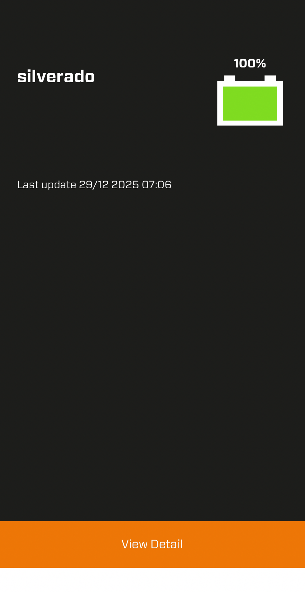

  1. battery is about a year old agm i have a battery shunt says its 100% charged. there is a possibility its it the ignition. how often does the ignition go out on these trucks?

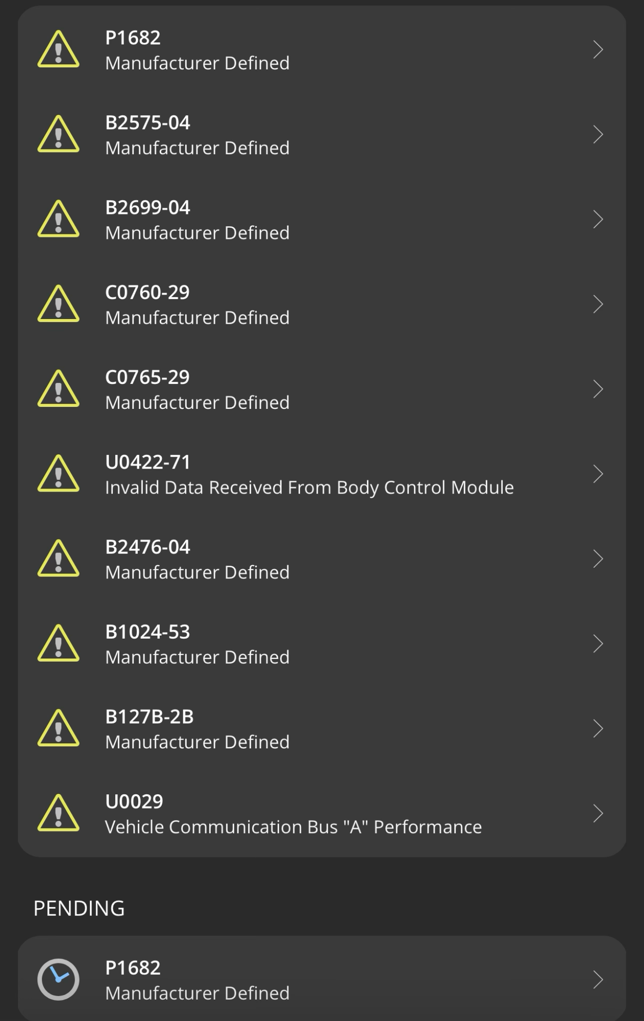

  4. Hi just got my truck back from shop for new transmission and now the truck some times wont start seems like bad fuel pump. i have lots of codes my guess is bad ground im here to get another opinion. what should i do? shop doesnt open till tuesday. thank you P1682 ignition 1 circuit 2 fault U0422-71 invalid data from bcm U0029 poor can bus performance B1024-53 driver airbag short to ground b2575-04 left headlight open b2699-04 right headlight open both headlights are working fine i do have aftermarket hids with capacitors C0765-29 C0760-29 both are tpms yes there dead B127B-2B reverse camera signal missing stinger aftermarket radio should still have signal?

  12. hi i have code u0029 poor bus a connection. for chevy truck most say its there radio issue but issue i am having is crank no start. i have spark but have not tested fuel yet. i cant hear fuel pump turn on. anyone have any other thoughts then checking fuel?
