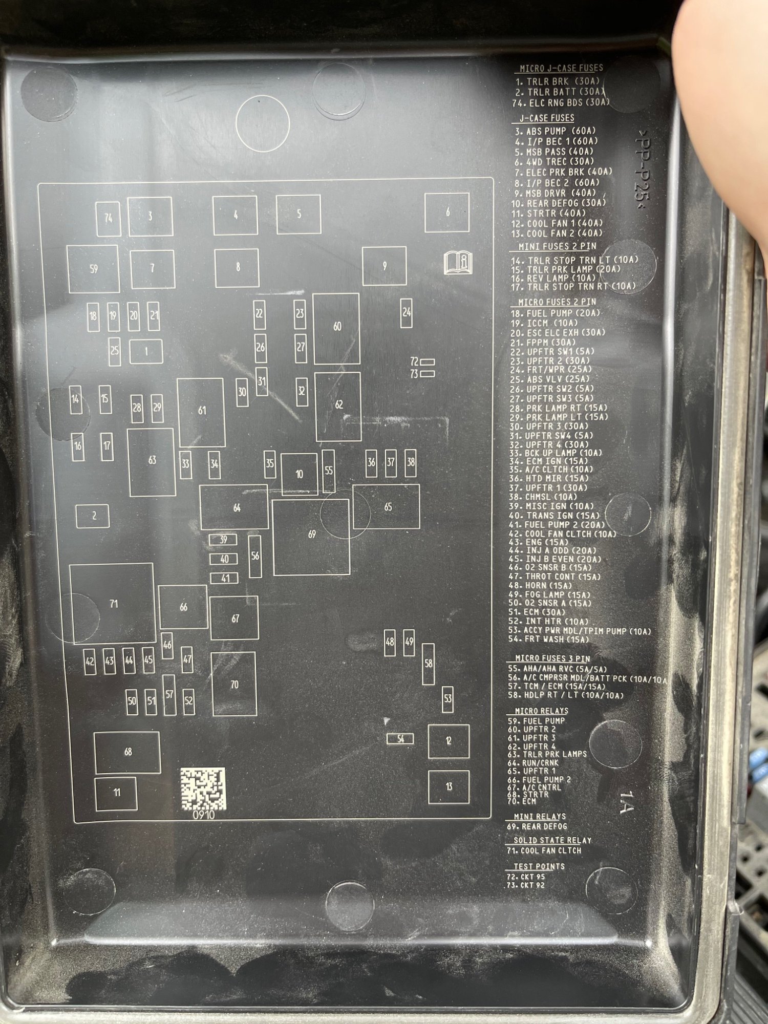

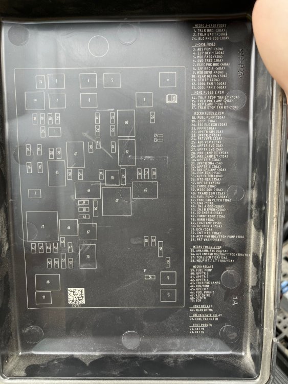

  22. You big dummy! found the blown fuse on the relay harness. What you get when you try doing something without giving it your full attention. And easily wanted to blame the truck when I couldn’t find the right fuse that was labeled wrong. Or am I still only seeing what I want to see on the truck.
  23. Getting somewhere has nothing to do with the trucks oem wiring I just didn’t notice there are two fuses and borrowing someone else multimeter to figure this out. first photo is list of under good fuses second is fuses I found. Third is some where my issue is seems like the relay putting together some jumper wires to test. currently having issues uploading the photos so working on that as well found out that highs went from 0 to 14.8 volts then lows where 8 to 14.6
