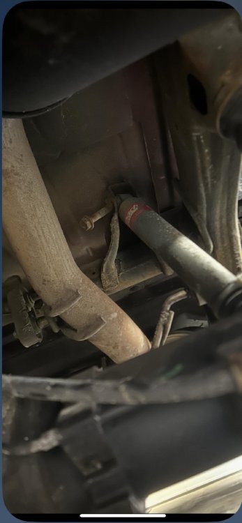

  1. That nuts. I thought about that but didn't have any when I did it. This time I over torqued it a little. I will pick up some Loctite and keep an eye on it.
  2. The bolt was pretty well lodge in there thank goodness.
  3. So, I serviced my rear differential Friday. That all went well. While lying under the truck taking the cover off, I happened to notice that my right rear shock upper bolt had backed all the way out and was just hanging on at an angle. Surprised I didn't lose it. Most of my driving is pavement so that probably helps. Guess I didn't torque it right back when I did my shocks in November 2023. I was able to jack it up and reinstalled the bolt.

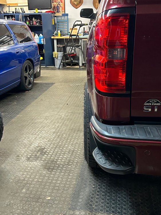

  13. Ok, yea if you want to keep those wheels you will need a spacer. Like I said I have Rough Country uppers arms and they require .25. When I did my lift, I did wonder had I used a different control arm would it still rub, and you pretty much answered that for me. I opted for new wheels with a different offset. I consulted with the main financial advisor in the house and she didn't give me a NO so new wheels it was.
  14. What size is your stock wheel you are running? I have rough country control arms and I rubbed with the 18'' wheels. Rough country states that you will need a .25'' spacer to avoid that or else get new wheels with a different offset.
  15. The tire tread lines pretty mu up with the fender and the sidewall is what is just outside the fender.
