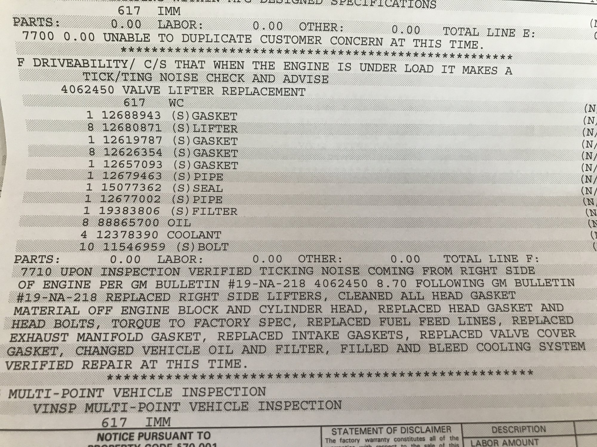

  1. I had a lifter failure at only 7500 miles. 2019 AT4 with 6.2. Likely happened earlier but I hadn’t got around to making appointment at dealer. I think it’s being caused by the DFM system which you currently can’t disable if you have a 10-speed.

  9. Most certainly a lifter issue. I just had my truck fixed today. 2019 GMC AT4 6.2 with 10-speed (DFM). 7500 miles. Only 6 months old. Do not listen to any dealer telling you that this is normal for these new engines. There is a TSB for this. Very disappointing after trading in a fault free 5 yr old RAM 1500 for this great truck.
  10. https://static.nhtsa.gov/odi/tsbs/2020/MC-10173397-9999.pdf
  11. Finally picked up my truck from the dealer today. They told me that one of the Lifter springs had failed and per a GMC recommendation, they replace all the lifters on that side of the engine. Be warned and keep a watchful eye on similar newer engines with the DFM. Was not expecting this problem to occur on the newer trucks. Very disappointing. My truck has 7500 miles but for sure it was happening some months ago. I just decided, with all this COVID-19 stuff, to hang on until my first oil change and get it looked at then. I am gentle with my vehicles and take great care of them.
  12. Ugh. Wish I'd seen this thread before I purchased a brand new 2019 GMC AT4 with the 6.2 and 10-speed just 6 months ago. Heard a ticking noise some time ago but with COVID-19 impacting many businesses, I figured I would wait until the first service. My 7500 mile truck has been sitting at the dealer for almost a week. They told me today it has a failed lifter spring. WTF. This truck is brand new. I will know more when I get it back and check out the work they did. 5 years with a RAM and never had one single issue. I love this AT4 but will have to make sure I get rid of this before the powertrain warranty expires. Sucks.
