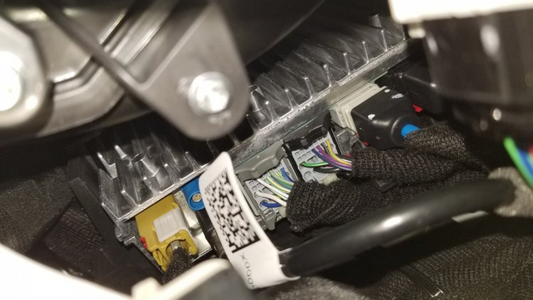

  1. Is this the audio module? Do I have the black and gray connector?

  3. Dude that is incredibly helpful. Thank you. So all that is left is for me to decide where to mount my LC2i. If I mount it next to the amp, I'll get a 10ft harness and short RCAs and I should be good to go.
  4. I'm going to be installing this SubThump box and amp combo, and I would like to purchase a harness from LLJ Customs. http://subthump.com/Chevrolet-GMC-Custom-Subwoofer-Boxes/Silverado-And-Sierra-Crew-Cab-Custom-Subwoofer-Enclosures-by-Subthump/2019Up-Crew-Cab/New-2019-New-Body-GM-Crew-Cab-Dual-1012-Downfire-With-Amp-Space-clone.html I've reached out to LLJ customs twice and they haven't gotten back to me. Can you guys help me with choosing the correct options for the harness? It's for a 2020 Silverado LT, 8" without Bose. Here's the link to the harness. https://lljcustoms.com/store/ols/products/2014-2018-gm-t-harness-for-8-screens-without-bose-1418gm8 First option: Line Output Converter I already know I want the LC2i with the bass knob Second Option: Vehicle Connector Color I don't know which connector they're talking about and how to find the color Third Option: Harness Length I don't know where this harness plugs in, so I don't know how long I need the harness to be to get to under the rear seat Fourth Option: RCA Cables I have no idea if I need these Fifth Option: Extended Amp Turn On Wire Again..no idea where this is plugging into in the car or if I need it extended And finally, should I just skip the harness? What's it actually doing? Can I just do the wiring myself if I'm comfortable with soldering
