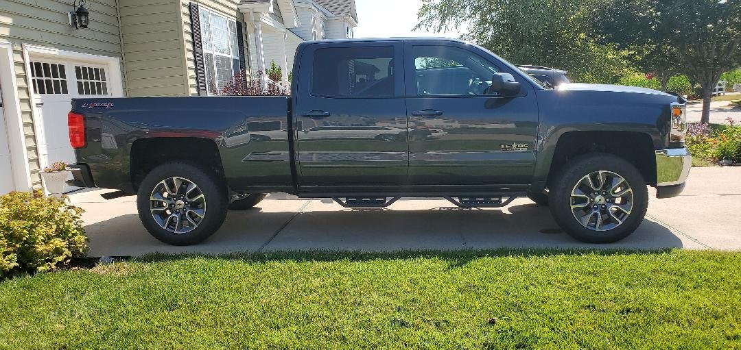

I have a 2017 1500 Silverado LT, 3-inch MotoFab leveling kit, wheels are Chevy stock CV32, 20x9, 28mm offset, 6.1 inch backspacing, have installed a 1/4 inch wheel spacer. The 1/4 inch (6.35mm) spacer was installed to stop rubbing of the stock Stamped UCA. Tires are 275/60/20. I'm what to install a new UCA that corrects the UCA ball joint angle. Problem is, ll the UCAs I've looked at require 4.5 inch backspace or less.
Need to find a solution. i.e. new UCA and Spacer; 3" spinal, UCA adn spacer; lower to 2" and keep stock UCA. Any help that y'all can provided would be appreciated.
