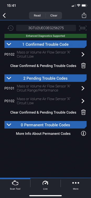

  1. FIXED! i installed the MAF sensor upside down. gonna disconnected the battery for 30mins and hopefully it will delete the permanent code P0102
  2. Bought some MAF sensor cleaner and gave it a pretty good spray however still showing the codes. Ugh!
  3. Just hoping I didn’t pull on a wire to hard on the connection or something. Hope it’s just got a little dirty or worse I broke one of the fine wires inside the MAF
  4. Brand new filter however I didn’t oil it yet. I’ll try some cleaner first
  5. I take it that the cost of a new MAF?
  6. So I just installed a K/N cold air intake and now I am getting codes P0101 and P0102. Could it be just a bad MAF sensor or possibly damaged from me handling it incorrectly? Would a new MAF sensor work? 2014 GMC Sierra 5.3 liter 145,000 kms
