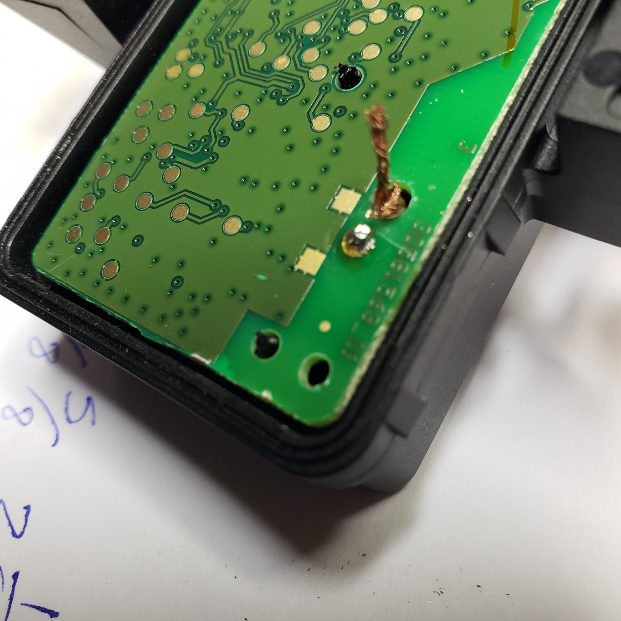

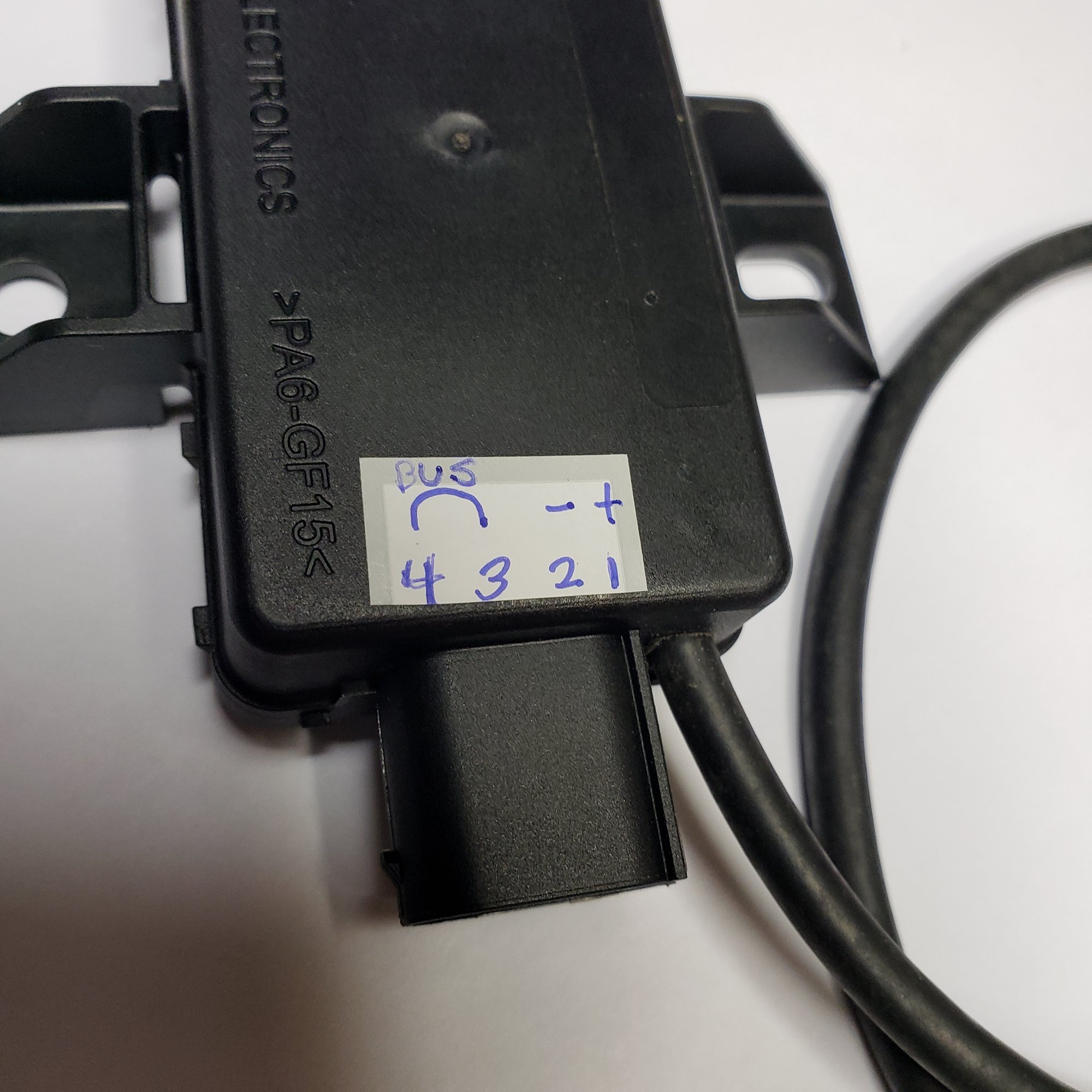

  3. Yes, they are stamped 433.920 and so is the ECU on the truck. If you are thinking booster or repeater so did I. I have the system that I installed on my 2019 truck that did not have the TPMS from the factory. It came with a repeater and I installed it underneath the front of the RV which is where I had previously installed it last year for our trip out West. It did not improve the reception. I spoke with the tech support at TST Truck the manufacturer of that system and he said that their protocol was different from the GM protocol. He said think of it like a wifi password. By the way the ECU and the sensors are stamped Schrader which I learned has been sold to Sensata. I spoke to the Schrader/Sensata tech support rep about these problems and he was in contact via email to the folks in the UK and they were eager to work with GM to resolve the issues so hopefully they will eventually resolve them.
  4. The antenna on the approximately 4 feet of RG-58 is just a 1/4 wave dipole antenna which is formed by pulling the center coax lead through the braid. Remove 6 1/2" of the jacket and pull the center insulated coax through and form the center and the shield into a "T" shape. I mounted it on a thin plastic sheet and attached the coax with nylon ties. I fabricated some hanger brackets and hung it about an inch below the receiver hitch. This way you have effectively just moved the antenna from it's original hidden location behind the license plate to a location below the RF shielding of metal at the rear of the truck.
