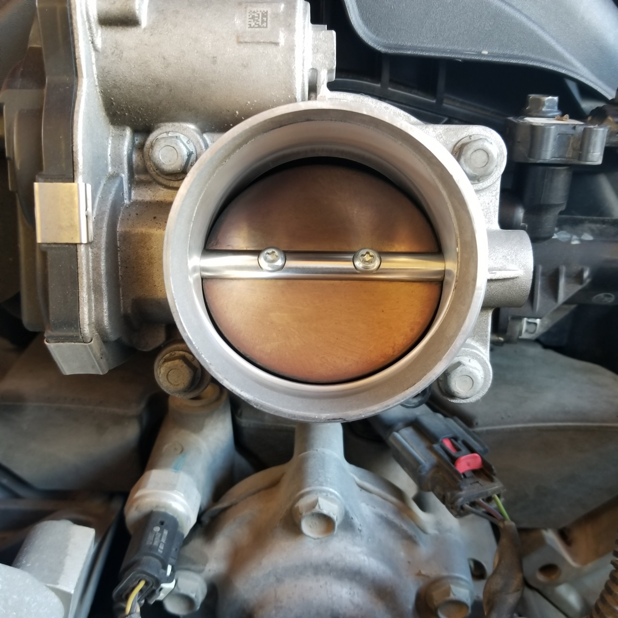

  3. Update i had New throttle body replaced truck performance better overall rpm now goes to 3500
  4. TB make click sound when pressing pedal down open a little key on engine off is that normal or it supposed to open all the way when pedal is down?
  5. That video ive sent is when key is on and pedal down the plate barley moved as you can see on the vid.

  7. Actually no lol i just went out now and turn ignition to on position and my friend checked and told me the plate barely moved a bit not opening all the way
  8. Hello CamGTP i took the intake off and friend of mine press the gas pedal engine is off throttle plate didn't open at all ??

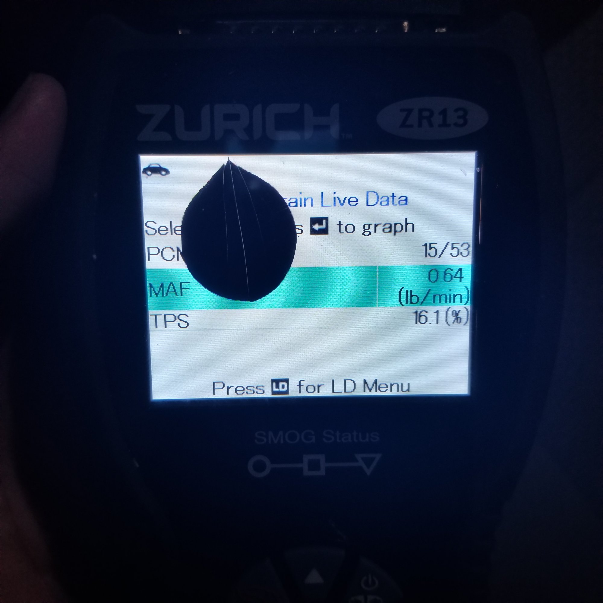

  19. 33% is when im in park and floor the gas pedal the engine is revving to 4000 rpm but reading goes from 16% to 33%
  20. I have a throttle position sensor that's reading 16.1% at idle and 32.9% wide open throttle i was thinking that should be more than that !!

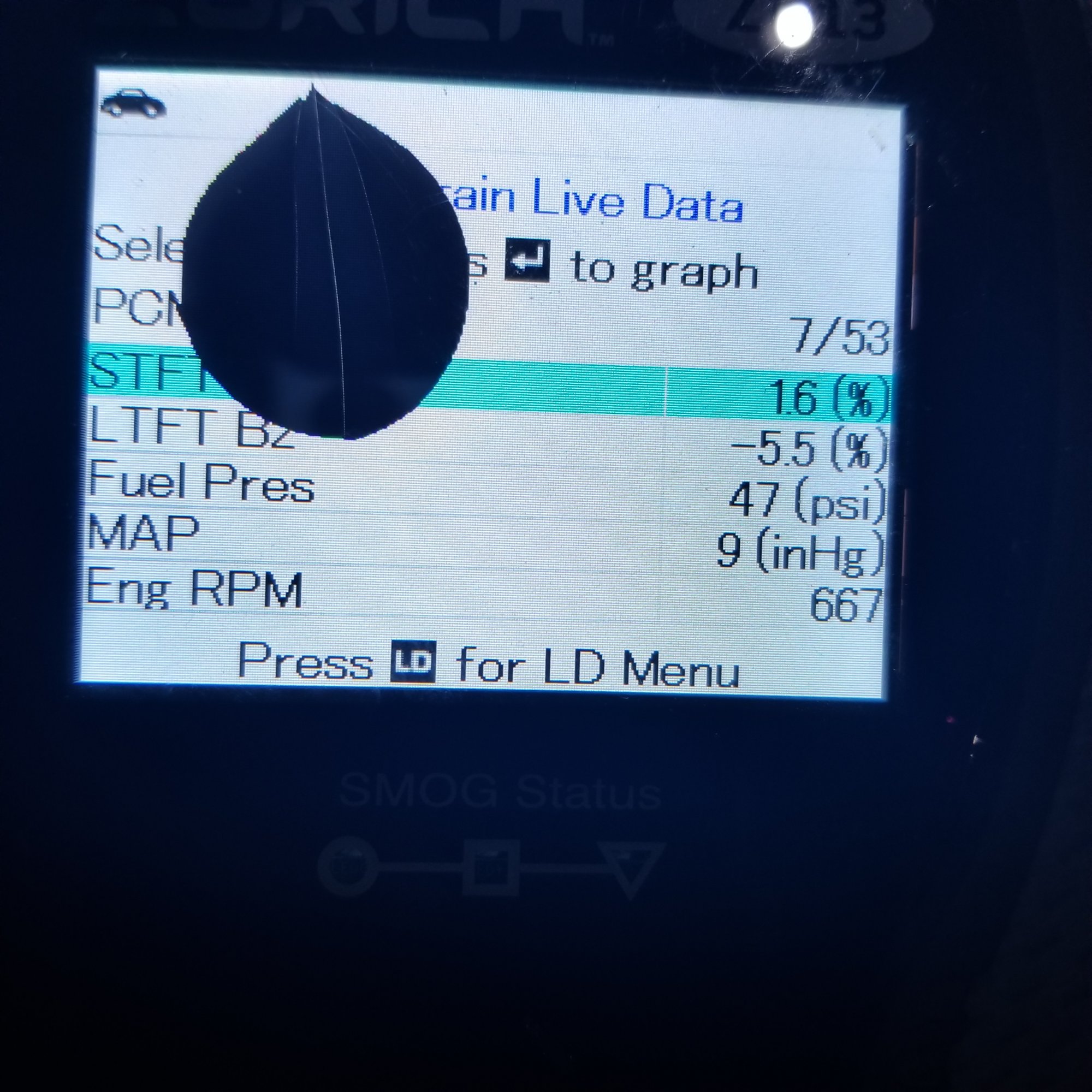

  21. Here is a different reading of the scanner sorry i did drop it last day but may able to still read some infos fuel pressure drops dramatically i don't have the knowledge to say if that's normal those are live data reading the truck is warmed up
  22. Hello thanks again i just warm up the truck and im trying to see how i can get to the map sensor log i did rev in park and it reaches 4000 rpm when i floor it up !
