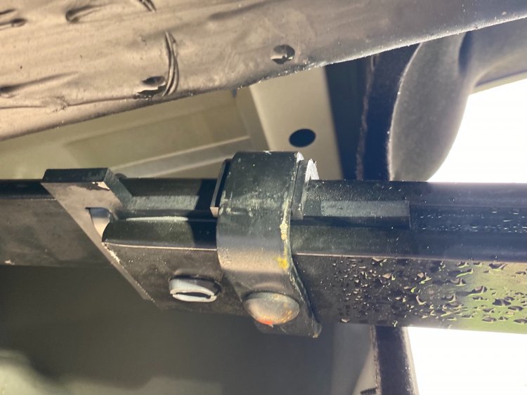

  8. Did you Jack up truck where tires were off the ground to install them and couldn’t fit them in over the grey plastic ones?
  9. Look at my pic of my install . Leave the grey plastic piece there. Install on top of it.
  10. Glad to hear.. it’s unfortunate that GMC doesn’t do this for us that buy their trucks.
