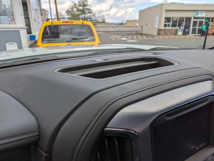

  4. I'm in the process of putting a stereo system in my non-Bose Sierra, and am having to run new speaker wires to the dash speakers (to avoid messing with the factory harness). I'd rather not have to completely disassemble the dashboard to get new speaker wires over to the driver side, so I am wondering if the dashboard cubby above the stereo can be removed by simply pulling it upwards. I don't know if it is just clipped in, or if there are bolts on the underside. I'm hoping that removing this would give me just enough access to run these new wires (or else I'll be cutting potentially 4+ wires trying to figure out which go to the dash versus which go to the front doors, since GM's infinite wisdom decided to power each side's dash/door combo on the same pin, with the same color wiring). The attached pic shows what I'm trying to remove. Thanks in advance for any insight!
