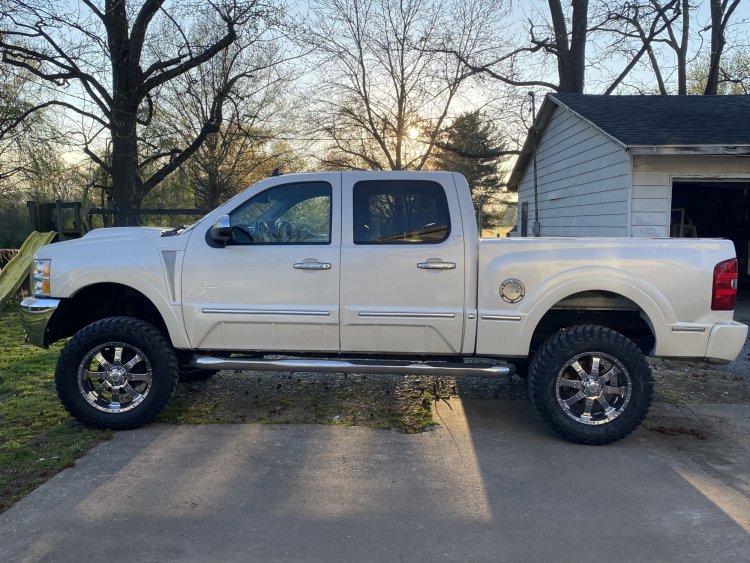

  4. Swathdiver it is a 2012 Chevy Silverado 1500 crew cab with 6.2 L with 3.73 gears with a 6 in lift 325/60R20 BFG MT
