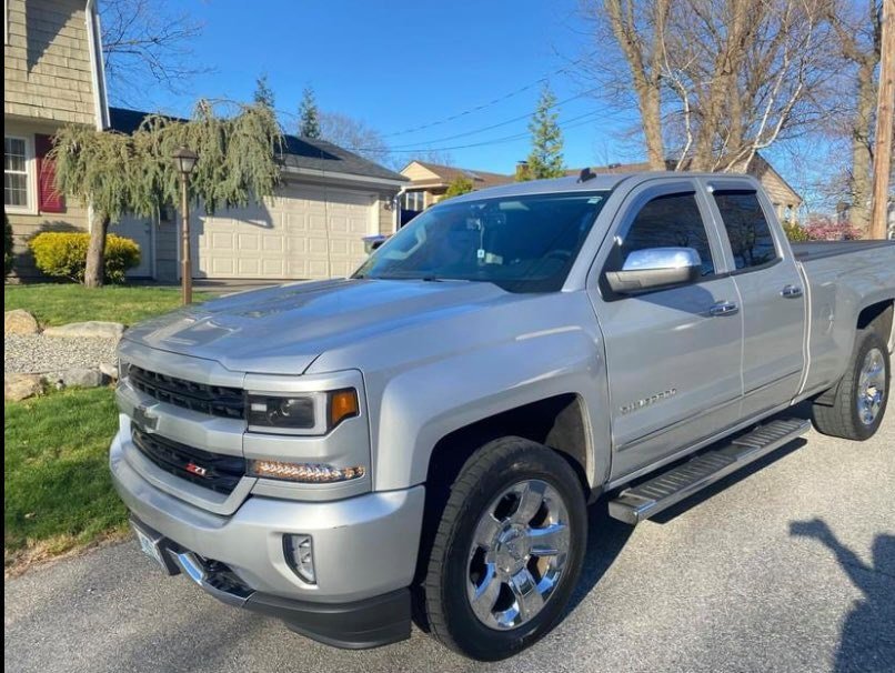

  7. My recently purchased 2014 Silverado 1500 LT with the LTZ package and 2016 front clip/lights.

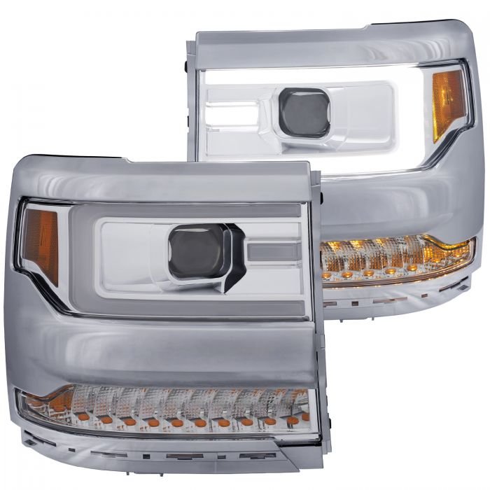

  8. Hi everyone, Admins: Please move if not in the right forum. This is in regards to a headlight modification, but I need some troubleshooting on some issues. Thanks! Name is Tony, I live in MA. I just purchased a 2014 Chevy Silverado 1500 LT with the LTZ package (tech package etc.) The previous owner upgraded the headlights and installed 2016 single beam HID lights and I realized that the lights only work in High Beam mode. I get the hyper flash on the blinkers as well, and the fog lights don't work because the low beams don't work at all. I did contact the seller and ask about the lights, but he really didn't have a clue. I am very much mechanically inclined, and have been searching for the 2014 - 2016 headlight wiring harness diagram without much success so that I can get these things wired correctly before I go and get it inspected. This truck is my upgrade from a 2001 Chevy Tahoe that I will continue to keep on the road. That 5.3L wont quit, even at almost 240K miles. I attached a couple of photos that I believe are the lights that were installed and an actual photo of the headlights. I just want the lights to work as they should. I did come across a site that sells harnesses for these types of upgrades, but they are a bit pricey, and after shelling out a good amount for this truck, I'm trying to keep as much money in my pocket as I can at the moment. Thanks in advanced for the help!
