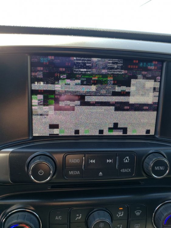

  9. Howdy all. I have a 2014 Silverado 1500 with the bigger Chevy My Link display. I have had this truck for almost 2 years now and never had an issue with anything electronic wise in that time. 4-6 weeks ago I remote started my truck, got in, turned the key and the radio display was black. I could still press where preset channels were and it would change the station, but the screen was completely black. I got home and disconnected the battery cable for 15 minutes and reconnected it and all was fine. Fast forward to today. I started my truck (with key, not remote) and same issue. I shut the truck off and opened the door, shut the door, started the truck, same thing. Did this 4 or 5 times and then got what you see below. Again, got home, disconnected battery cable for 10-15 minutes, problem fixed. Backup camera also works just fine when this issue happens. I did install a Range AFM delete probably 2 months or more ago but the problem didn't present itself until a month after that was installed and now again today. Not sure if they are related? Ideas on what could be the issue? Is it nothing to worry about it and I just fix it as it happens? (battery cable disconnect fix)
